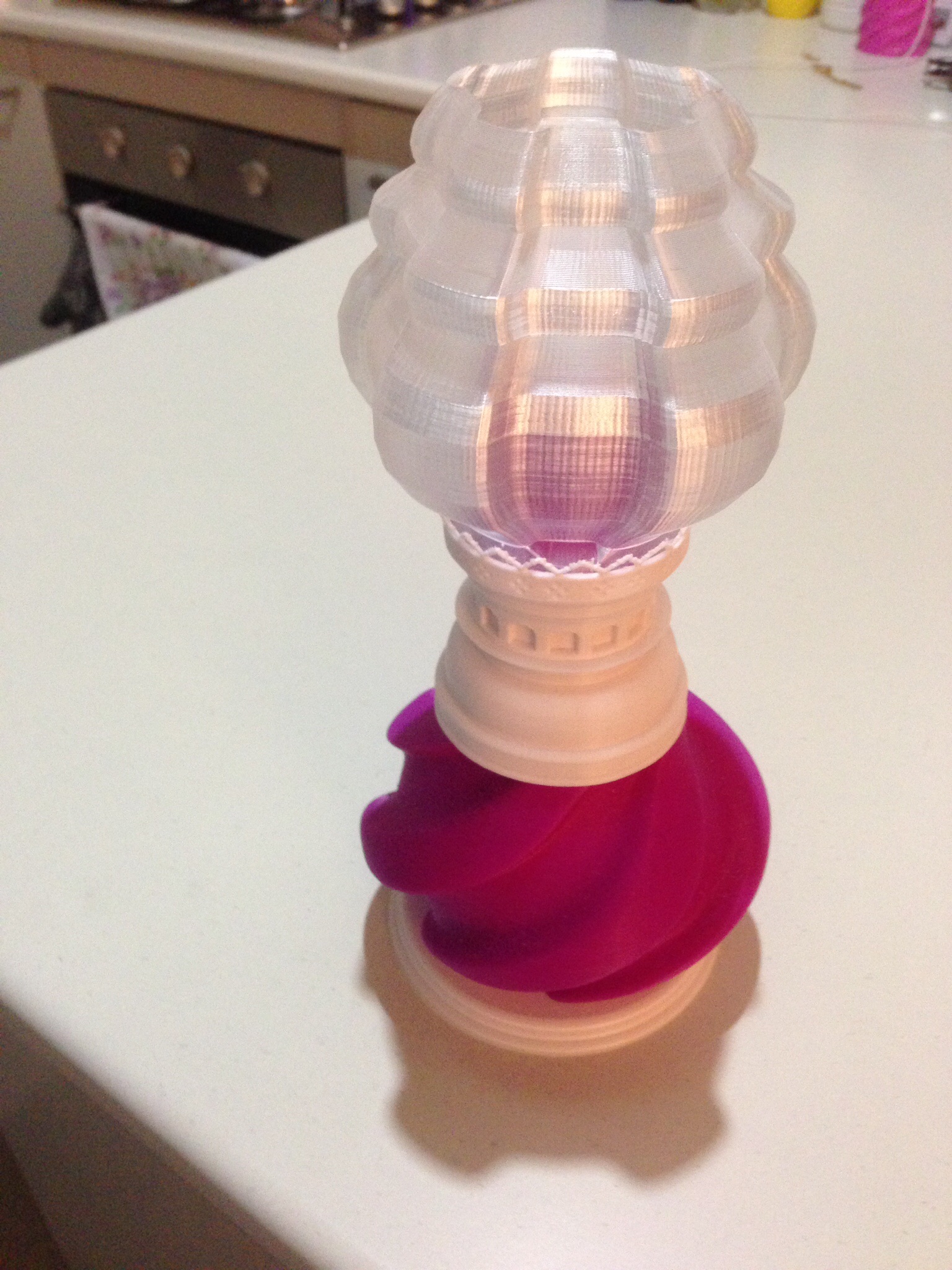

this is the current output from the bandit!
Victorian Lamp
Victorian Lamp
It is a rather nice lamp with battery tea light...

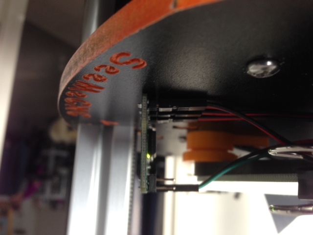

FSR's for Calibration, the way to go!
Buy the FSR kit from Ultibots they make the implementation of these things a breeze.
I used my own mount and piston design, you can copy mine if you like or go ahead and design your own. Wire the FSR's to the board using the provided harness wiring. I used the thin pads and I stuck them onto the centre of each FSR. Make sure that the pistons are a sliding fit in the FSR mounts but have no sideways movement. The FSR consist of three mounts so the other three holes will have to be bolted to the plate only and not to the top of the Rostock.

The wiring from the board pins marked +/-, -/+, S goes to the Rambo board Z-min endstop position +, -, S. No wires are changed, just use it as is. The important wire is the one that goes to S pin.

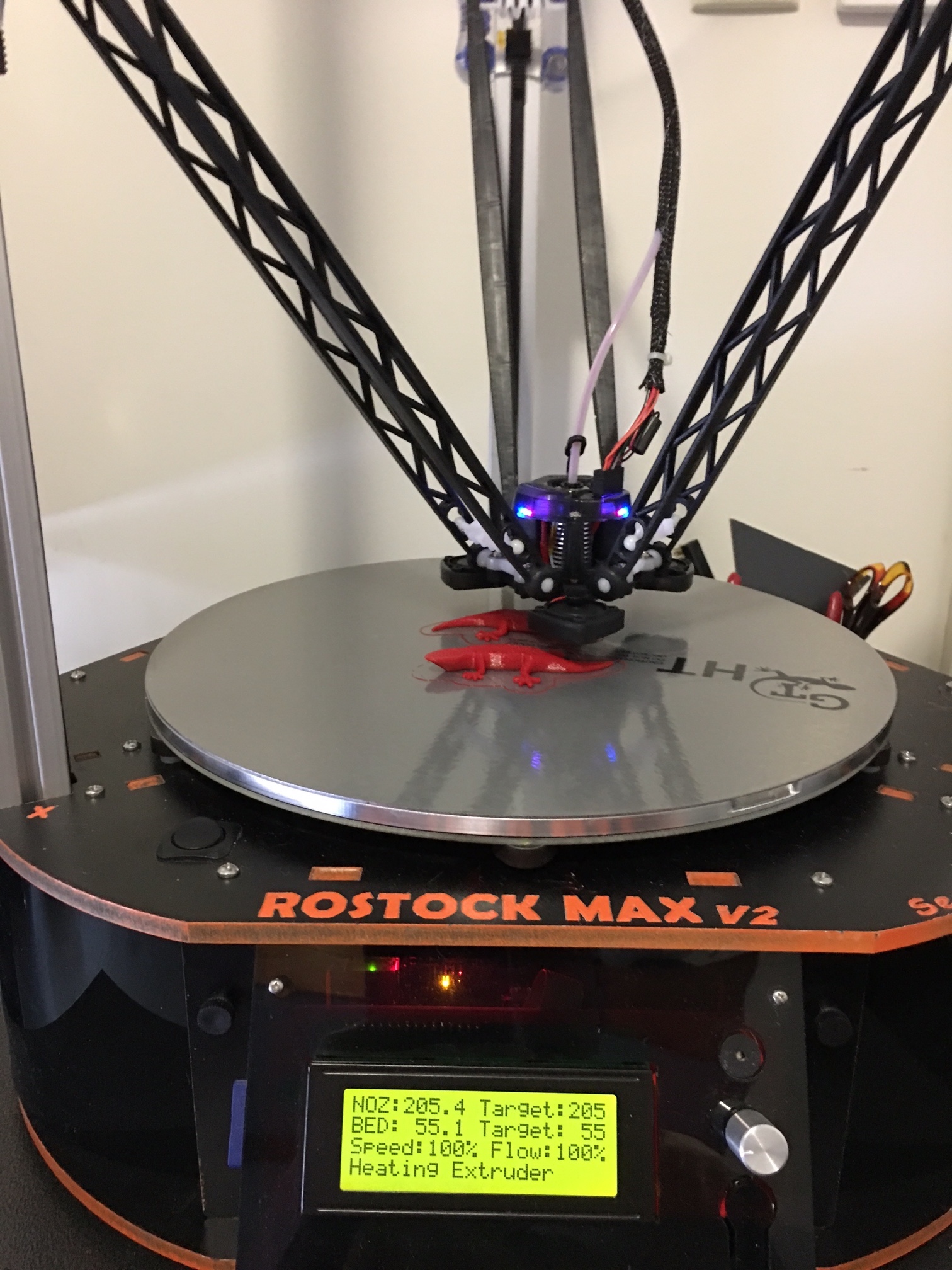

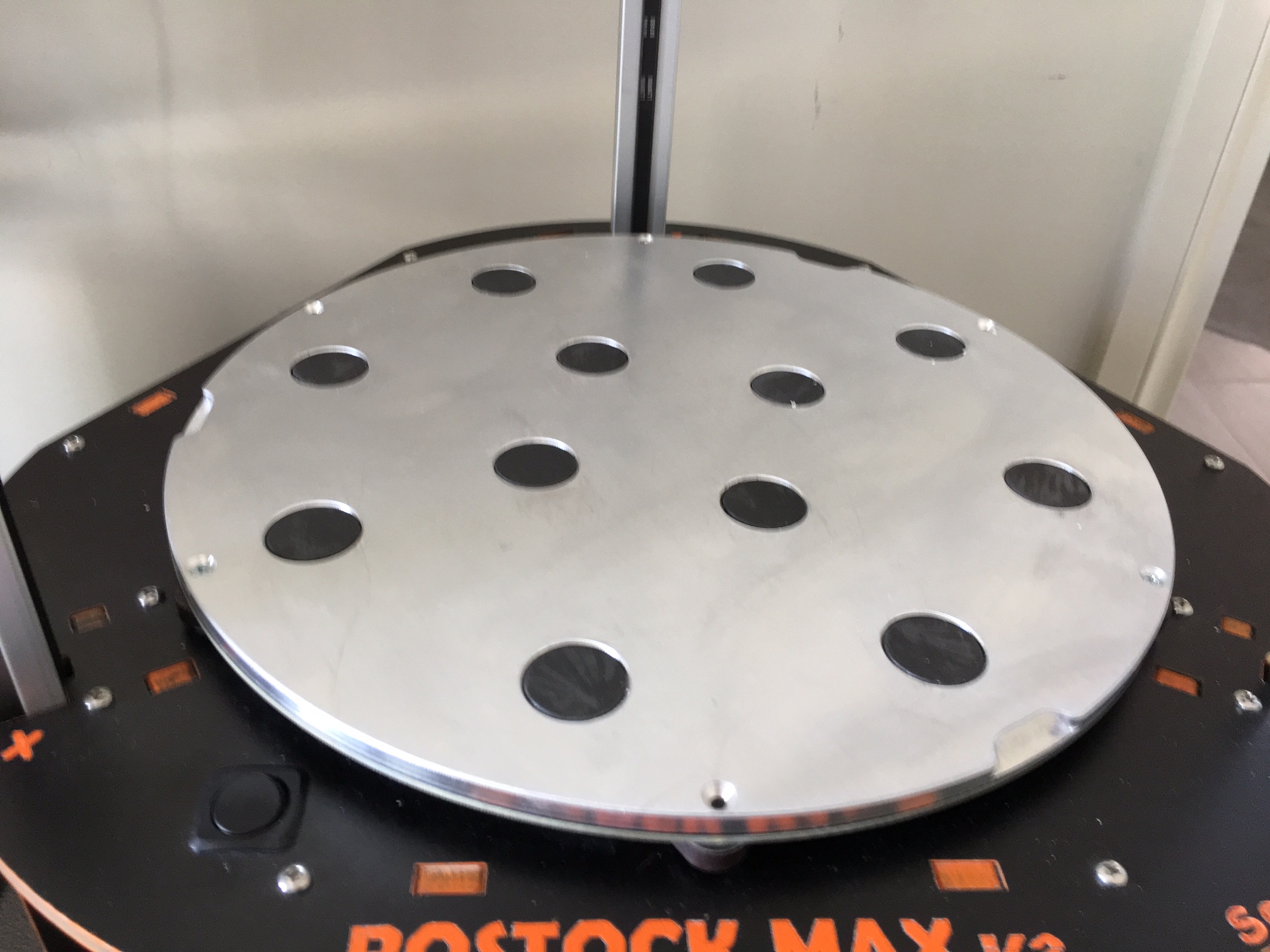

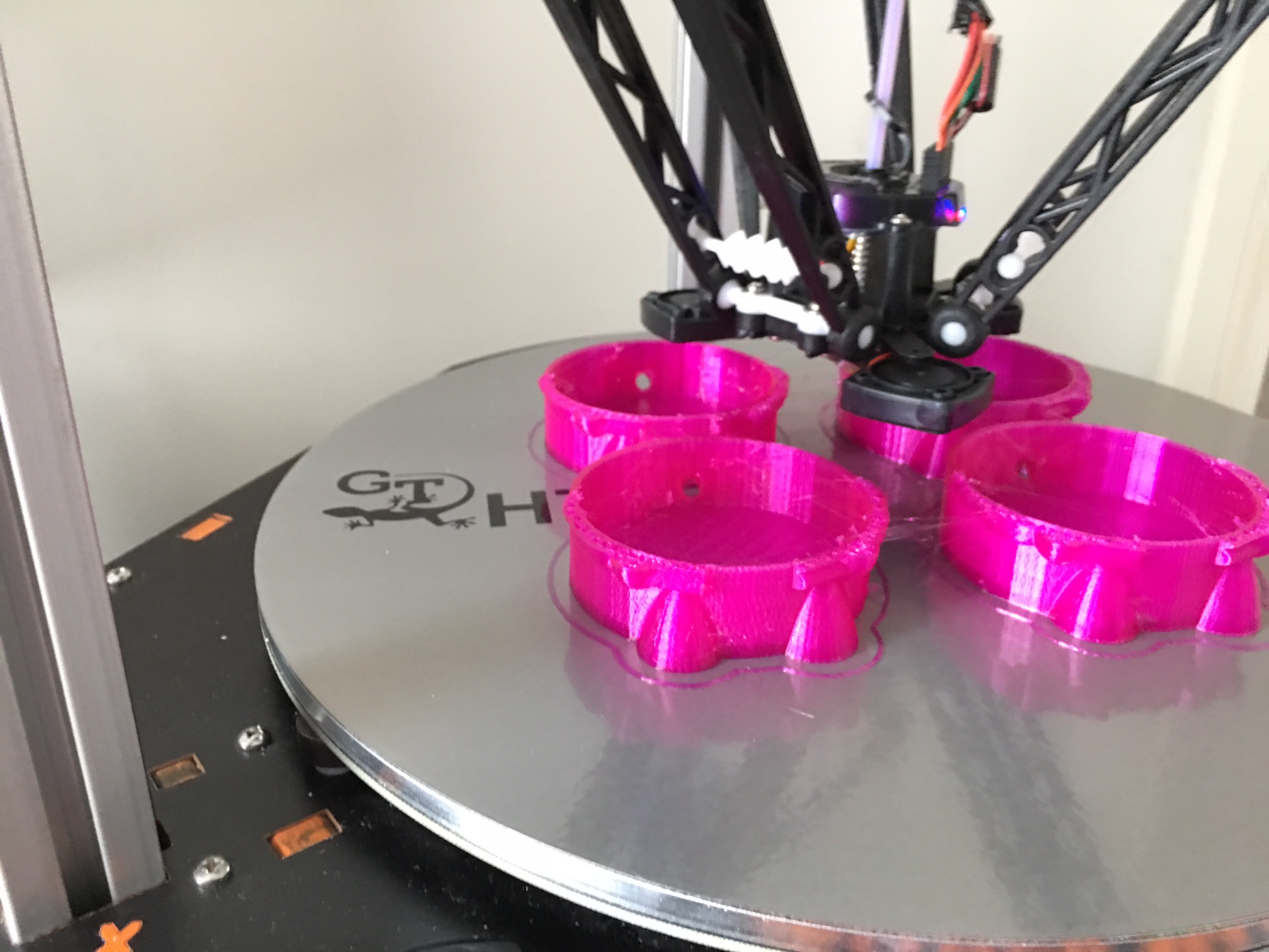

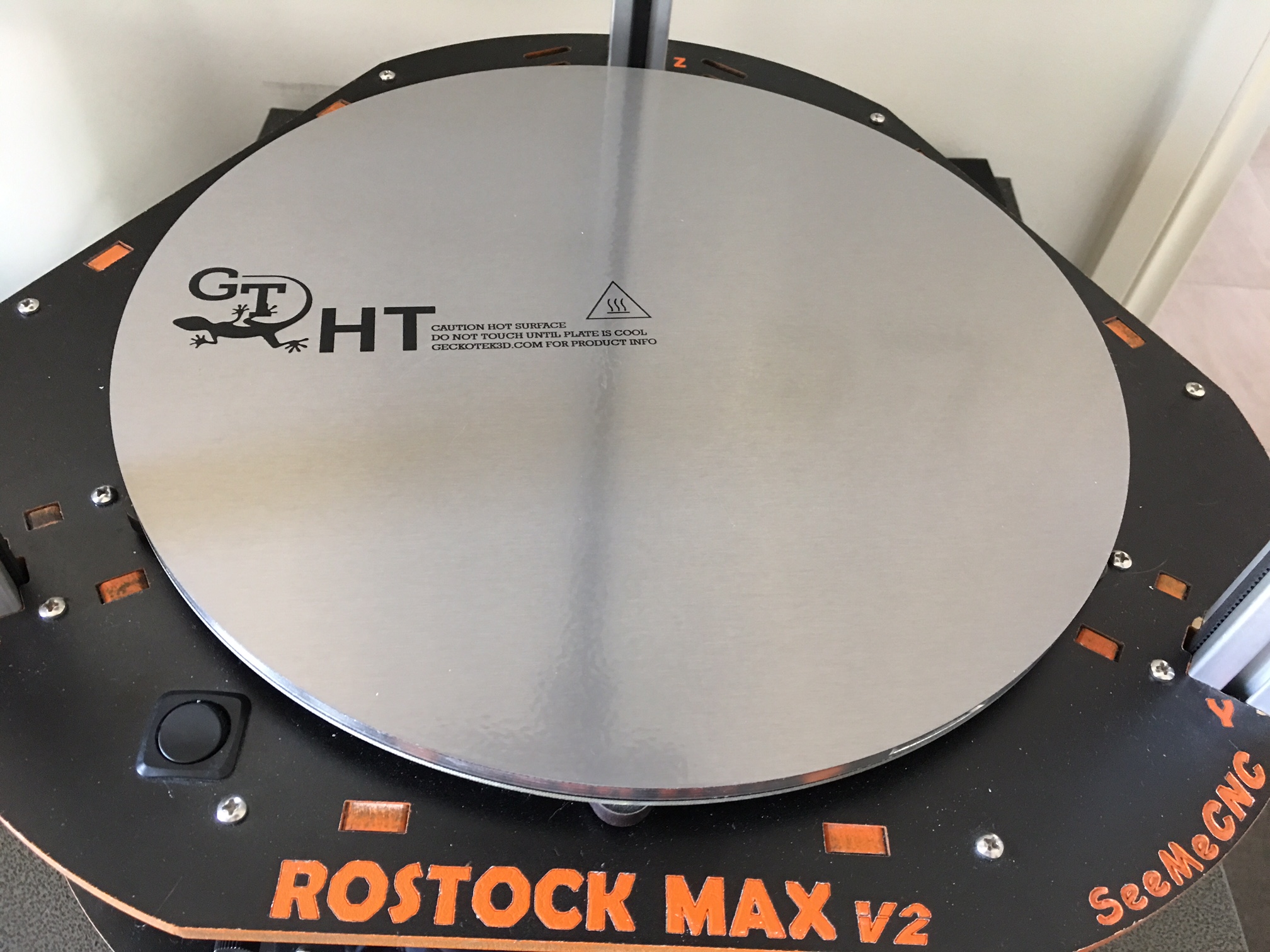

Just installed a GeckoTek build plate (with magnets to affix the HT build surface) and doing a test print of four planter/pen storage items. No glue stick or hair spray needed. GeckoTek3D.com to get more info and I am not affiliated with the company, I just like their product. The build plate is about 6 or 7 mm thick and it does take some time to heat up so if you are after speed, well... maybe 24volts!. It is fine for me at this stage though.
GeckoTek Plate
GeckoTek Plate
A couple of things that you need to be aware of, the nice red led's still work but there are no holes in the build plate so you can't see them. Same goes with the build surface, no holes. As I am a rather disabled chap with the use of only the left arm and left leg the addition of the build plate that is attached to the surface with magnets has just made my printing life so much easier. The prints just "pop" off with a slight twist after the HT surface cools and it is removed from the magnets.

I have been in contact with GeckoTek and they are willing to do some mods and give me one to test... in Australia :) but I don't know that he knew where I was from.
Anyway the end story is they did not have any Rostocks to do trial fittings on so make sure you send details of the number of holes that you would require and I'm sure they will do them for you. I am VERY happy with mine.......
Bob

More info re the GeckoTek3D plates...
GeckoTek 1
GeckoTek 1
GeckoTek 2
GeckoTek 2
I have only screwed it on to the 3 screw holes adjacent to the towers... there are 6 screws provided if you really feel the need to have them all installed.

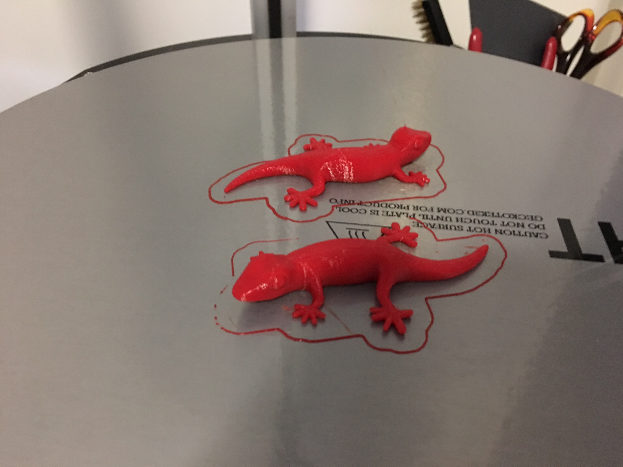

Some more gecko's.....
They're Multiplying.....
Better piccy :)
Better piccy :)
After using it for a couple of weeks I'm very happy with it :)
