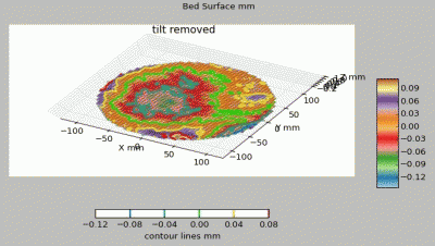

Note sure where to post this. But it could help any that have a HE280 Hot end. I created a python program that can map the bed surface using the latest SeeMeCNC firmware and the G30 command. This sampled the bed every 5mm and took about 45 minutes to complete. You can change the sample area and step size among other things. I found it interesting to try different values of horizontal radius and see what that did compared to the callibration selected value.
Attached is a .gif file that I hope will play on this forum. It is a pan around the surface.
Here is the python code. You will need python 2.7 or 2.8 and also matplotlib, numpy, pyserial and wxpython python libraries. It has only been tried on windws system.
Code: Select all
