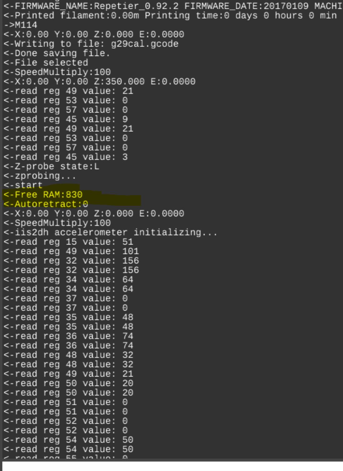

Hello all,
I hate to make a post about this but I can't seam to find this exact issue to go off of. I have a v2 with trick-laser arms, molded cheapskates and of course the HE280. Everything got wired up with the per-assembled whip and I have check continuity on all wires and confirmed proper placement in the diagrams. Everything is groovy until I try to calibrate and it goes down like it should, hits the bed and just keeps on truckin down without stop. I have to estop it. I know there have been some that say you have to run it a few times when it does that to get it to work but this seams extreme. I did confirm in the firmware I have it set to 2 for a v2 with my ATX power supply and all that. Is there a way to see the output from the accelerometer to see if it getting a signal back to the rambo? Thank you in advance.

Re: HE280 Crashes right into the build plate durring setup
Here are the mods i made to Repetier 0.92.2 (2016 12 27) - configuration.h for my v2 HE280 upgrade (molded carriages, SeeMeCNC ballcup arms).
When you first connect to your printer, do you get a listing in the terminal something like this? (presumably indicating good communication with accelerometer).
What is the material of your print surface?
What are you using for a calibration script?, are you following the SeeMeCNC Wizard?
Are BOTH the Bed and HotEnd Off during calibration?
Hello and thank you.
I actually followed your settings from another post. so they should be the same
For the console output I get something similar
Yes both the heaters are off and yes I am using the script and guide. Something I did notice when I was just having the Z travel down using the control panel it hit zero way before the bottom of the build plate, which is just the glass one, and it stated it did start at 350 so maybe steps per mm is off or something?
Does it recover from that point and continue, or just try to keep going?
Can you export your EEPROM settings to a file and attach them?
Have you measured (or know) your arm length precisely?
Can you see exactly where the nozzle is striking the bed - to the inside or outside of the white line?
It just sits there and tries to go lower, eventually it tries to go to another position but I'm afraid to let it keep going and break something. Yes, it is the 291 that is in the eprom that I have attached. It's inside the line, I attached a youtube link as well above. Thank you for your help.
I stand corrected, after changing the z probe speed and confirming the arm length because it was off a bit it is hitting outside the white line, not inside. Sadly those two changes did not help.bruceg wrote:to the inside or outside of the white line?

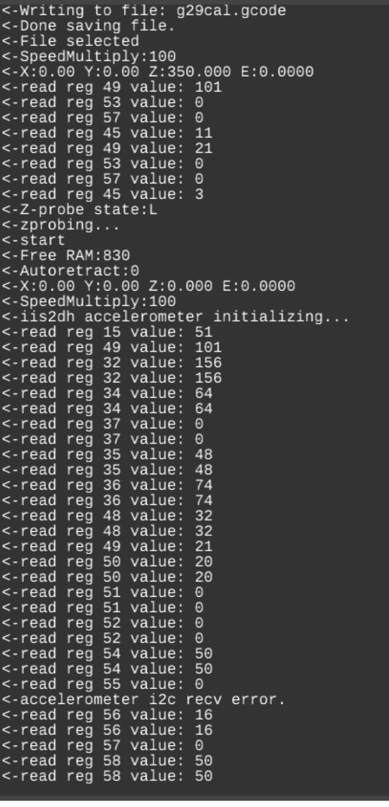

What is happening is that the machine is going down to about 20 mm above the bed and then it will try to find the bed by a probe. That probe is when yours is crashing because it never detects the bed and so just continues trying to push the head lower. Mechanically it can not go lower and so as the other two arms go down that pushes it over and out toward the side. The ratcheting sound you hear is the belt slipping on the X stepper.
I think your accelerometer may not be working. There is a command to check it. M261. It will print out a bunch of reg values. Reg 49 is the important one for this. After reset it should be 21 or very close to that. Then thump/flick the hot end with you finger. That number should change when next you send M261. When I push the hot end down onto the surface with my hand to make it click a little I get 101 as the value. The next M261 will reset it and it should go back to 21.
I had similar response to your bed crash video when my initial eeprom settings where wrong or left over from the previous V2 build. After clearing them it worked the next time. So eeprom settings could be the problem but I don't see anything out of range. So maybe it is a problem with the Z probe.
I ended up using the V3 config and changing the max Z height, y-dir like an earlier poster did. That seemed to work better than using V2 as a starting point.
Thank you for your insight. I was able to check the sensor and it responded just like you described. I will try the V3 and report back.Dale Eason wrote:What is happening is that the machine is going down to about 20 mm above the bed and then it will try to find the bed by a probe. That probe is when yours is crashing because it never detects the bed and so just continues trying to push the head lower. Mechanically it can not go lower and so as the other two arms go down that pushes it over and out toward the side. The ratcheting sound you hear is the belt slipping on the X stepper.
Changed to the v3 with the changes indicated earlier, attempted a calibration and the exact same thing happened. I've attached the output.
The ONLY command you should be sending for calibration is G29. The calibration script is deprecated and has been removed from the docs.
Did you clear your EEPROM before uploading the different Repetier configuration?
For what it is worth, at least in 0.92.2 21061227, a search for the variable PRINTER does not yield any differences (aside from some printer identification messages) for PRINTER == 2 vs PRINTER == 5 outside of configuration.h Within configuration.h, the differences to my eye are:
PRINTER == 2 - vs - PRINTER == 5

Here is what I get when sending the g29. The first auto-leveling enabled was me setting the value to 1 manually in the eeprom settings. It seams to turn off during the probe which I suppose makes sense. For the effector no, when it contacts the bed if just tried to keep going. And yes, I did clear it after every change.bruceg wrote:Did you clear your EEPROM before uploading the different Repetier configuration?

Maybe try a little experiment. Send it a g28 (home) and then G0 Z20 (move to x 0 y 0 Z 20mm) That should send the head to about 20 mm from the bed surface and in the center of the bed. If it is there then try G30. That should probe the bed twice at the center. If that works you can try various combinations of G0 Xsomething Ysomething Z20. Where something is replaced by values in mm. Then at each of those you can try a G30. A G30 all by iteself is a probe command from the current position. It will not change any values in the eeprom but you can use it to prove out the probe works.
Dale
