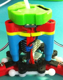

Just got around to installing an HE280 (+ wiring whip) on a v2 and thought i would summarize in one place what i gleaned from the various forum posts.
tl;dr - smooth sailing following the guides, calibration couldn't be simpler with the wizard, upgrade well worth the effort.
Thanks as always to geneb, mhackney and all on the forum and particularly in this case JJ Johnson for the HE280 guides and Dave Crocker for the Calibration Wizard.
Machine is a late 2014 v2 ATX power supply upgraded with molded cheapskates, ball cup arms and a variety of home brew extruders. Build platform is a much abused 2mm PEI sheet bonded to the standard glass plate. Was running Repetier 091.

Delta Configuration Wizard was simple to use (note that the "PROBE-ZOFFSET:-x.xx" number appears a couple of lines or so above the pause, but you can always scroll back). Started out with cold bed and hotend, then with bed heat on and nozzle hot but turned off. No problems. Then tried with the hot end heat on. As advertised this was problematic with a failure the first go but success on the second. If this is an electrical noise problem (presumably associated with the PWM) it would be interesting to see if running the I2C and interrupt lines in shielded cables would help.
With one round of hot calibration, first layer thickness variation over an ~200mm track across the bed was +/- 0.06mm vs > +/- 0.15mm with my best efforts at manual calibration on my lumpy bed. Bottom line, a problematic model that had been giving me fits with bed adhesion printed on the first go. Now on to the Prometheus hot ends...
[img]http://forum.seemecnc.com/download/file ... w&id=14232[/img]

Maybe running the I2C and interrupt lines through a ferro core would help eliminate the noise? Just a thought. They're fairly cheap and can usually be snapped around the cable. It would be an easier thing to try first before having to switch out cables. Awesome post though! I'm thinking about upgrading my hotend, I have the same model Rmax. Did you just run a new set of wires through one of the pillars?
--nil volentibus arduum

cyber.shifter,
Indeed, ferrite cores are suggested as a solution. Perhaps you have already spied this report. ETA However are not applicable to this problem - see mhackney below.
The wiring interface for the HE280/Accelerometer board is accomplished by sniping off the old hot end wiring around the level of the extruder and then making splice connections (which can then live in the top section) and swapping around a few connections on the RAMBo board. So NO new wires need to be pulled (provided you are ok with the hot end fan running all the time). You can get a pre-made wiring whip that you splice into your existing wiring which will give you both the connector for the accelerometer board and the two connectors used at the RAMBo. To make your own bespoke harness, get a plug for the accelerometer board (SeeMeCNC) or (Digikey) and plugs for the RAMBo, one each of 4pos and 2pos and minimum three (for those who crimp perfectly every time) of crimp Sockets . The advantage of the SeeMeCNC whip is that the wire colours will match the guides and documentation.
My dim thinking on the shielding was based on the following:
1) The wiring In my machine has two pairs (Red/Black) of 26ga wires running in the Y-tower extrusion that previously connected the HotEnd/PEEK fan (Heat 1 +/-) and Part/Layer Fan (Fan 0 +/-) and 2 pairs of 18ga wires running in the Z-tower; Red/Black connecting the HotEnd Heater (Heat 0 +/-) and Green/White connecting the HotEnd thermistor (Thermistor 0).
2) The new wiring results in the following connections (listed as old function/RAMBo label to new function/accelerometer board pin connector number) Note: please don't trust me - follow the guides - they will lead you through with no thought required!!)
Y-Tower Wires:
The old HotEnd fan wires become the I2C pair (Heat 1+[Red26ga] > SDA Pin6[Red26ga], Heat 1-[Blackk26ga] > SCL Pin5[Blackk26ga].
The old Part Fan wires change as follows (Fan 0+[Red26ga] > INT Pin7[Blue26ga], Fan 0-[Black26ga] > Part Fan Switched Ground -Pin1[Orange26ga].
Z-Tower Wires:
The old HotEnd heater wires change as follows (Heat 0+[Red18ga] > 12V Constant Supply Pin2[Red18ga], Heat 0-[Blackk18ga] > HotEnd Switched Ground Pin3[Blackk18ga].
The old HotEnd thermistor wires change as follows (Thermistor 0"lower"[Green18ga] > Thermistor Signal "+" Pin8[Green26ga], Thermistor 0"upper"[White18ga] > Accelerometer Board Common Ground -Pin4[White26ga].
3) Under the presumption that the HotEnd Switched Ground is the trouble maker via noise induction in the wiring (vs on the board) when calibrating with the HotEnd on (and the part fan is not running); i thought it might help to run the I2C as a separately shielded pair and the interrupt (probe output trigger) in separate shield in the whip section only as the HotEnd switched ground and the communication signals run in separate towers. This would still leave the problem of making a connection for the shield drains to a good earth ground. One could consider making a connection via grounding one of the towers and connecting the drain in the top, swallowing one's pride and running an external wire or more properly, pulling one drain wire through a tower.
You are most likely right however, that the most practical approach would be to make the "hard" decision to sacrifice one of the half dozen or so VGA cables i have been dragging around for the last 30 years or so and apply the ferrite beads. The simplest option of course is to not worry about the effect of nozzle expansion on Z and calibrate with the bed at temperature and the hotend off (+/- preheated) per mhackney - i will try and link a couple of threads on this topic once i get the driveway plowed.
For anyone applying an accelerometer board to a v2 i recommend looking at the whip wiring and the accelerometer board image (along with the guides) particularly if you plan on making your own harness.

This looks nice and colorful! Mind mentioning the models if they are available?

@ adarcher,
i am just finishing up a suite of standoffs for different nozzle sizes/setups. Will try and get them posted on thingiverse in the next couple of days. Hardware wise the system uses 6 of M4x16mm Button Head socket head cap screws
and here they are in all their multihued splendor....
