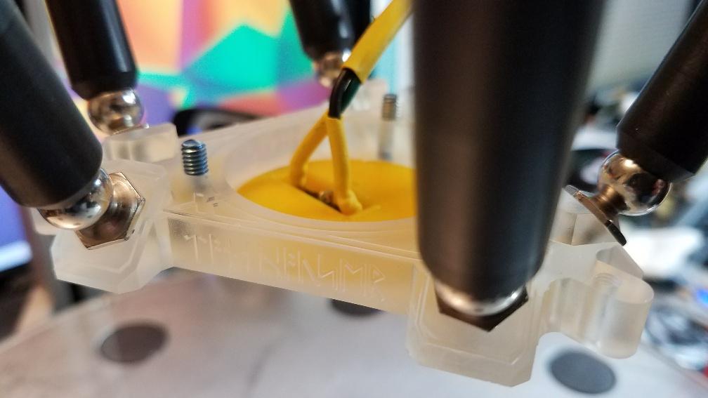

I have been working for some months to refine those designs. They look slightly different now, especially the carriages. They have a different/better belt clamping mechanism that's designed to fit the tooth contour of the GT2 belts.
The trouble is that printing them on a 3D printer that doesn't have utterly perfect positional accuracy gets you an effector and carriages that are slightly worse than the ones that are already on the printer. It seems you can't make these parts more accurately than what is already installed - and if your printer is already perfect, then you don't need these in the first place.
I tried using a resin printer to do these parts. The carriages came out very well. However, resin printers have an Achilles' heel: the parts have to be positioned at odd angles for drainage and runoff, and to reduce overhangs; PLUS you have to put supports on a lot of places to help the part survive the peeling process between layers, PLUS there are surfaces that have to be flawless and thus can't have any support structures attached to them. Trying to balance those three requirements made me feel like that guy who has to push boulders around in Hell. Because of specifics of the effector's geometry, it's not possible to get a good print, even on a printer as good as the Form 2. The captive locknut channels all come out different, even though they are identical in the model.
Next step is to get these parts machined from aluminum. I'm working on that now. If they work well enough, I will sell them.
If you don't want to wait for me to figure all that out, you can buy an effector/carriages from Haydn, the guy who sells the arms. They are 3D printed, so they aren't perfect. Since my goal is to have the absolute maximum dimensional accuracy, I decided not to go that route.

Looks like the 5-axis idea is out of the question. The site I was using to get a quote has an idiosyncrasy that can make you think you're getting the price for machined 6061 aluminum, when you're actually getting the price for sintered nylon. 5-axis machining is too expensive for this, for the time being. I'll look into other options later this year.
The old design uses captive nylon locknuts to hold the joints in place. I think I mentioned above that this makes it very difficult to print properly on a resin (SLA) printer. Since I had to redesign the effector in Fusion 360, and since Fusion 360 has the ability to cut accurate threads directly into the model, I decided to drop the locknut idea and just thread the holes the ball joints screw into.
I finished printing a prototype on the Form 2 earlier today. The threads printed a little tight, so I had to use an M3 tap to clean out the first few millimeters, but the ball joint screws went in just fine. The tightness of the threading gives the screws something to bite into, just like the locknuts did before. Having the whole length of the holes threaded also makes it easier to calibrate all the ball joints to be at the same elevation.
This is the result. The threads printed beautifully, and I don't have to use locknuts to secure the probe mount anymore.
I mounted the new calibrated effector to my printer, and ran my heuristic calibration routine. Average Z error is 34 microns, or 0.0013 inches! This is the best calibration I've ever seen on this printer.

I'm still using the old carriages, which have nylon locknuts. I might redo them in Fusion 360, giving them the same printed-in threads and ditching the locknuts.
If I can get these good enough, and if they make it through beta testing, I'll sell them.

They wanted over $400 to do a very basic version with no trim, and over $600 to do the "ornate" version you see here. That's just for bare aluminum. It was still more to get it anodized. Unless I want to sell printer parts exclusively to rich people, it just wouldn't make sense. I still want to do an aluminum version someday, if I can find a way to do it that doesn't cost so much.
Drilling the 45-degree joint block holes would be impossible on a 3-axis without some kind of really, really accurate fixturing, and considering that even my enormous 3-axis has only 5" of Z (some of which is taken up by the length of the router bit), it doesn't seem likely to work. Figuring out (0,0) on a CNC table router to within a few microns is... well, the phrase "good luck" comes to mind. I got pretty close for a big project I had to do, but I don't think what I developed is close enough for this application. The dimensional tolerances have to be as close to perfect as possible. My CNC couldn't thread the holes, either.
Since I already have the Form 2, and since it just produced a part that's given me the best calibration I've ever seen on this printer, it makes more sense to go this route.

That thought had crossed my mind. IM is an option for a mature product (doesn't need any design changes) with enough market to justify producing 100s or 1000s at a time. Getting the molds cut for something like that would cost somewhere in the five-figure range, if I'm not mistaken, plus whatever the IM shop charges for their time + materials + shipping. With SLA, or Xenocrates' CNC method (assuming my Probotix has enough Z to accommodate drilling the joint blocks), my cost to get set up is far lower, and I can make some design changes without the expense of re-cutting molds.
WIth SLA, I can reliably produce one set (effector, 3 carriages, plus cable clamping hardware for each carriage) per day @ 25 microns. There's also about an hour of labor to carefully remove support materials, put the parts into two alcohol baths, and then install and calibrate the heights of the ball joints. Doubling production would mean buying another Form 2 and some incidentals for it (cart, UV curing lamp, etc.), and I'd have to spend more time removing supports and calibrating the ball joints. I'll get faster at that the more I do it, and curing of multiple sets can be done in tandem.
If I sell enough of these, it will make sense to look into Xenocrates' CNC solution, because the limiting factor will start to be how many hours I have in one day. While it would require significant babysitting, there's no support removal or curing with CNC'd parts. With enough fixturing, my Probotix's huge XY envelope could allow me to mill ten or twenty of these at a time. I'd still have to hand-calibrate all the ball joints, but if the machine's tolerances are good enough, it might take less fiddling.
With either solution, there's also further testing to make sure that the parts can produce a good calibration. During the beta testing phase, the kits will all be mounted to my MAX Metal and run through a heuristic calibration to ensure that they're as good as the prototype I tested yesterday. I'll continue that practice in production to the extent that it's necessary.
