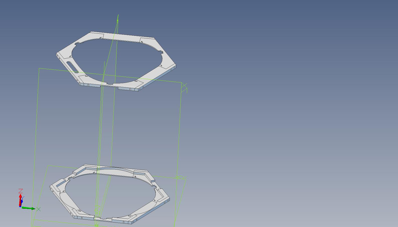

Post by morgandc »
As we all build enclosures you get more and more options. This is a traditional follow the contours of the base design, the brackets work both top and bottom with a stock v3. The existing screws are used to attach the main brackets, but must add in 1 screw on each side between each axis (top/bottom) during assembly. This is designed to allow for the full range of motion of the v3. I am planning on using the McMaster-Carr Heat set part #93365A156 but have not yet tested insertion in the design.
I have printed and done lots of pretesting on the parts for this enclosure, but have not ordered the Plexiglas yet. Final print/bracket assembly will be this done this weekend, printed very slowly. You can click on any part in the PDF to view in 3d if you have the latest PDF viewer.
Original Version- not quite full clearance - Removed
Update: Updated files for additional clearance, less parts and a little more "flexibility" if the printer or laser holes aren't perfect...

Sorry about the delay, I was working on the printer/enclosure this morning and discovered a tweak was needed in the lower fill piece to allow max clearance. Also, I had to adjust the Lower Bracket to be slightly thinner to allow the homing process. There was enough clearance for operation, but not to endstops....I had a cranky printer.
Updated the files above, still in the test fit process. I am expecting to need a custom fill piece around the extruder as well.

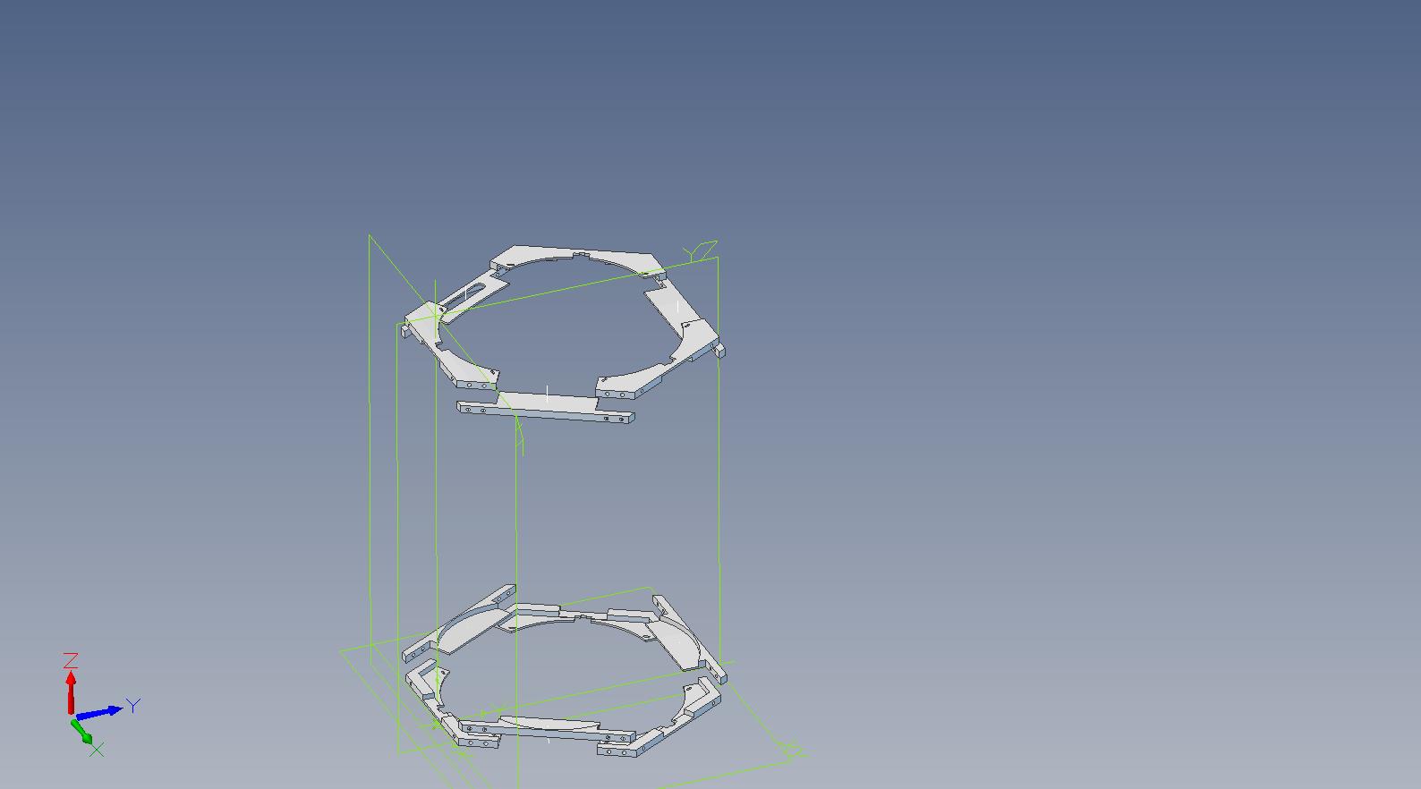

The updated v3 files have been posted, I was having extruder issues so mine are UGLY. I will need to reprint :) I am finding that enclosing the PLA is a good idea as well, so I will probably order plexiglass when I decide to give my printer a break and reprint the frame so it looks decent.
Significant redesign to allow for the laser cut holes to not be perfectly aligned (or my assembly methods). I found the old one went on, but was too tight which cause it not to look as nice as it caused gaps between parts.
v3 Base assembly v3 Top and Bottom.pdf
(99.41 KiB) Downloaded 604 times
v3 Full enclosure v3 exploded view.pdf
(96.82 KiB) Downloaded 486 times
