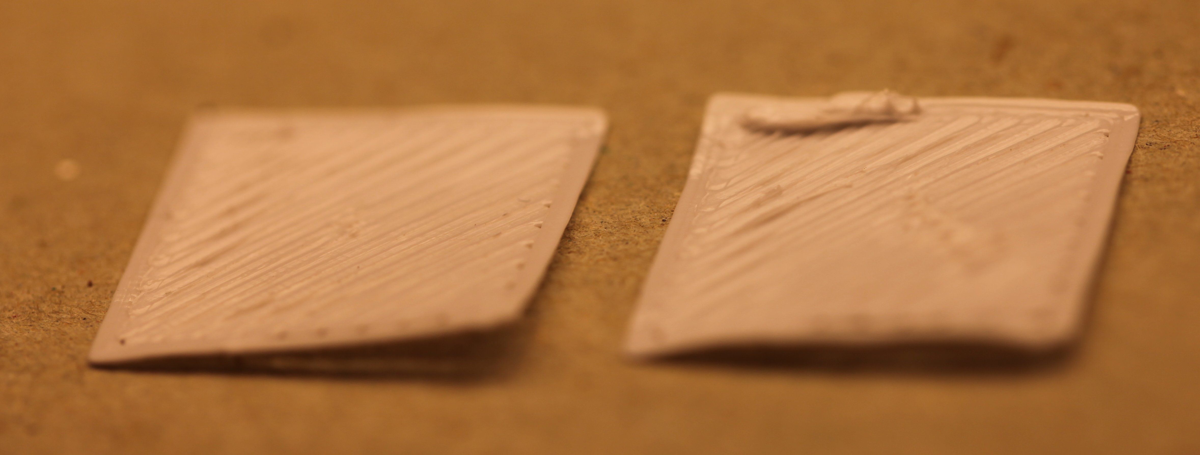

I'm getting a big blob at the end of each layer caused by the G92 E0 command and I'm confused.
I've attached a .gcode file for a 20mm flat plate and I get a blob.
If I comment out the G92 E0 at the end, I do not get the blob.
Can someone help me understand this?

OK, I found out it's the G92 E0 combined with a G28 X0 that causes the extrusion.
Could you try this?
Set your extruder temp to whatever filament you have and wait for it to heat up.
g0 x0 y0 z50 ; Move near the bed.
g1 x100 e10 f1000 ; Move to the right and extrude some filament
g92 e0 ; Set Extruder current position to zero
g28 x0 ; Home the "x" axis
I see a slow move towards X==0 with the extruder running!
If I remove the g92 e0 from the above test, I see a slow move towards X==0 without the extruder running

Why are you homing just the X axis on a delta machine?
I would remove the X0 from the G28 command.

Jrjones wrote:Why are you homing just the X axis on a delta machine?
Yes, this is the default end G code for the Slic3r slicer.
I changed it to a G28 Z0 and the problem went away.

Cool. Just a G28 does not exhibit the problem.
I'll debug the Arduino code and see if I can push a fix to GitHub.

G28 X0 under certain circumstances causes the extruder to run and pump filament out the nozzle.
It should not run the extruder.

OK, I've got a one-line fix to Printer.cpp so there will be no extruder operation on homing.
G28 X0 first moves to X=0 and then homes in Z
G28 Y0 first moves to Y=0 and then homes in Z
G28 Z0 (or G28) moves directly vertical as it homes in Z
None of these extrude filament now.

Here's a slice of G code produced by Slic3r. Is it really incorrect?
G1 X30.000 Y26.654 E36.69181
G1 X-30.000 Y26.654 E41.58977
G1 X-32.190 Y26.270 E41.77129
G1 E39.77129 F2400.00000
G92 E0
G1 X-29.205 Y19.205 F7800.000
G1 E2.00000 F2400.00000
G1 F1440
G1 X-29.205 Y-19.205 E5.13550
G1 X29.205 Y-19.205 E9.90365
G1 X29.205 Y19.205 E13.03915
Posts: 5359
Re: G92 E0 causes a lot of extrusion.
You know what G92 E0 does? It sets the value of the E axis to zero. It doesn't move anything.
The end code should be a G28 all by itself. G28 X0 is for a cartesian printer. (Which makes sense because you're using Prusa's fork of Slic3r, which is pre-configured for the i3 Mk2)
G28 X0 will cause the effector platform to wipe the nozzle across the surface of the part, pulling rapidly cooling filament out of the nozzle as it moves, leaving you with a blob.
Eric
Posts: 717
Location: Chula Vista, CA
Post by Eric »
AlanKilian wrote:I'd like to go back to another discussion about G4 P0 and command queues.
I will test this theory next week, but is Slic3r really generating incorrect G code by not adding a G4 P0 before every G92 E0?
AlanKilian wrote:If a G1 followed by a G92 requires a G4 p0 in between them, the Slic3r is producing incorrect G code.
G92 E0
G1 F1440
You must have skimmed my previous response where I said I was was wrong about the need for G4 P0 in this case. My processing analysis remains the same, it's just that G92 only affects future gcode processing, so there's no actual conflict. The code above is probably fine. Note how the E parameter on G1's changes from E39.7 (a -2 retract) before the G92 to E2.0 (a +2 unretract) after the G92. Any queued moves are stored as deltas, so they shouldn't be affected by the reference point change.
A case where G4 P0 WAS needed was before servo commands for someone who had added a hobby-type servo-controlled feature to their printer The servo Mcode is immediate execution on a real-world motor, not synced or even part of the motion queue.
AlanKilian
Posts: 33
Joined: Wed Nov 23, 2016 3:30 pm
Location: Cambridge, MA
Post by AlanKilian »
geneb wrote: G28 X0 will cause the effector platform to wipe the nozzle across the surface of the part, pulling rapidly cooling filament out of the nozzle as it moves, leaving you with a blob.
If it's after a G92 E0, it also causes the extruder to run forwards and actively extrudes a large pile of filament onto the top of the part.
Depending on the length of the previous extrusion, it could be quite a large pile.
I created an issue on GitHub and posted a fix for this issue as well as have changed the Slic3r end G code to do a G28 instead of G28 X0
Thanks everyone, this has been a ton of help to me.
Posts: 5359
Re: [Solved] G92 E0 causes a lot of extrusion.
Once again, G92 E0 moves nothing.
