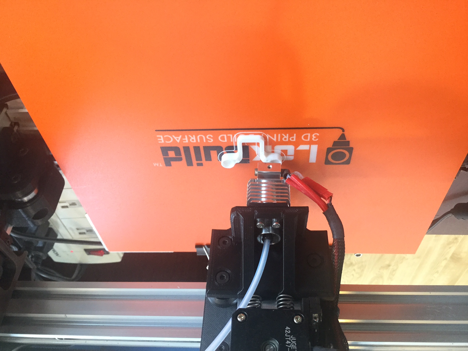

I am super impressed with this sheet of lokbuild and I don't impress easily! It is from a kickstarter campaign. http://www.LokBuild.com
PLA with no heat sticks every time and pops off with a snap when ready. I'm curious about its longevity compared to PEI.
Really hate when it prints upside down

Is it an adhesive sheet, or does it come in a plate?

It's an adhesive sheet. - sticks down quick with no air bubbles

What sort of surface finish does it have and leave on the part?

It leaves a nice matte finish. It seems to have similar surface to a thin flexible cutting board.

So far, after 15 or so prints it is good. Any residue scrapes off with a razor blade as would PEI.
One problem - I use my nozzle as a Z-Probe to auto set my Z Height, so after heating the nozzle and it touches down it dimples the build surface where the hotend makes contact. Those dimples have stayed dimpled, if you will.

Ok, Love affair with LokBuild is over. Back to my 2.5 year old PEI... like putting on an old pair of shoes. The Lokbuild just isn't good enough for day in, day out printing.

Lokbuild just isn't good enough for day in, day out printing. Too much left over plastic from previous prints... Dimples from my Z probe... scratches crazy easy... TPU was unremovable and left residue even after careful scraping.. left ugly finish that transferred to next print.
You know, stuff that PEI does not do.
