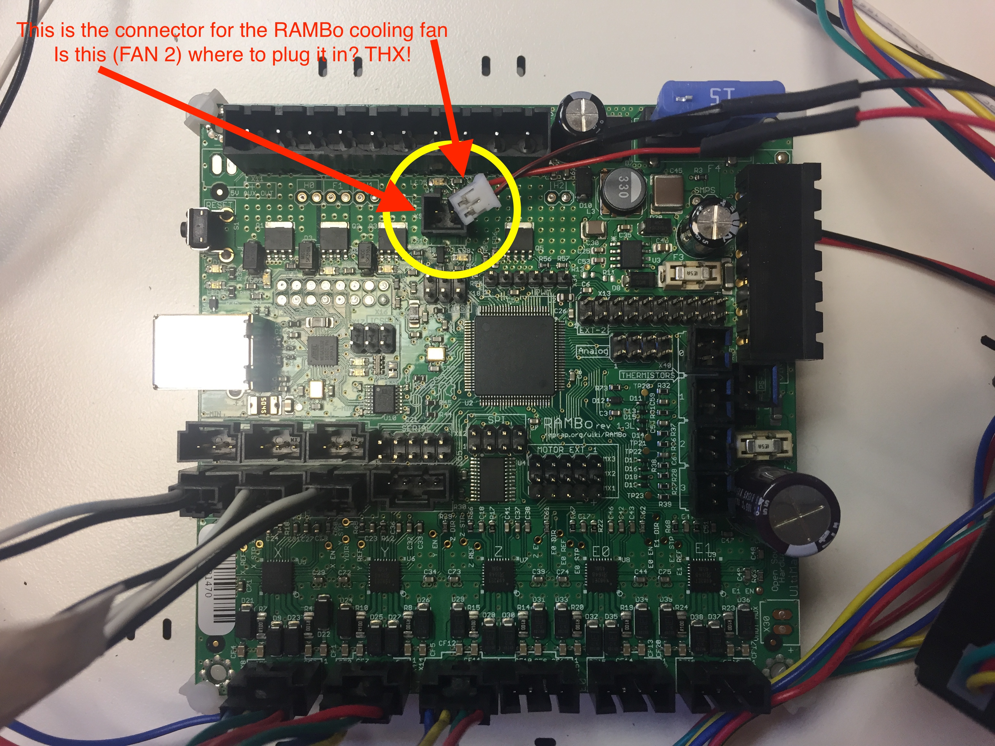

I'm building a Rostock V3 and can't find the for sure right connection for the 40mm Rambo cooling fan on the board -- is it Fan 2? My board doesn't have the connection in the lower right shown in most documentation... Thanks for any input.

Any constant (always on) 12v source will work.
Re: connection on Rambo v1.3 for 40mm Rambo Cooling Fan?
Thanks Joe -- here's a picture:
Would this be a constant source? As far as I can tell, the answer is Yes -- but hoping to confirm...
Page 183 of the V2 assembly manual shows that the cooling fan leads get soldered to the board at the bottom right hand near the E1 motor connector.
Thank you -- turns out the connector was left off the board -- I will solder per your suggestion
According to the manual,,, there is no connector there,,, they expect you to solder directly to the board.
Page 183 of the manual....

He's building a V3, and the instructions do state; 40mm fan connects to 12v AUX output
Guide, step 15: http://seemecnc.dozuki.com/Guide/Step+3 ... ssembly/44
RAMBo connection image: https://d17kynu4zpq5hy.cloudfront.net/i ... ZuRqS.huge
Heh, well, sombitch! Must be an updated rambo.
