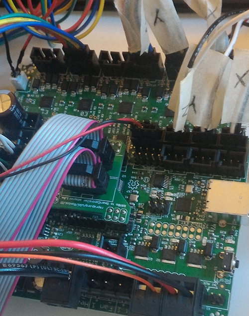

Does this look right?
Posts: 5359
Re: Max V3 Berkeley
You got bit by an error in the "updated" v3 dozuki. The bed thermistor should have some of that tiny PTFE tubing covering the leads. Without the insulation the wires can either short together or against the metal ring in the big hole that it fits through in the Onyx.

Post by Claymore »
Thank you,
It is fixed now.
We plugged it in and it seems to be working!
