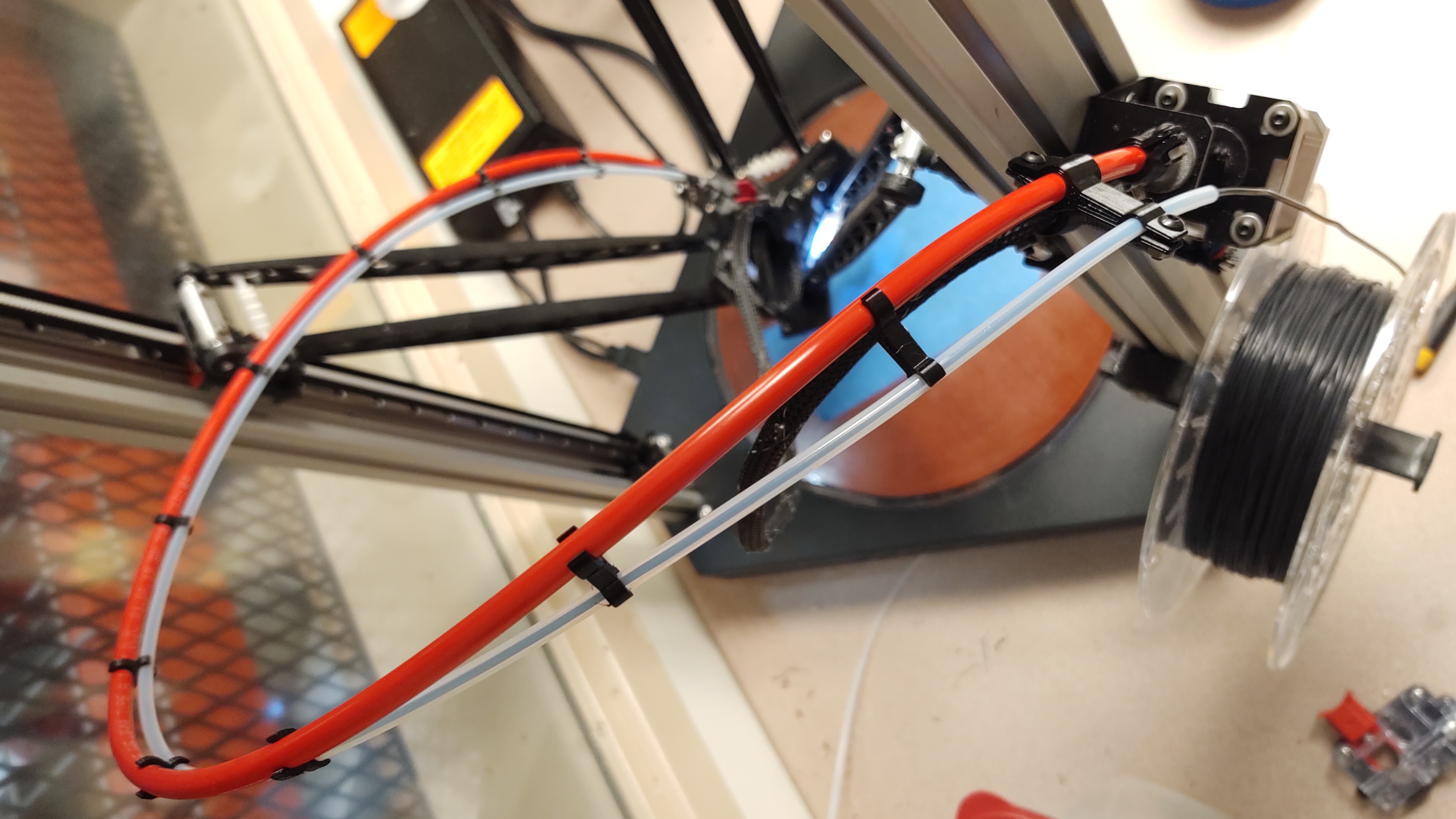

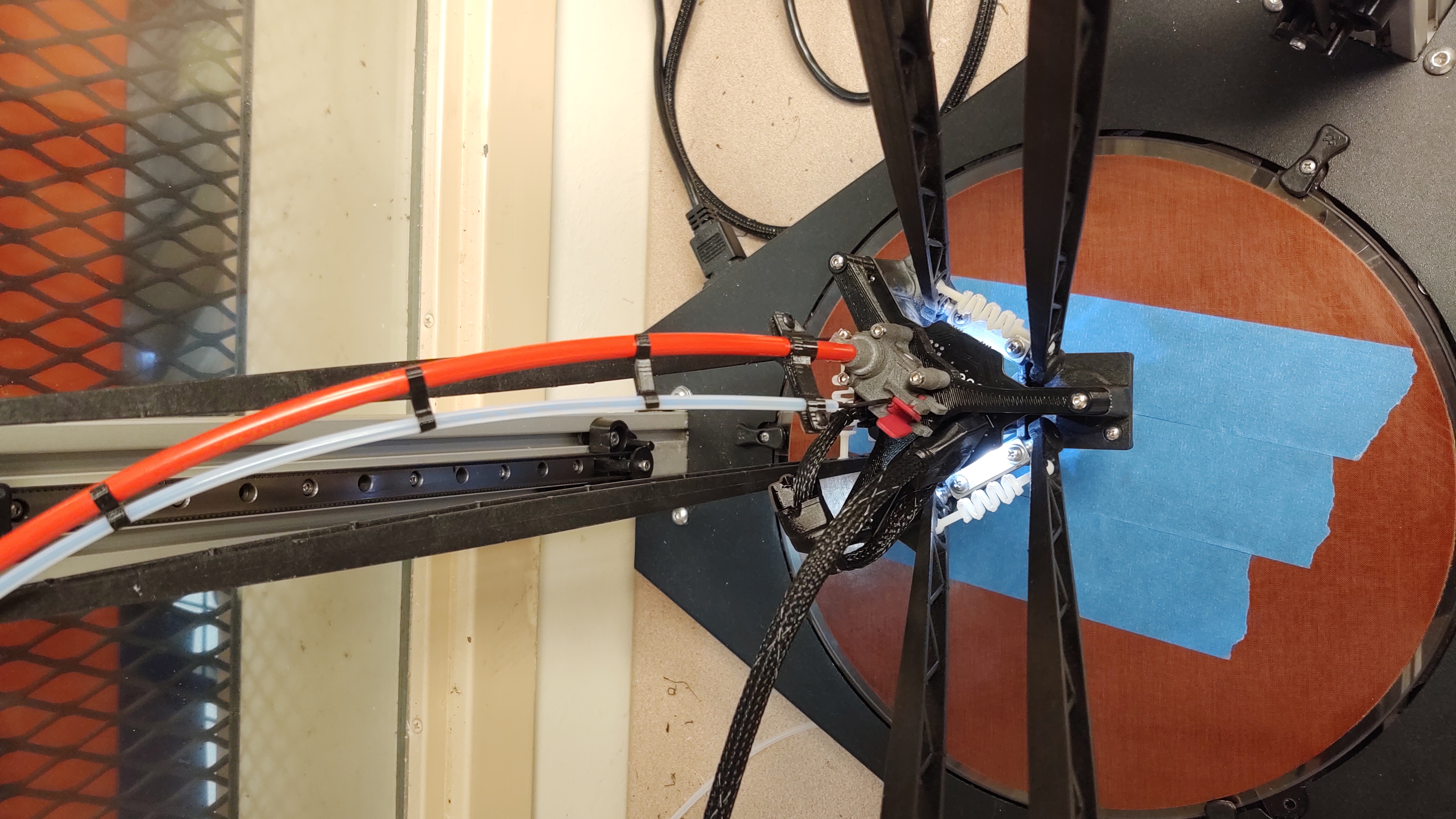

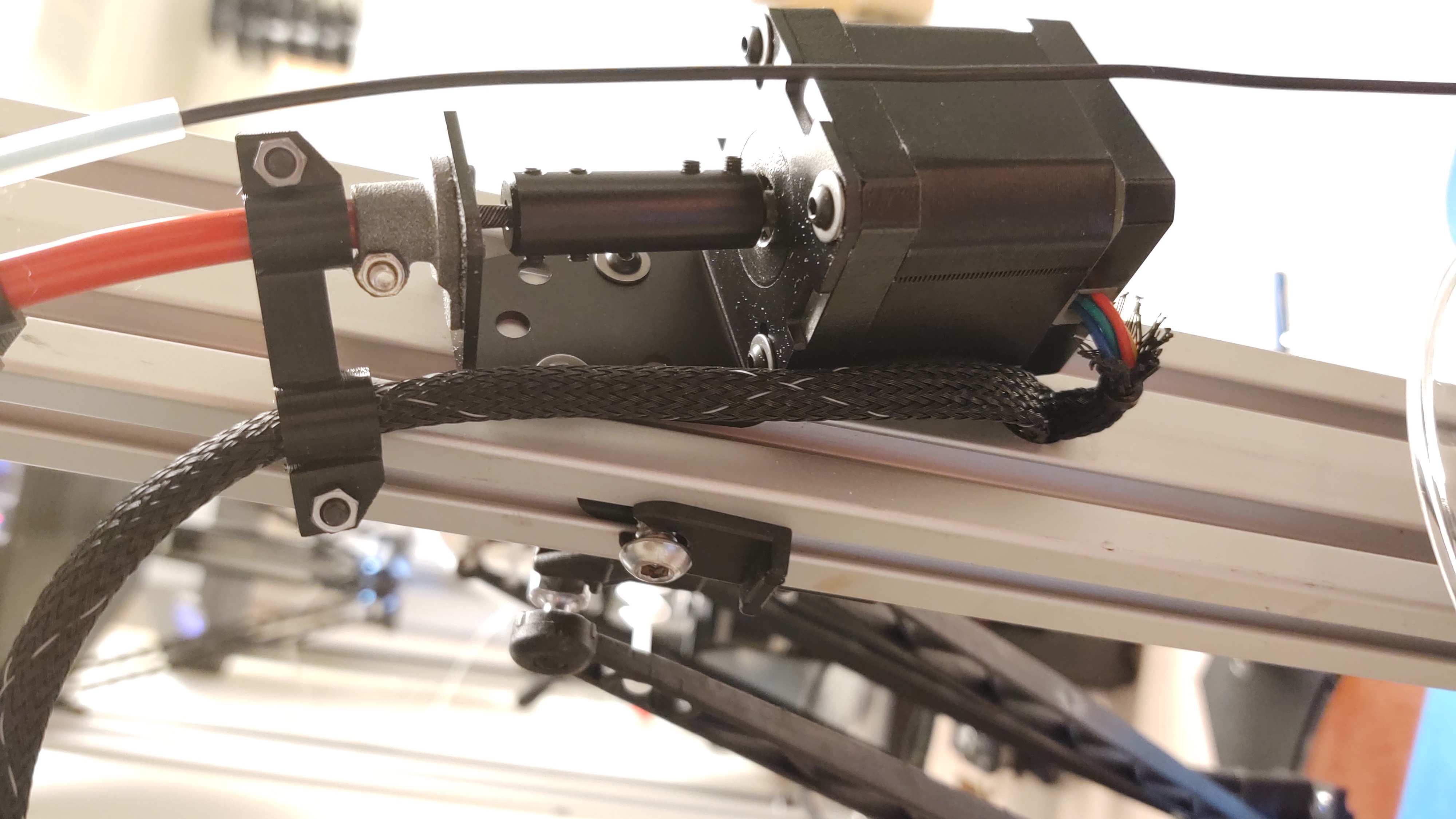

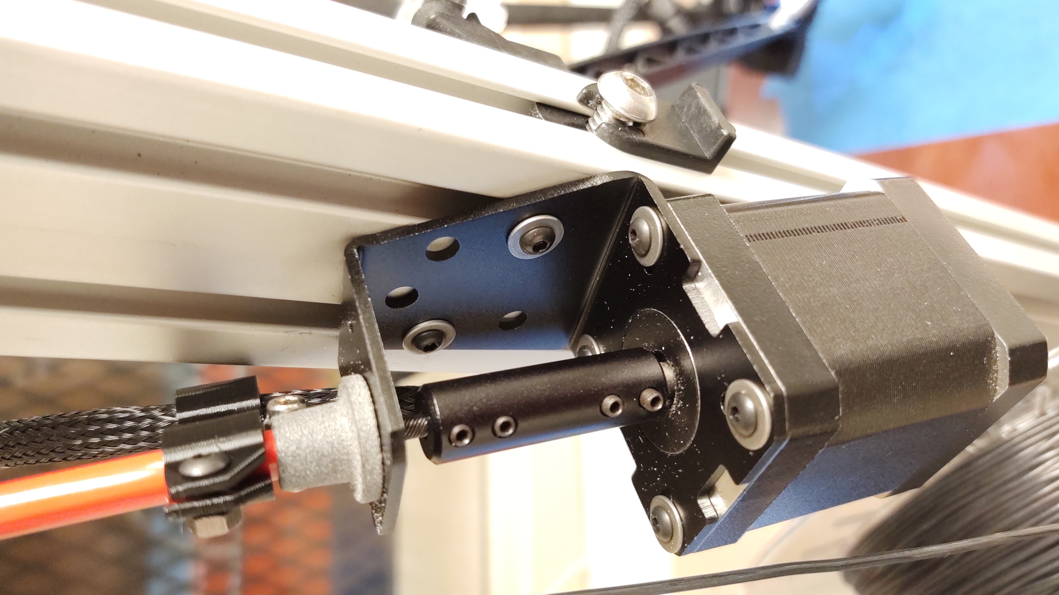

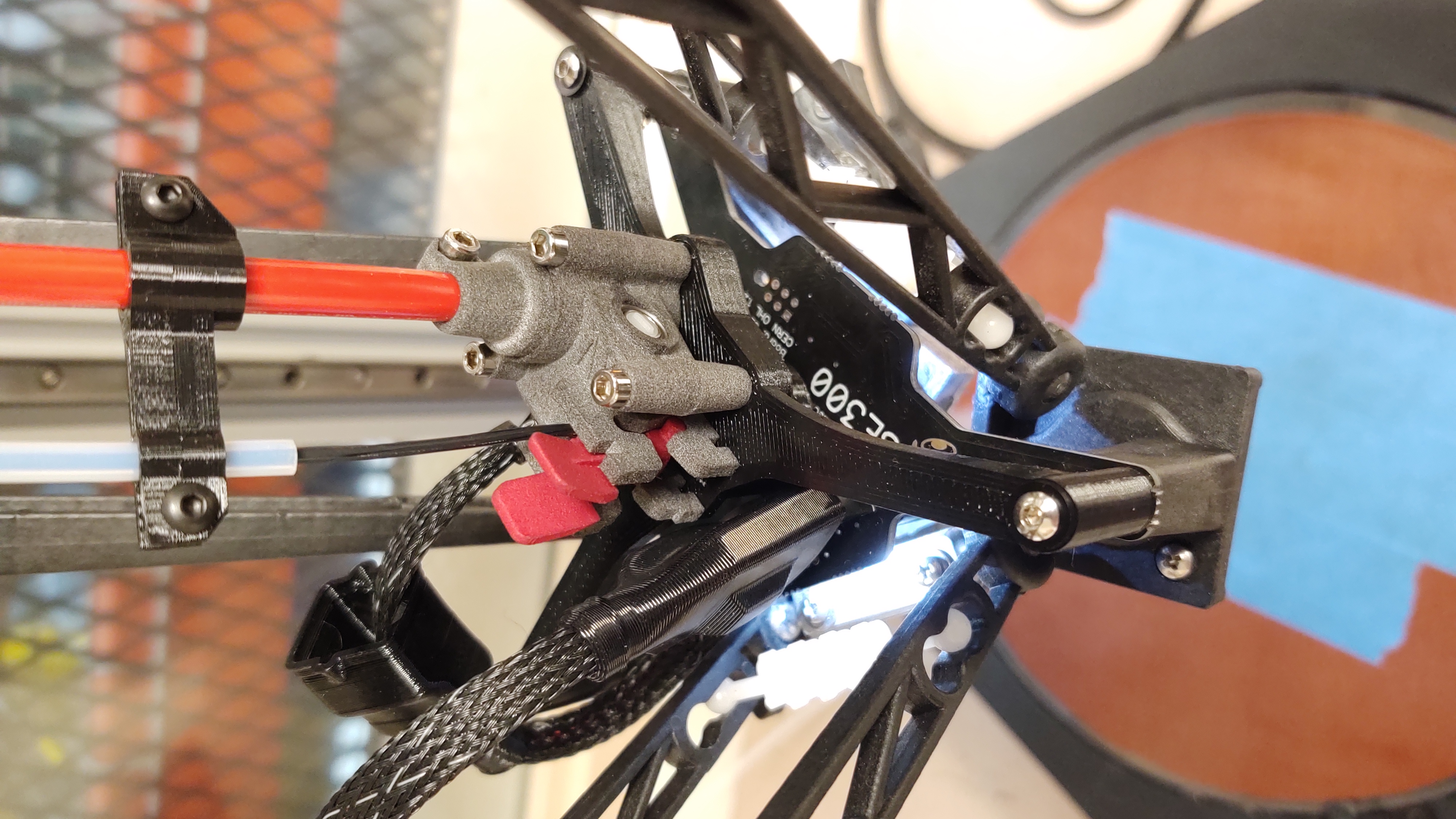

I'm working on getting a Zesty Nimble V2 installed on an Artemis. I've worked with @Zesty_Lykle over the past week to get a mount designed for the V2, https://www.thingiverse.com/thing:4181101. Just about done printing it now. My question is how to attach the mount to the hot end. The #4 plastic screws used to attach the board seem to only come in a 3/4" length max. That is about 1" too short. How have other done it? Thanks.
Re: Zesty Nimble extruder technical thread
I ended up using M3x35 machine screws to mount it. A bit tight, but that is probably good with such fine threads. It works well.
I used 35" of PTFE tubing attached to the drive cable to get filament to the Nimble. It's attached to the drive cable with 2 Zesty Nimble Bowden Holder, https://www.thingiverse.com/thing:3384514, and Zesty Nimble Drive Cable Reverse Bowden / Filament Guide Clips, https://www.thingiverse.com/thing:3496144, 6 small, 2 +5mm, and 2 +10mm. I designed and used a Zesty Nimble Harness Clamp, https://www.thingiverse.com/thing:4196972, to hold the hotend harness up away form the filament spool.
