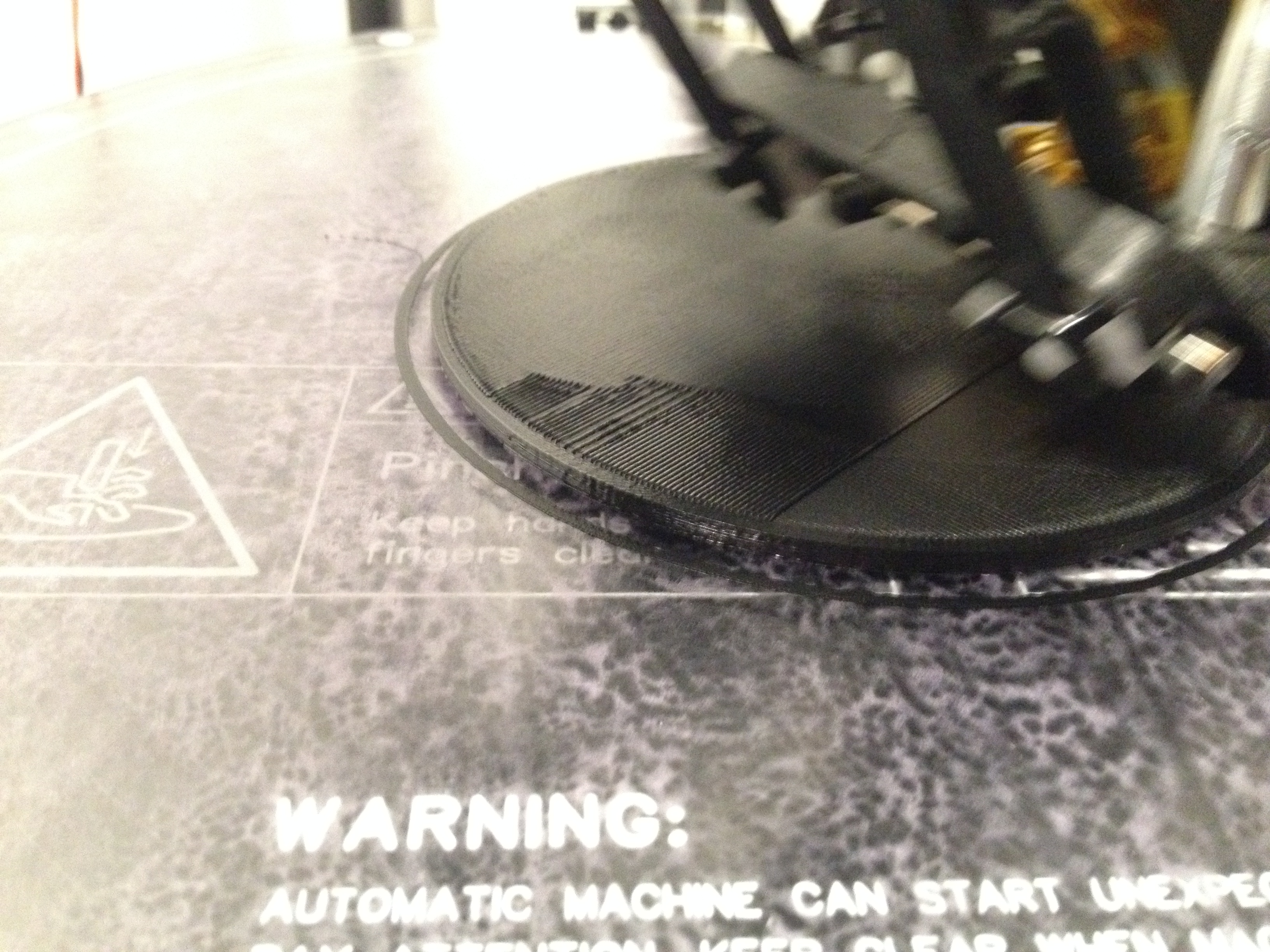

Michael, can I ask your opinion on these weird infill problems I'm having?
I think it's first layer related, but I'm not sure. It's in the same spot, throughout the entire print, but only on the layers that travel parallel to the lines in the picture. On the layers that are perpendicular, it's almost flawless.

bot wrote:Michael, can I ask your opinion on these weird infill problems I'm having?
+1 I'm having the exact same issue. http://forum.seemecnc.com/viewtopic.php?f=37&t=7839 I'd love to hear from someone that has solved this problem.

It most likely has to do with either the delta arms slightly binding when near that position, improper belt tension (or worn belts) allowing for slight positional inaccuracy... Just my guess anyway

bot, given that you are seeing this "rift" on a higher layer and that it shows in the same spot on those layers, I agree with texsc98 that it is a mechanical issue of some sort. I have seen similar artifacts, I just posted about something similar in my build thread a few weeks ago.
First question: which cartesian axis of motion is this layer being printed? Is it along X, along Y or on a diagonal.
An educated guess is that there is a small piece of debris on the tower track or on a wheel. Clean everything with a soft lint free rag and Windex. If that doesn't do it, I'd suggest doing an experiment - reposting the part to place that rift in the center of it and reslice and print. You should see it now in the new location. If so, we are definitely looking at a mechanical issue of some sort. It could be belt tension or something on the belt as it runs over the pulley teeth.
Otherwise, those layers look great!

I totally agree, it might be mechanical in nature. My belts do rub a little on the extrusions, so maybe they got effed up. Good idea on cleaning the extrusions and everything.
This happens on the diagonal. The problem area occurs directly in front of and to the "right" of the X tower. It almost corresponds with a squeaky noise coming from my Z tower, so I'm thinking a belt issue, dirty extrusions/wheels, or a loose stepper pulley.
Thanks for the thoughts everyone. I'll check into some of those things more.
