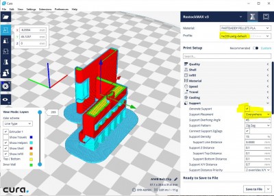

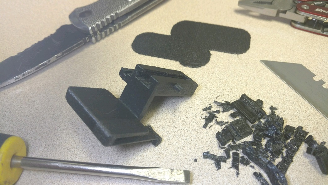

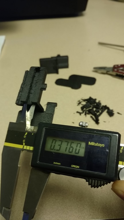

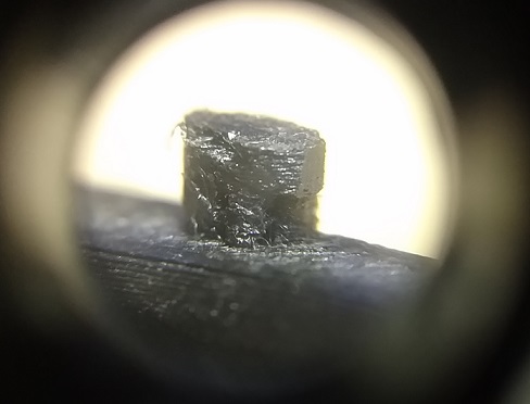

Ok, don't criticize me too much on part clean up, I was rushed some. I'd skip "roof" setting under support in Cura for PETG, this part. It works really good on PLA parts. Atomic Filament.

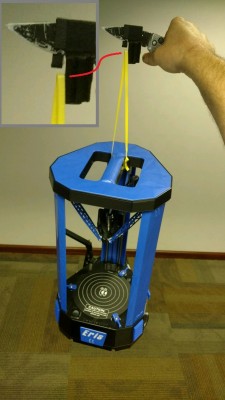

Here's an 8 pound (4kg) Eris hanging off the small nub feature of the AIWB part. Atomic carbon fiber black PETG. I think this is fairly impressive. The small nub feature close up. All the weight is hanging on this feature. Could be much better with smaller nozzle.

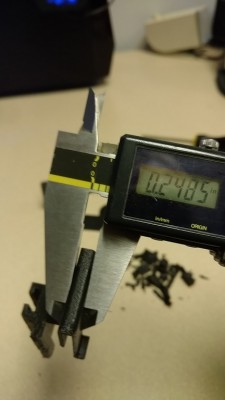

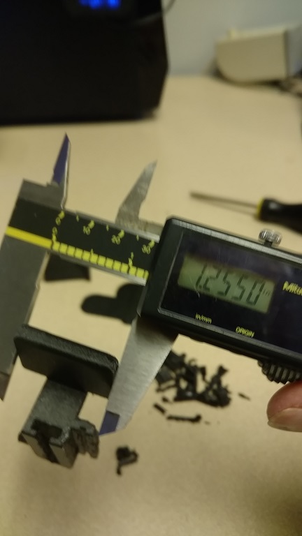

Cura screen shot The printed part on raft: Cleanup and a few dimensions:

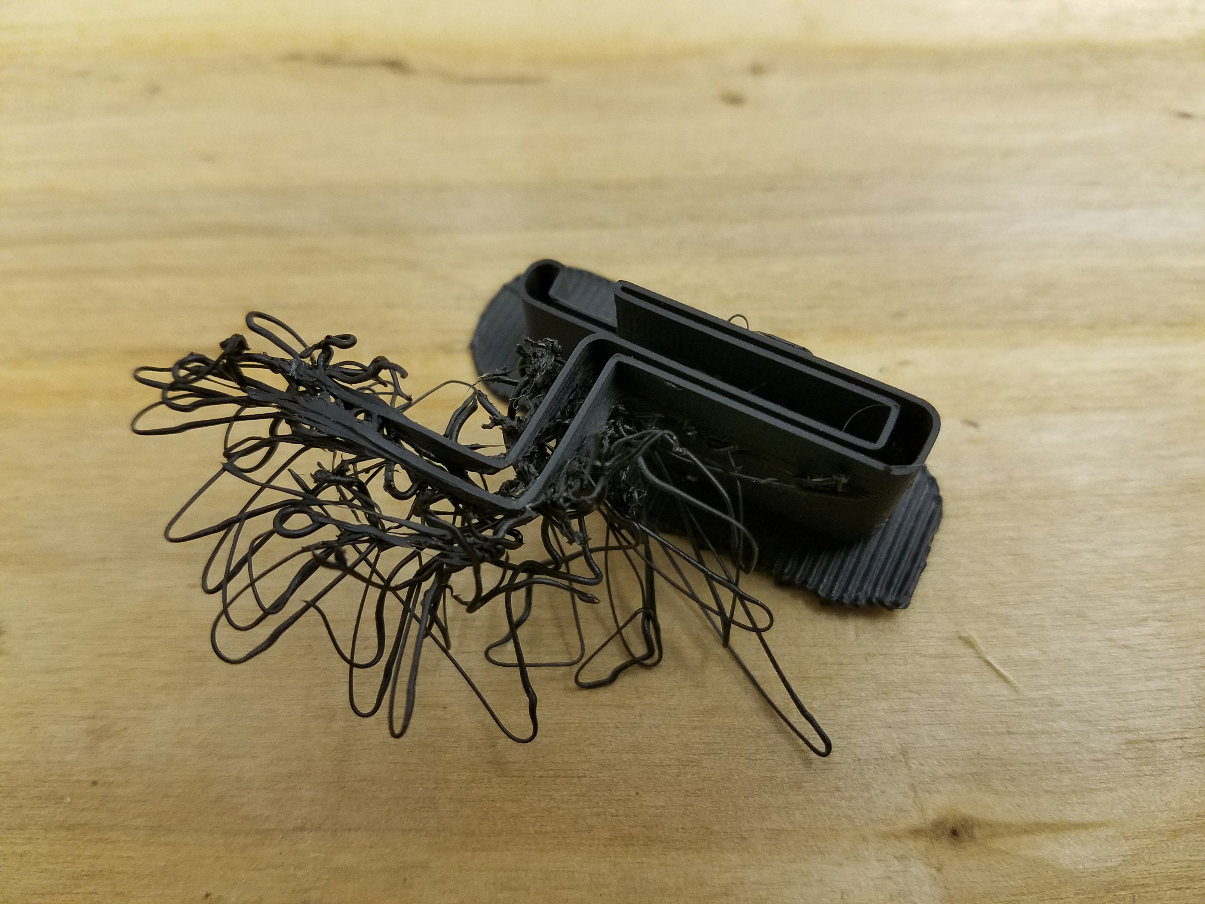

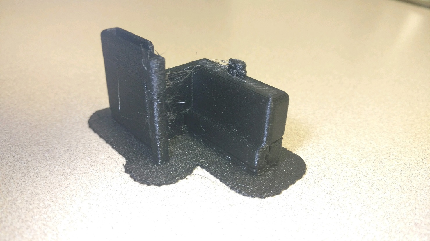

Hello PartDaddy - Sorry for the long delay. OBE (overcome by events) here last couple of weeks. I'm sure you know how it goes.
I finally got around to attempting a print of the part we've been discussing. I included a photo of the print I stopped midstream when I realized it wasn't going to pan out. Also included the .ini settings file for the print. Not only did it fail to print the support structure, but it also failed to make the print solid, although both we specified I thought.
Thanks for any insights and corrections.

I used straight up "SeeMeCNC" Cura profiles downloaded form our github.com/seemecnc for HE280. My guys perfected, with the exception of checking raft and support everywhere. See the Cura photo above, I highlighted these changes. Then your screen slice should look like mine.
Of course, different hotends, etc., will have different results. I'm just printing with our stock machine! No mods needed to hit the dimensions and quality your looking for (with the exception of our ball joint arms and molded cheapskates for a v2).
