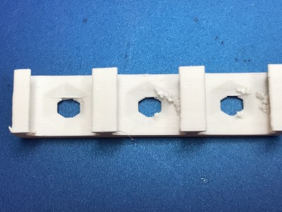

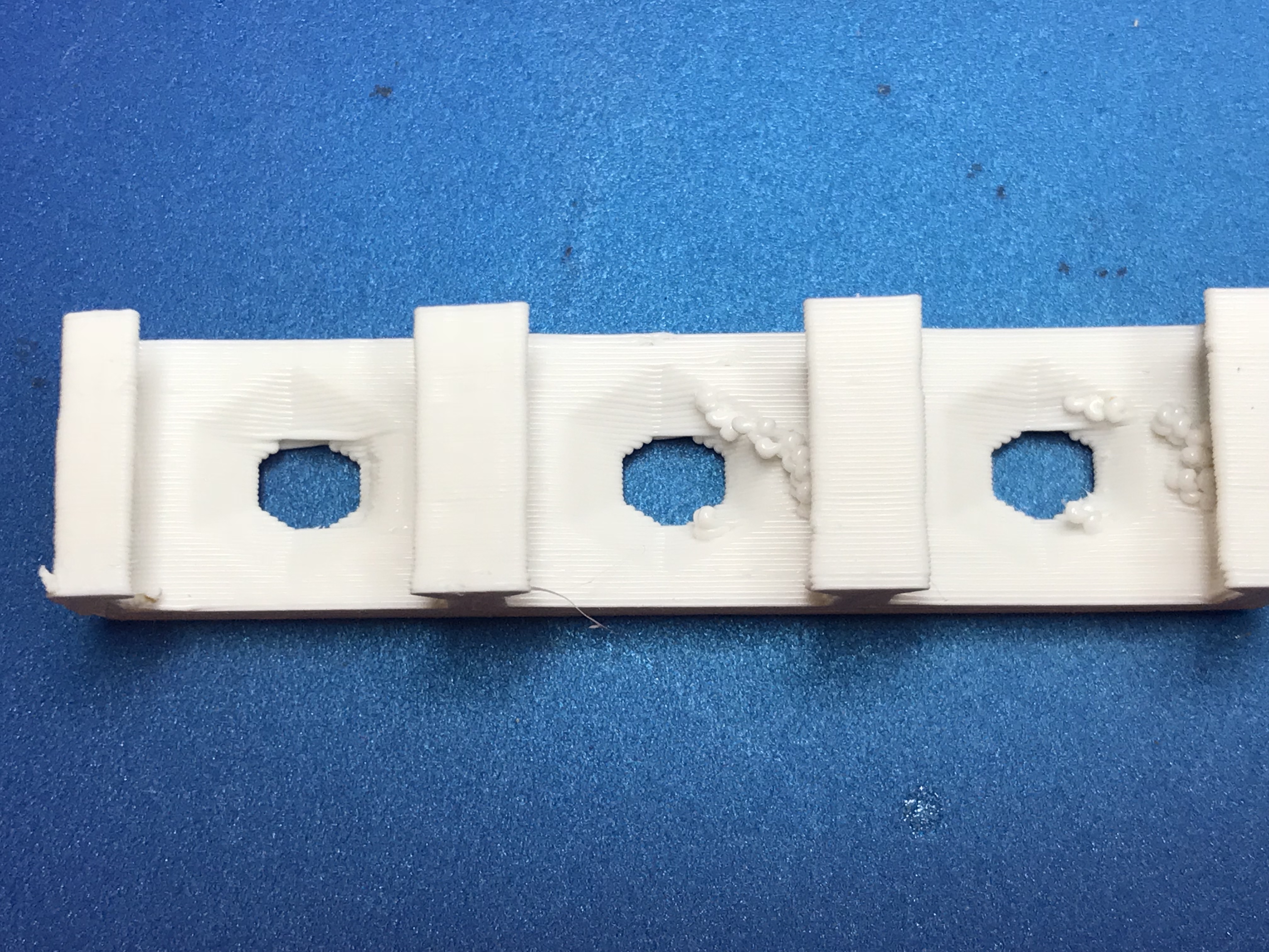

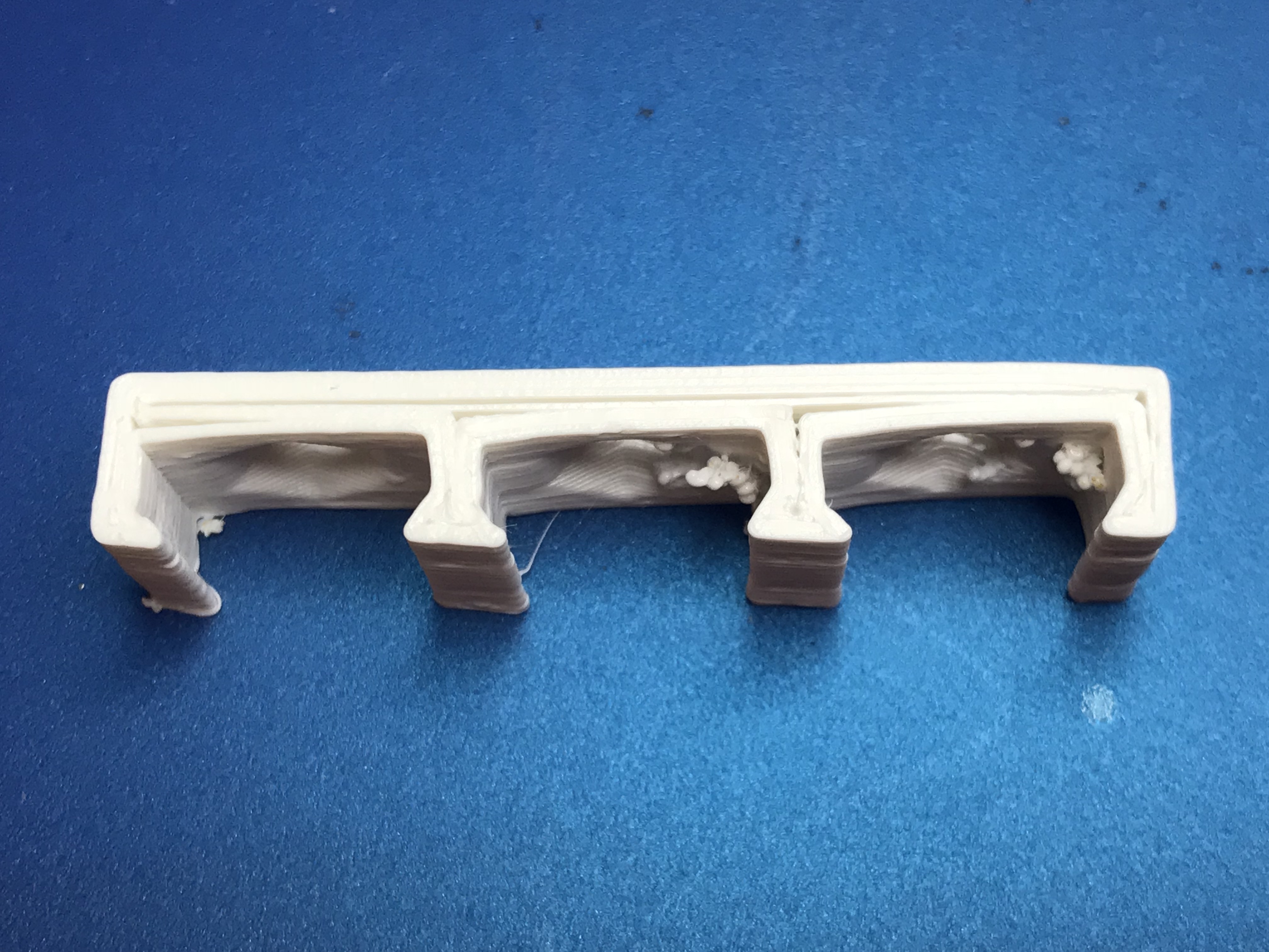

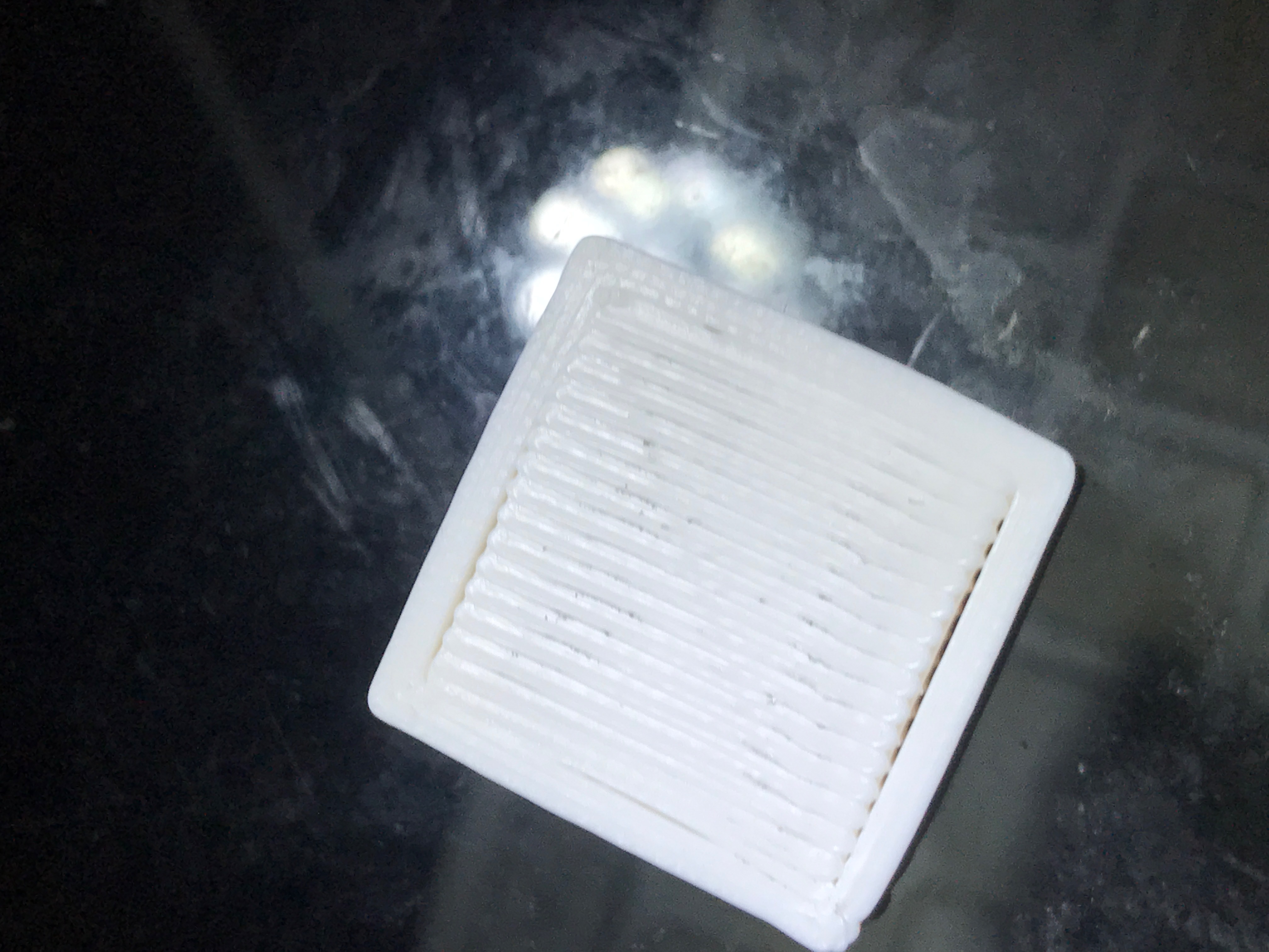

I've been having some issues with infill not connecting to perimeters, particularly on the top layer of prints. I'm wondering if I should fiddle with my belt tension or if something else is indicated. Here's a picture of the 20x20x10 test print I did after putting on a new HE280:
I'm running an older Orion (from early 2014 - I think v2?) with a RAMBo v1.1b. Yesterday I put on the new carriages, ball joint arms, EZR Struder, and HE280 (pre-assembled) with only a few hiccups and everything seems to be mostly in order. I ran through all the steps in the HE280 install guide (and the how-tos for the other parts) up to the advanced calibration. It's 3AM and I need a break, LOL.
Before the upgrades, I was occasionally having this same perimeter issue, but it seems to be more pronounced now. Also, the sides of the print look somewhat uneven and more rounded/bowed out than usual.
Any ideas as to what could be causing this? I set the belts on the replacement carriages by hand, so while I did take care to pull out the slack I didn't like yank on them with pliers or otherwise set them especially tight. One carriage seemed to want to move more easily than the others and that bugged the crap out of me but I wasn't really able to get it to tighten up so I had to give it up after a few tries.
Before the upgrades, like I said, I did have some similar problems with gaps between my perimeters and infill, especially on the top layers. I also had a pernicious bed leveling issue that I never managed to resolve adjusting the endstop screws. Sometimes the first several layers of a print (up to 2 or 3 mm I'd say) will be smooshed outward a little, like I'm pushing too much filament maybe?
Any help is much appreciated - thanks.

I think it may be a combination of calibration issues, a new hotend (And geometry, including of the nozzle), and a not particularly well set Infill Overlap (May be named something different, but it should be there) in the slicer. Lucky for you, the last one is easily fixed, and that should help a lot with the results.

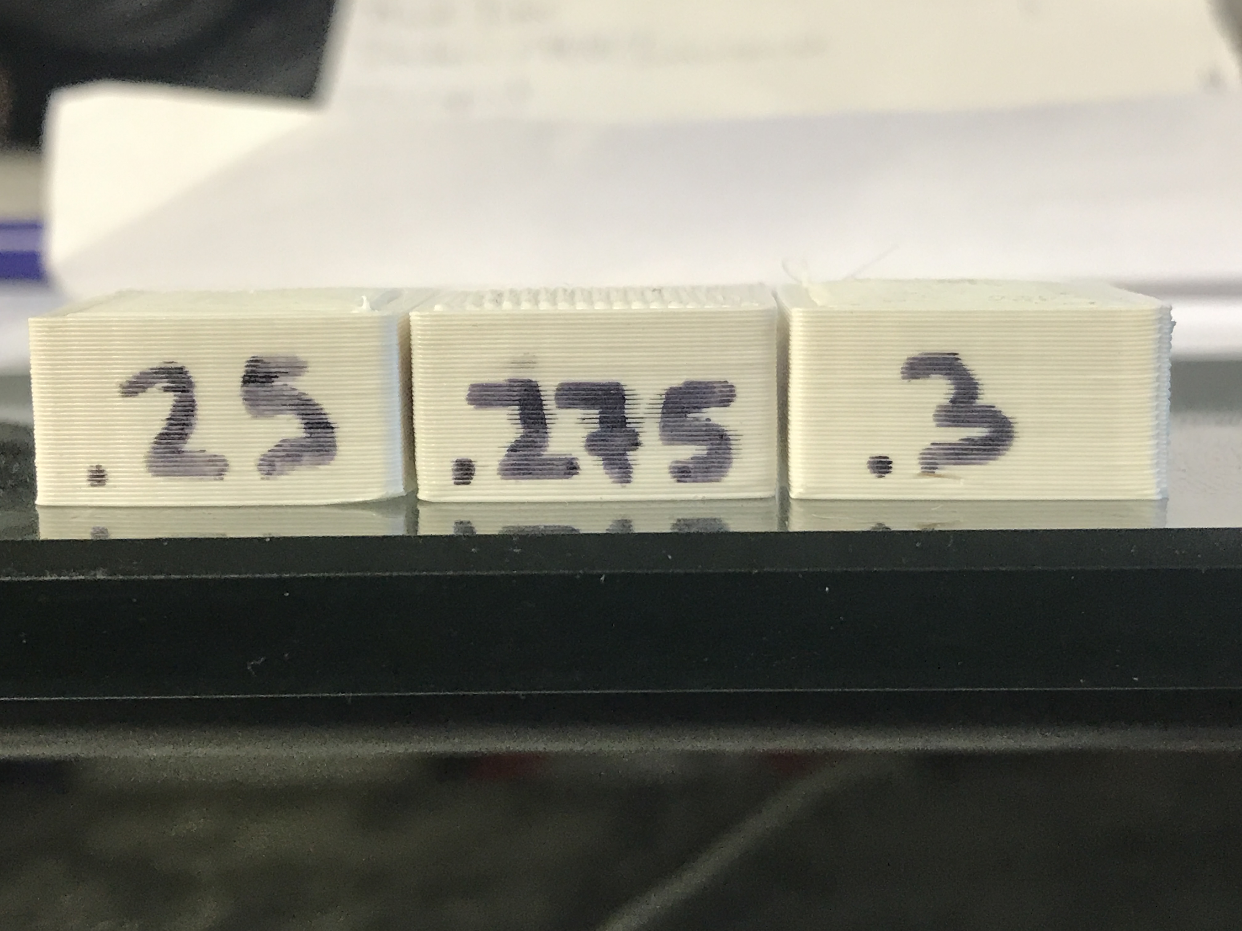

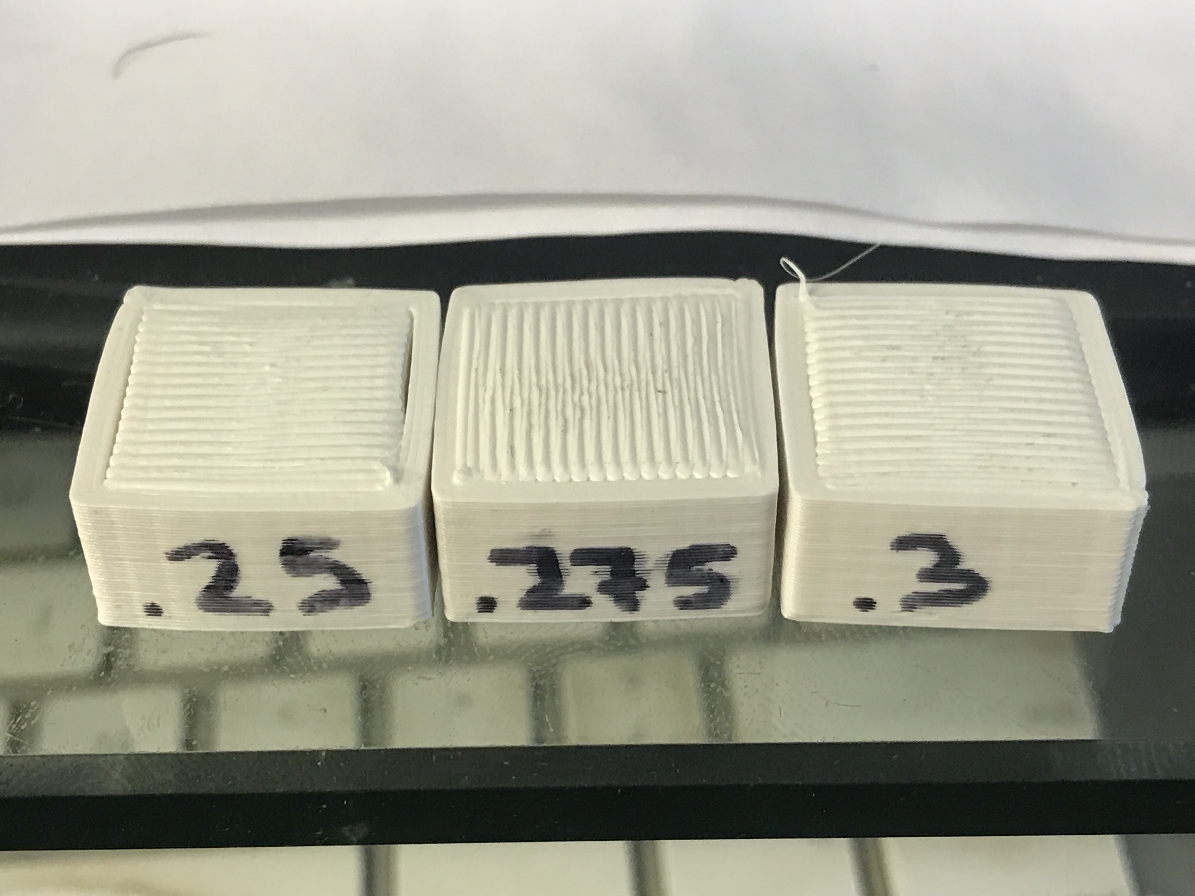

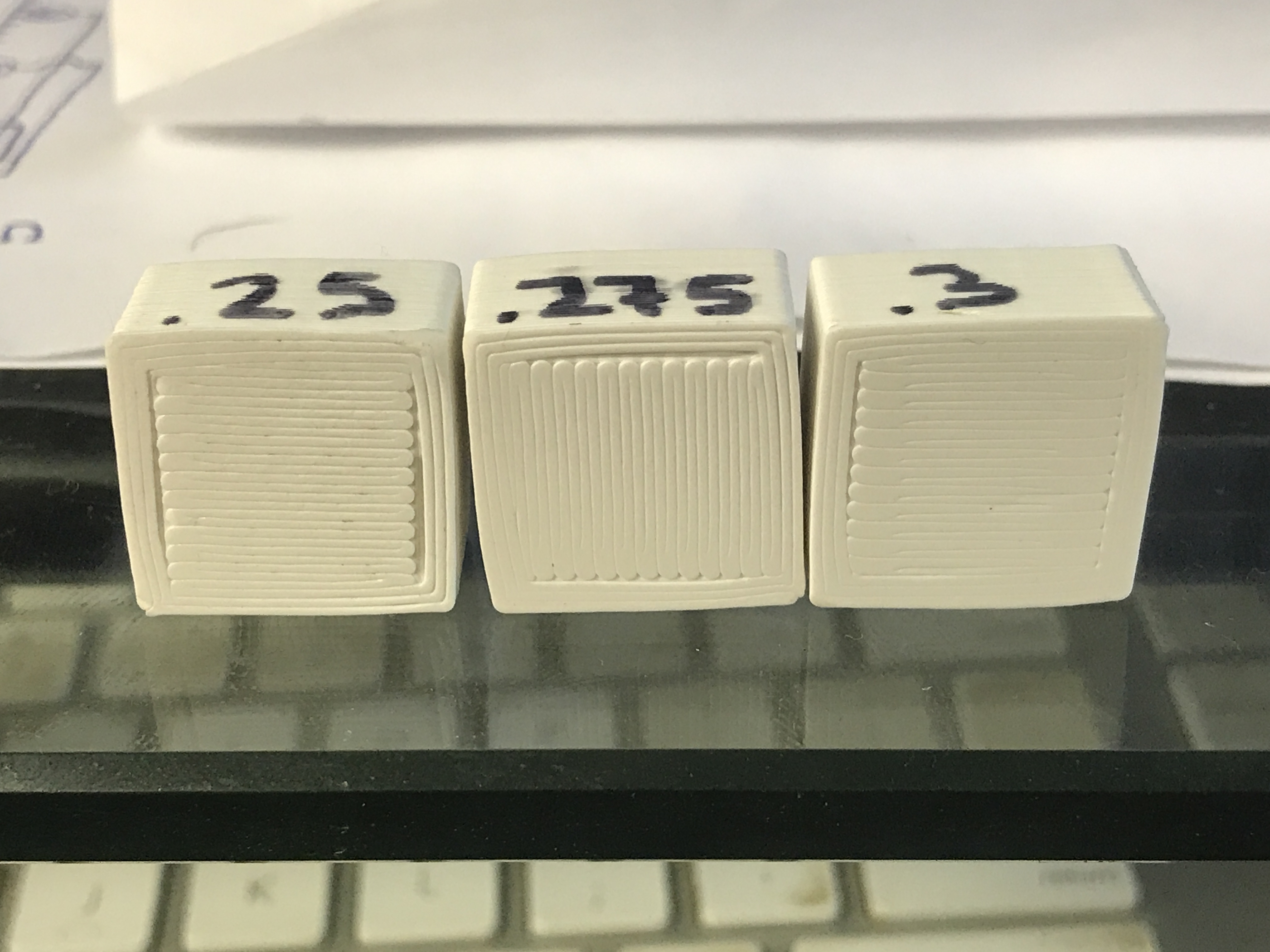

I played with the Infill Overlap and it did fill the gaps but did not solve the wobble in the printhead. While raising it filled the gaps, it also resulted in quite a bit of slop on the top layer, so I think I had the value more or less correct before. Here's a comparison - 0.25 was the original setting. Sorry about the white-foreground-on-white-background in that last shot.
While the higher settings did close the gap somewhat, both at 0.275 and 0.3 there was about 0.5mm of extra Z height bulging above the top layer perimeters. I haven't tuned this setting before so I don't know what I'm looking for, but my initial impression is that I'm causing more new error than I'm correcting.

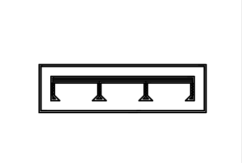

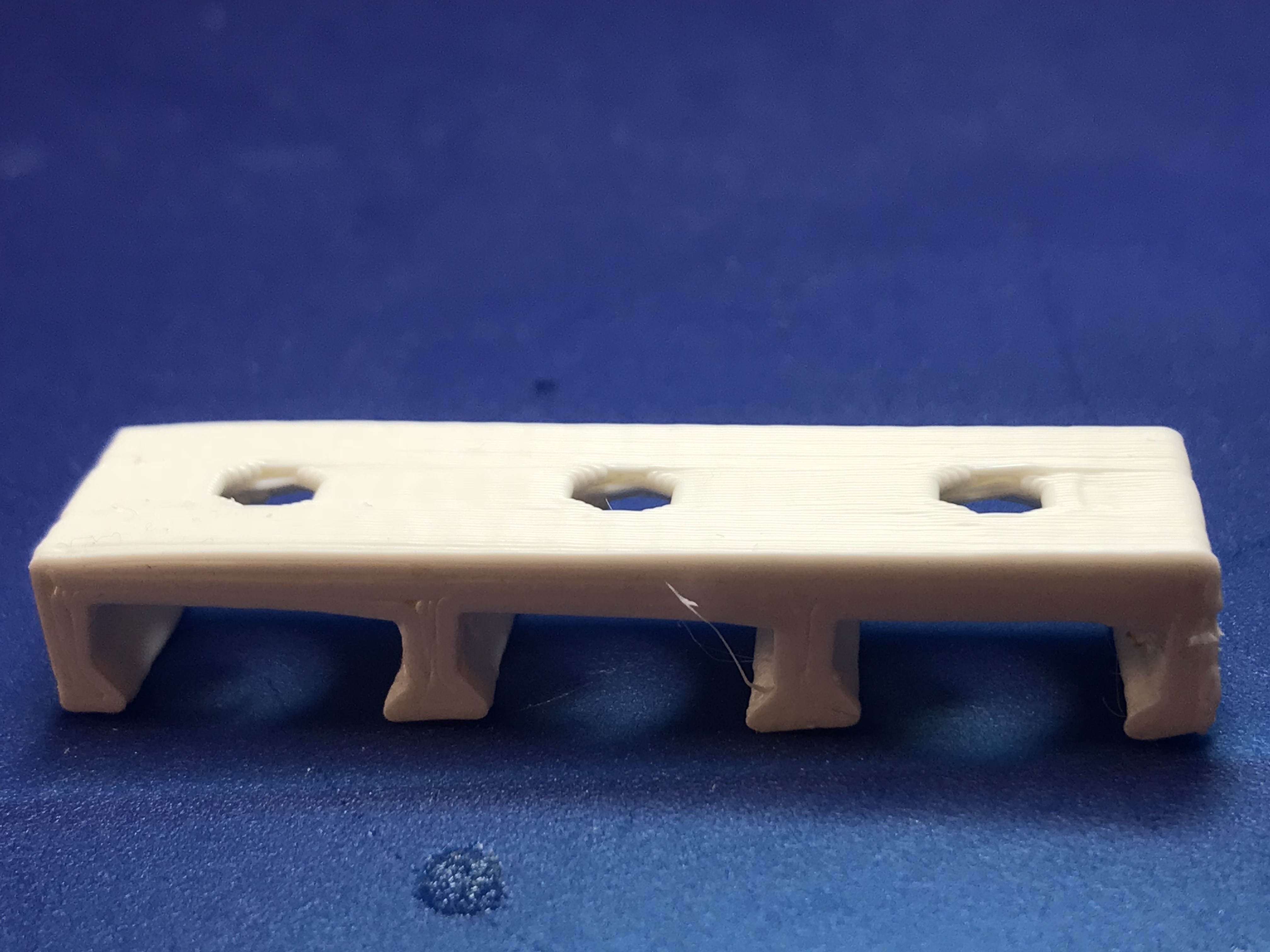

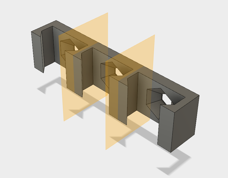

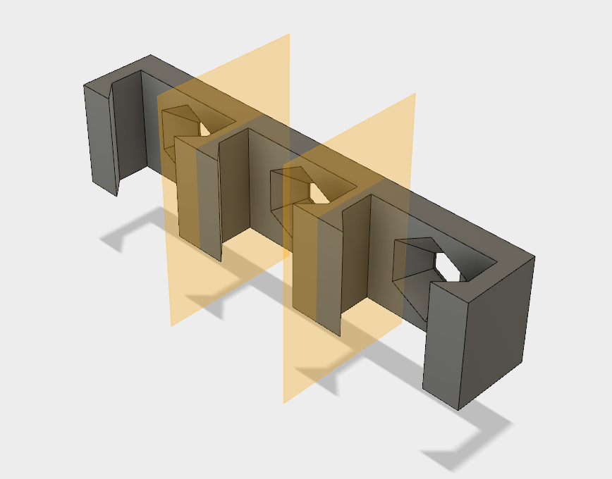

Hopefully it's easier to see what's going on with this part. Here's the part I'm printing, designed in Fusion 360:

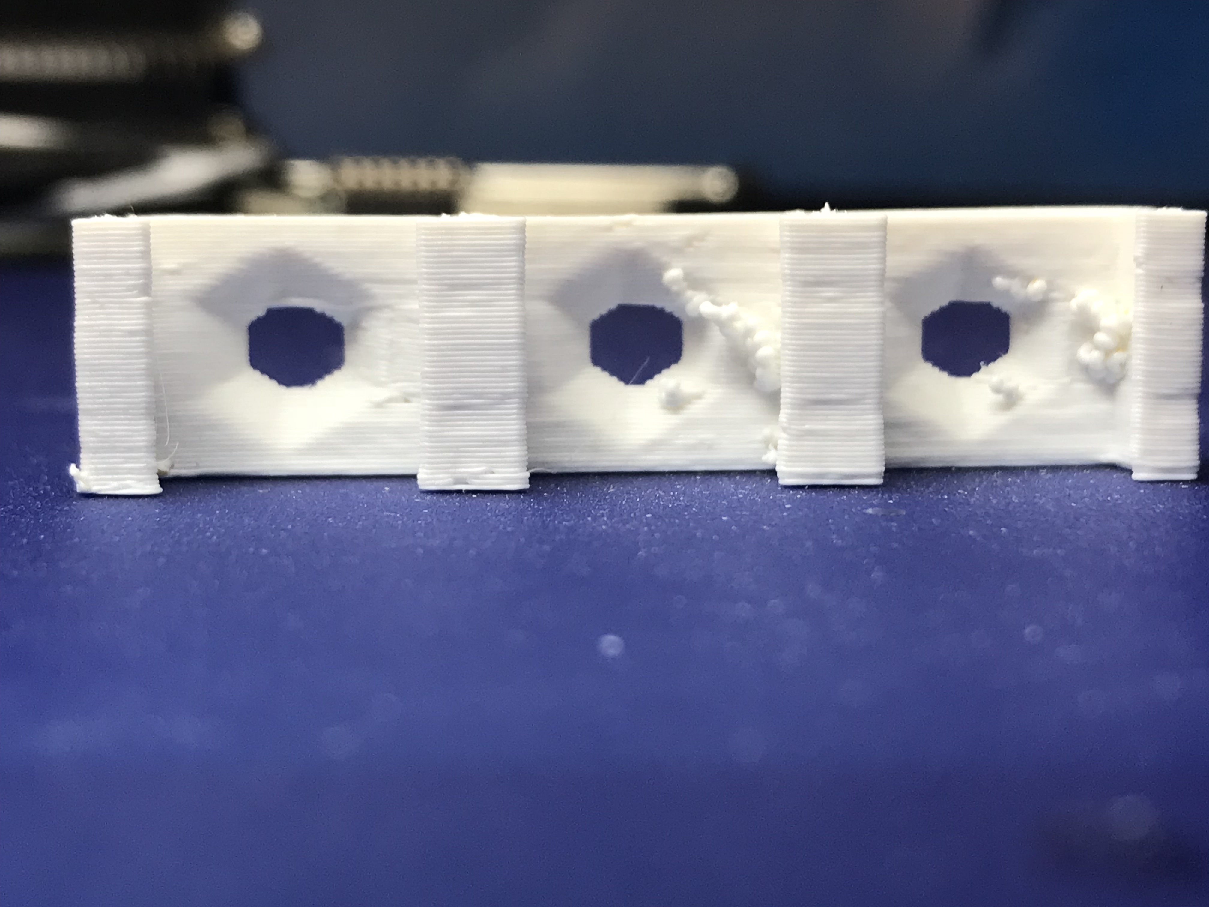

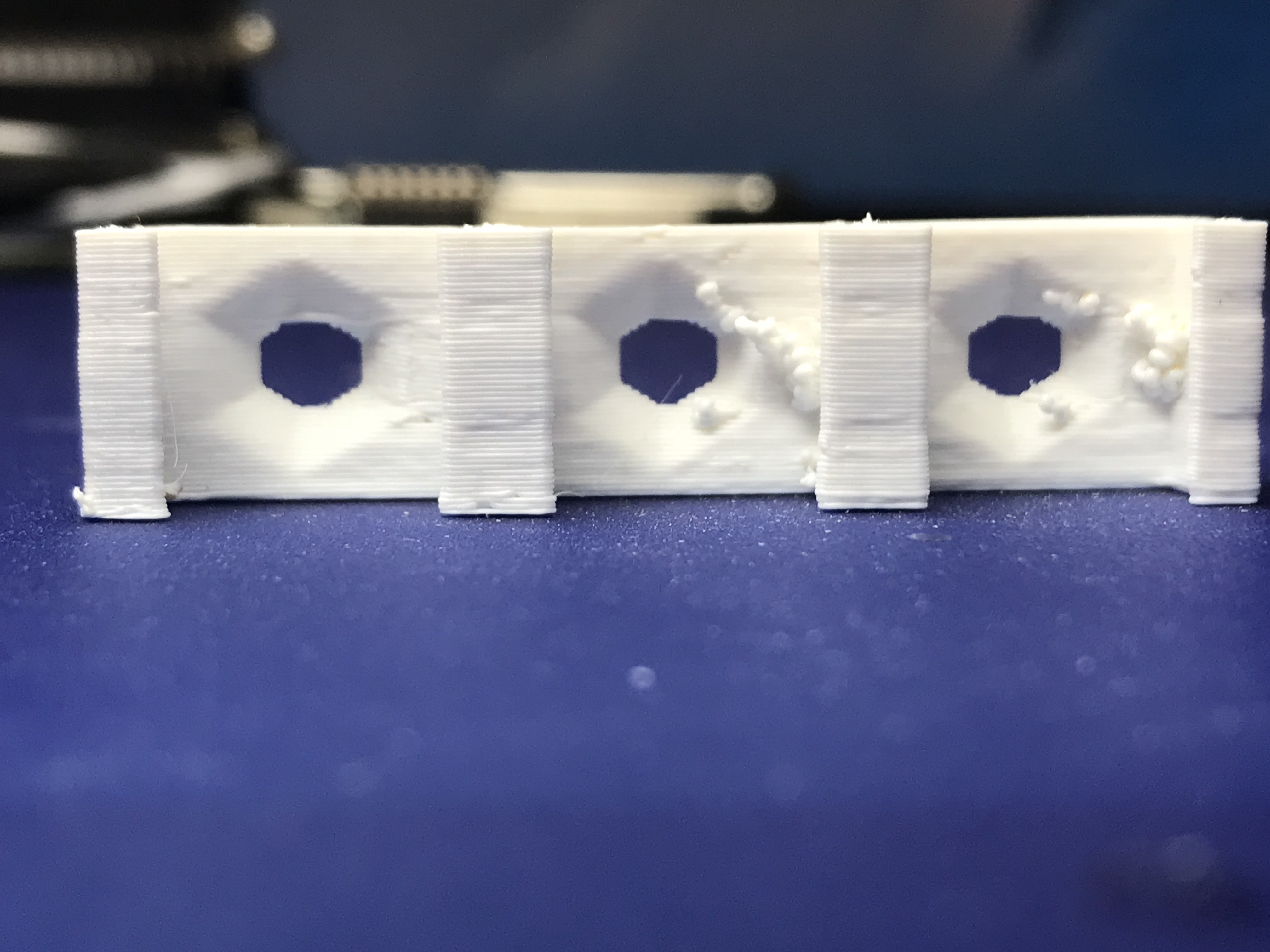

Here's how it comes out:
Here's what the cross-section should look like, based on the first layer in MatterControl:
Screen Shot 2017-10-29 at 18.27.29.png (8.44 KiB) Viewed 10806 times
And here's what the first few layers look like on the plate:

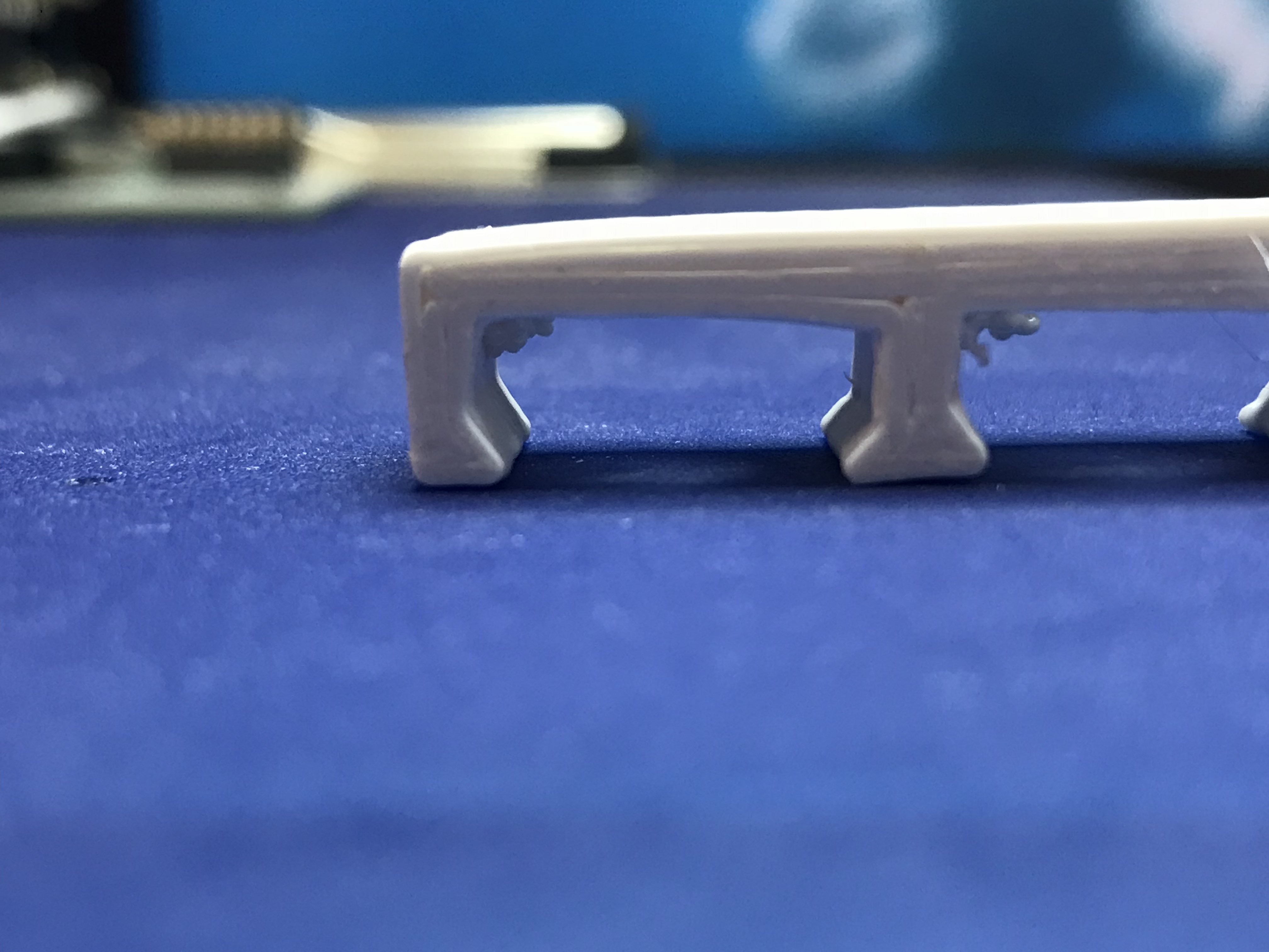

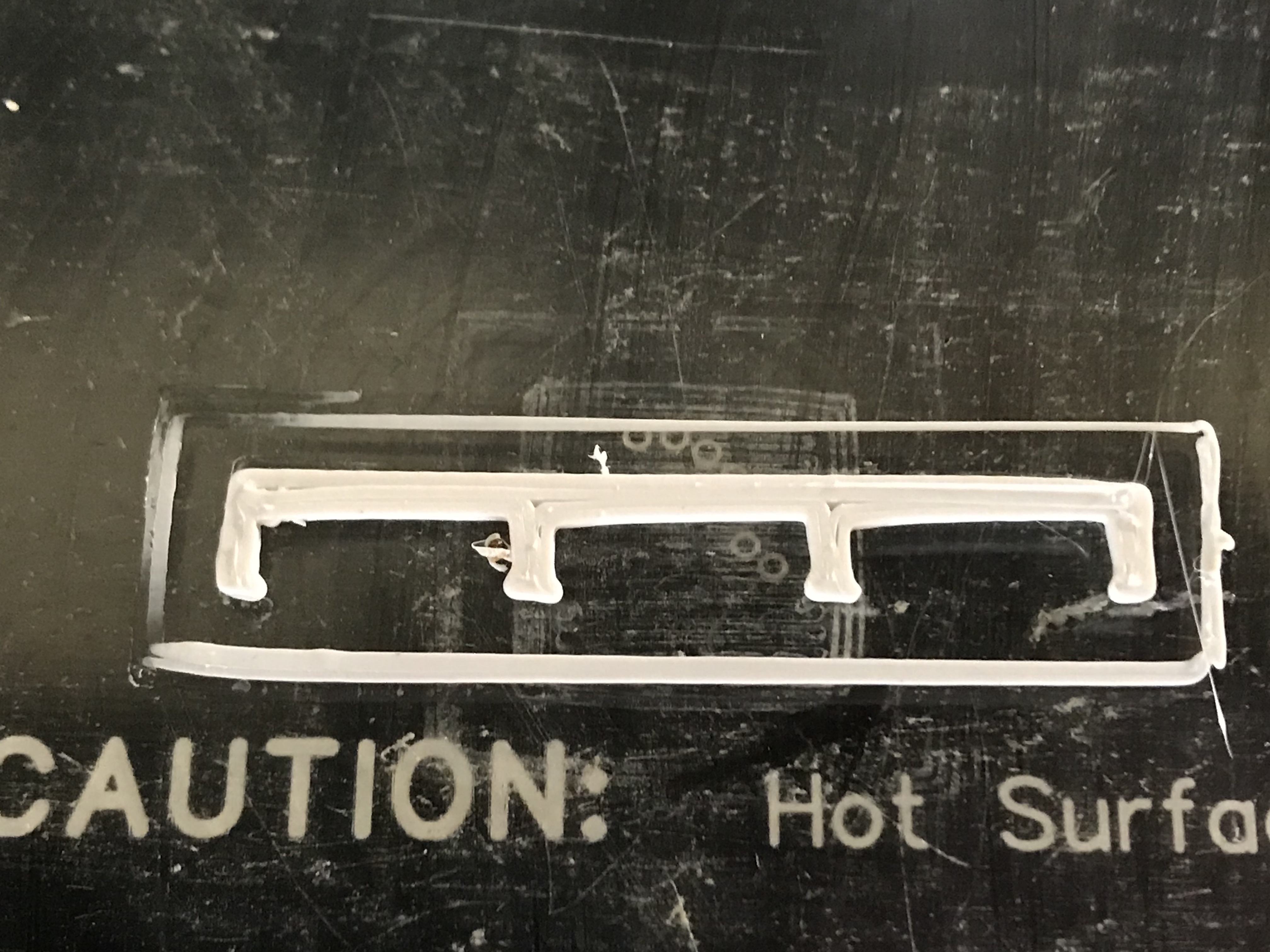

So, I had some minor dip towards the back tower before, skewed to the left, but it's wildly worse after the upgrade. The loops from priming would've come out more or less even in my previous configuration - I could print to about a 100mm diameter before it got this bad.
The real problem is the skewing. The test square from my previous posts had more than 1mm +/- error in the X and Y axes. And sharp angles come out with curvy irregularities. I'm pretty sure that's contributing to the beading and layer misalignments in these other pics:

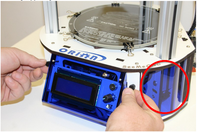

Yes Joe, behind the Acrylic cover, at the bottom of the 3 Tower,
And looking for this assembly, the pulley on the steppers at the three tower (bottom), The shaft is the "rod" that comes from the stepper, inspect the area.

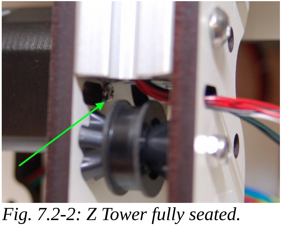

The towers is supposed to be square IF everything is seat correctly. You need to check first on the top and bottom, on the RostockMax there is a screw head to position the aluminum extrusion there should be something similar on your Orion.

The towers do appear to be fully seated at the bottom. It seems like this version of the Orion does not have screws on the top, though.
