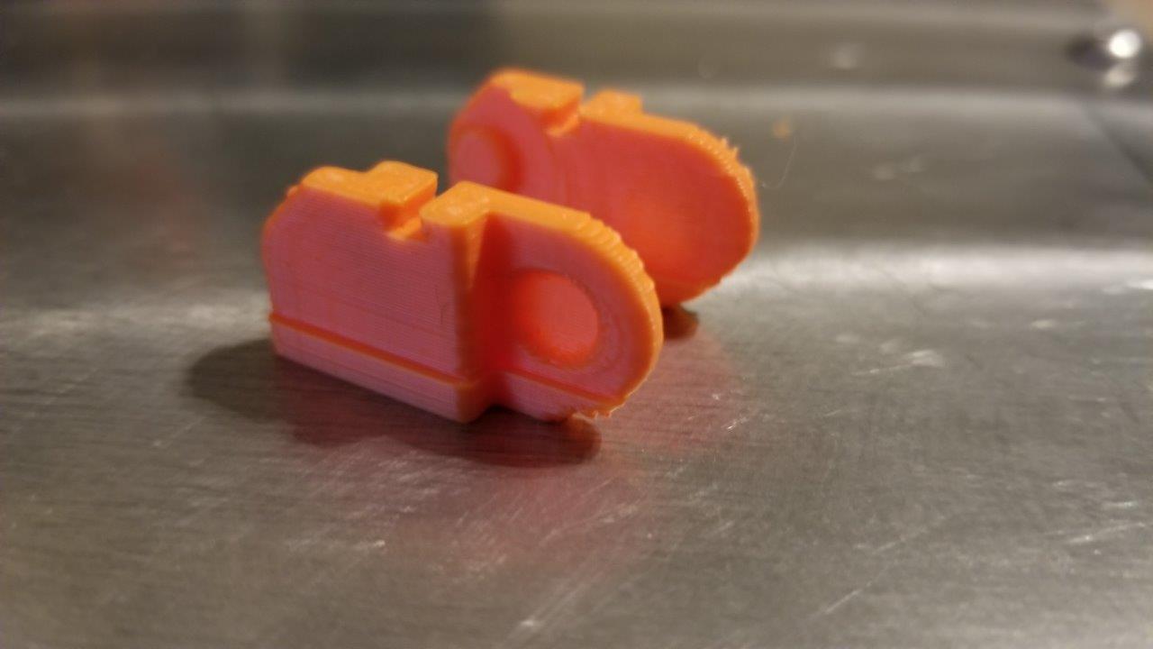

I got a layer shift for the first time. It occurred about 10 layers in. I thought it was something I did on the computer since I was printing from USB and I was messing with another printer via USB at the same time, but I printed from the SD card and it did the same thing on the same layer.
I printed the same thing the night before with no issues, except this time I tried to print 32 parts instead of 16. This put the printing farther out to the edges of the bed than I have printed so far. I believe the layer shift may be because I am printing more at the edges of the bed and maybe on that 11th layer it just goes a tiny bit farther out and has a mechanical issue, but I cannot say for sure.

I may have figured this out since I had time to think about it and look at the prints that I left on the bed. It seem there is a part of the print that starts to curl up as it builds up the overhang. I think when I print 16 , they stay hot enough that the nozzle just pushes them down on the next pass. I think when I went to 32 parts that they may have hardened enough to get the nozzle stuck until it could work its way through causing the shift.
Anwyay. I need to check the belt tension and stuff anyway since I never did. I will double check that and then either go back to printing 16 or see if I can somehow stop the ABS from curling on the small feature overhang.

Can you share a picture or two? If you don't have a rolling resistance or mechanical smoking gun, my guess is that you're overextruding, and the print head is hitting the previous layer hard enough to knock it out of whack.

I printed a batch of these in a lot of 16 and they came out great. The next round I wanted to make a larger batch and that is when this layer shift started. 2 batches of 32 both layer shifted about the same amount on the same layer. Then I redid a batch of 16 like the good batch shown here and it layer shifted in the same place also.
Pictures of a layer shifted part attached. This last time I even added support under the part that was curling a little which seemed to keep it flatter. It still layer shifted.

I printed one part and it came out nice. So, I figure I would setup an 8 part print. It layer shifted again. I am not sure what to do now except tear the printer apart and try to find something wrong.

I tried to print some more of these parts and I got the curling again and sure enough layers shifting. I did some tweaks to my settings to run the fans at certain times during the print (yeah ABS). This seems to have helped with the curling, and there are no shifting layers when the curls are not there.
I did find out that that this bed (onyx Rev 8) cannot keep up on its temp while running the fans when trying to maintain heat for ABS. At some points with the fans only at 50% on the lower layers, it can only hold 80 degrees or a little less. The first time I set it to 95 for the whole print and the print stopped and shut off the extruder and the the heaters at some point. There seems to be a check in the firmware and if the bed is too far off, I guess it thinks it is not working and shuts down.
Anyway, I am at layer 26 on a batch of 16 with no layer shift now that those curls aren't in the way of the nozzle.
