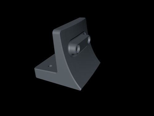

This is what the model looks like:

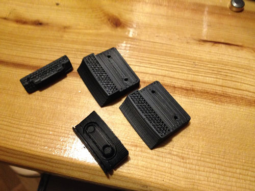

Over the past week I have, without hiccups, printed all the other little parts successfully. But this one always gets stuck. I have 5 misprints like this:

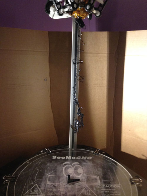

The print seems to lose a layer (it seems always at the same layer) and I end up with this:

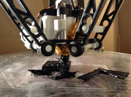

The print gets "weird" and then the filament doesn't have anything to attach to and it starts attaching itself to the nozzle.
I am not sure where to continue trouble shooting.

Could you post your .stl file please? And any idea as to which layer you are having trouble on?

Attached is the STL file.
