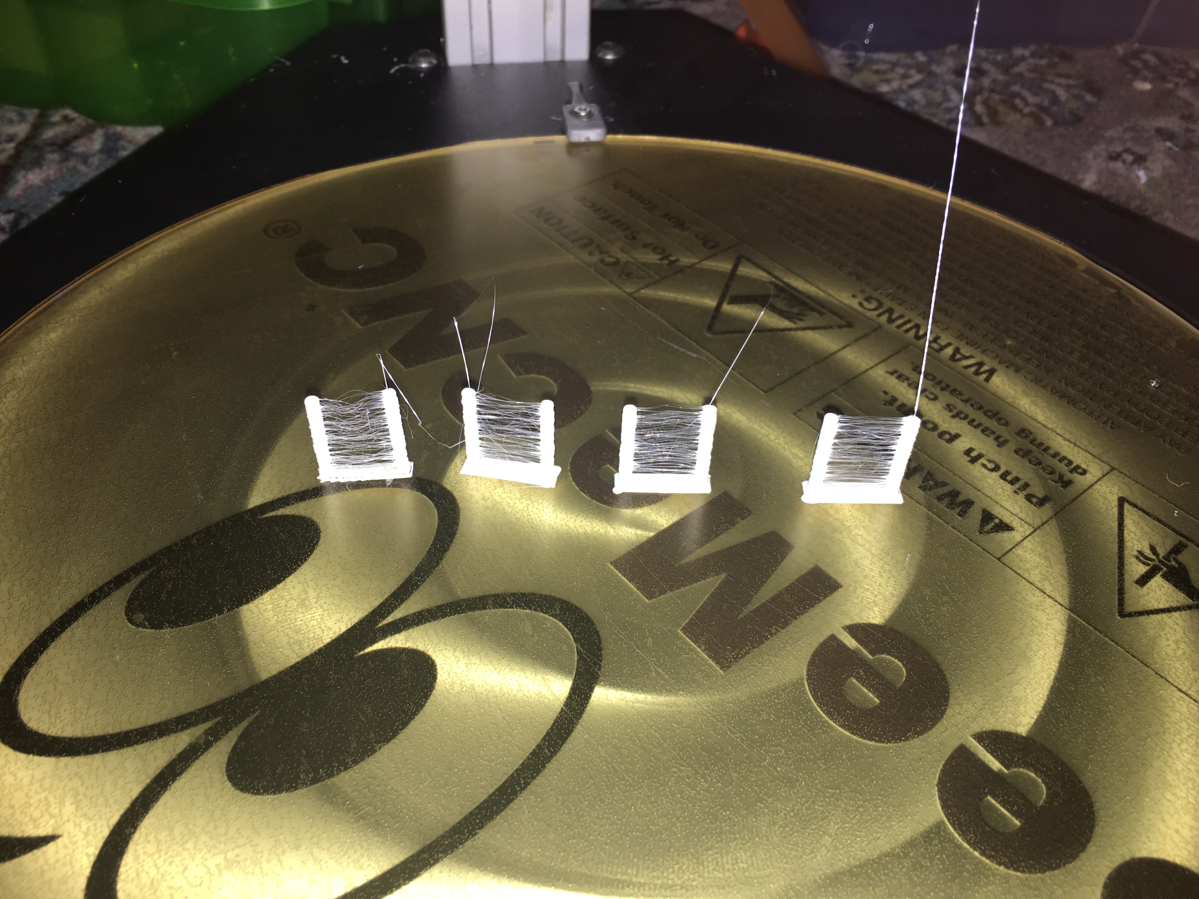

Here’s a comparison pic of different settings, left to right:
210, 6mm retraction 50mm/s
210-200, bottom to top gradient
190
210, 3.2mm 45mm/s
They all look the same to me.
I can see the extruder nob retract, but it’s almost as if it isn’t from all the strings—includingbto one on top at the end.
I’ve tried repitier and marlin and reprap gcode flavors.
These are currently reprap and using the newest stable firmware.
Noticed that after the print finishes, the move speed is stuck at some very low value. It won’t change till I start a new print and the nozzle starts to actually print. This means the hiking post print and the first move down are really slow.

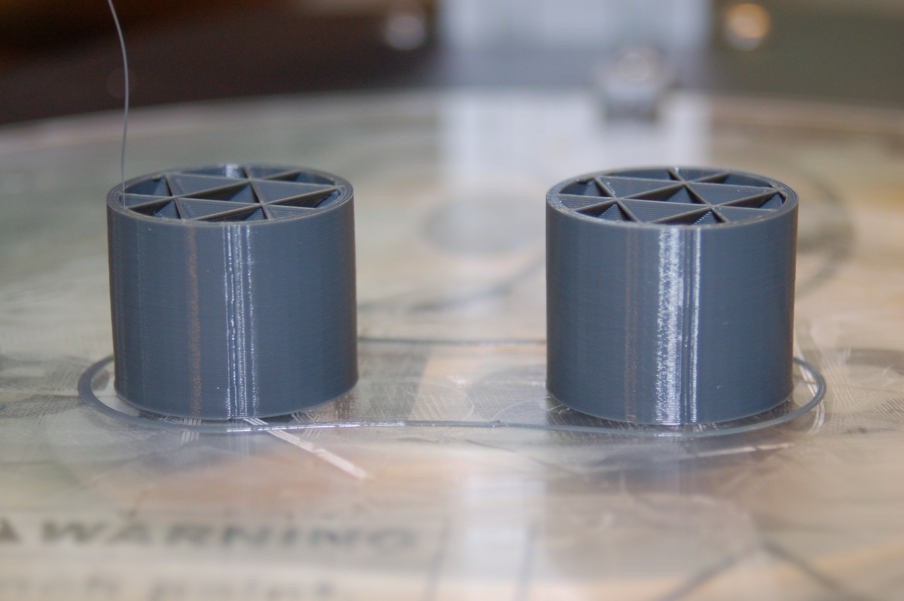

I'm printing this part right now. It's not so much a "stringing test" as it is a "let's see how much heat we can dump into two little plastic posts" test. :)
When I ran the test I was using Atomic Gunmetal Gray, which is my go-to material of late. That part prints /very/ quickly - there's no time for the previous layer to cool down and that's contributing quite a bit to the stringing issue. You can't print tiny things like that fast - there's just no time for the part layer to cool enough before the next layer is put down. I'm printing what I use for retract calibration - a pair of 25mm cylinders about 25-30mm apart. I'm printing this using the SE300 PLA Default profile from github @ 195C. When it's done, I'll take a photo of it and post the gcode here.
Can you attach the STL file if your test part? I'd like to try slicing it myself.

OK, I did a few mm of your code and it does string less, but still has a thin web between the two disks and a lot in the infill. You've got a point about the other model, it stays hotter than the larger disks.
I'll try the other one at half speed, I'd like to be able to print small items like that.

I'll re-slice mine as default as well, was using fine since that's what I expect to be using most of the time.
Same thing. I'm beginning to think I'm getting some kind of heat creep and retraction wont do anything because it's stretching inside the heat sink or heat break.
I just disconnected my effector and held it upside down. Extruded 10mm, it continued to squeeze out filament seconds after the nob on the eztruder stopped. Is this the bowden binding the filament inside or something. I've never had this problem with my V2, even before I switched to a e3dv6.

I hear ya, I was toying with the idea of shipping it back to be looked at :)
I tried your gcode again at a lower temp and it leaved thinner strings than the smaller model I used still--mind you I've never had to resort to a hair drier like other Artemis users are using, as seen in the FB group. I ended up scaling the string test I linked to to 200% X/Y to get a mid way print between yours and mine. I didn't like waiting so long for all the first layers and infill to see if stringing continued to be trouble.
I found the reason why my hot end was so mucked up even though it never blobbed. The strings often waff around if the layer fan is on, and get caught on the nozzle/heater block.
I got a 6" ptfe tube I had laying around and used that with the effector held in my hand. If I had 3 hands I would have recorded it having the same pressure problem. I even tried holding it straight up with the tube as straight as I could make it. I compared it to my e3dv6 on my v2 and prusa and those both stopped immediately but would ooze a little if I left it sit with no retraction. I've got an extra beatup e3dv6 as well, and I might try that after reducing the top down to the 10mm diameter.

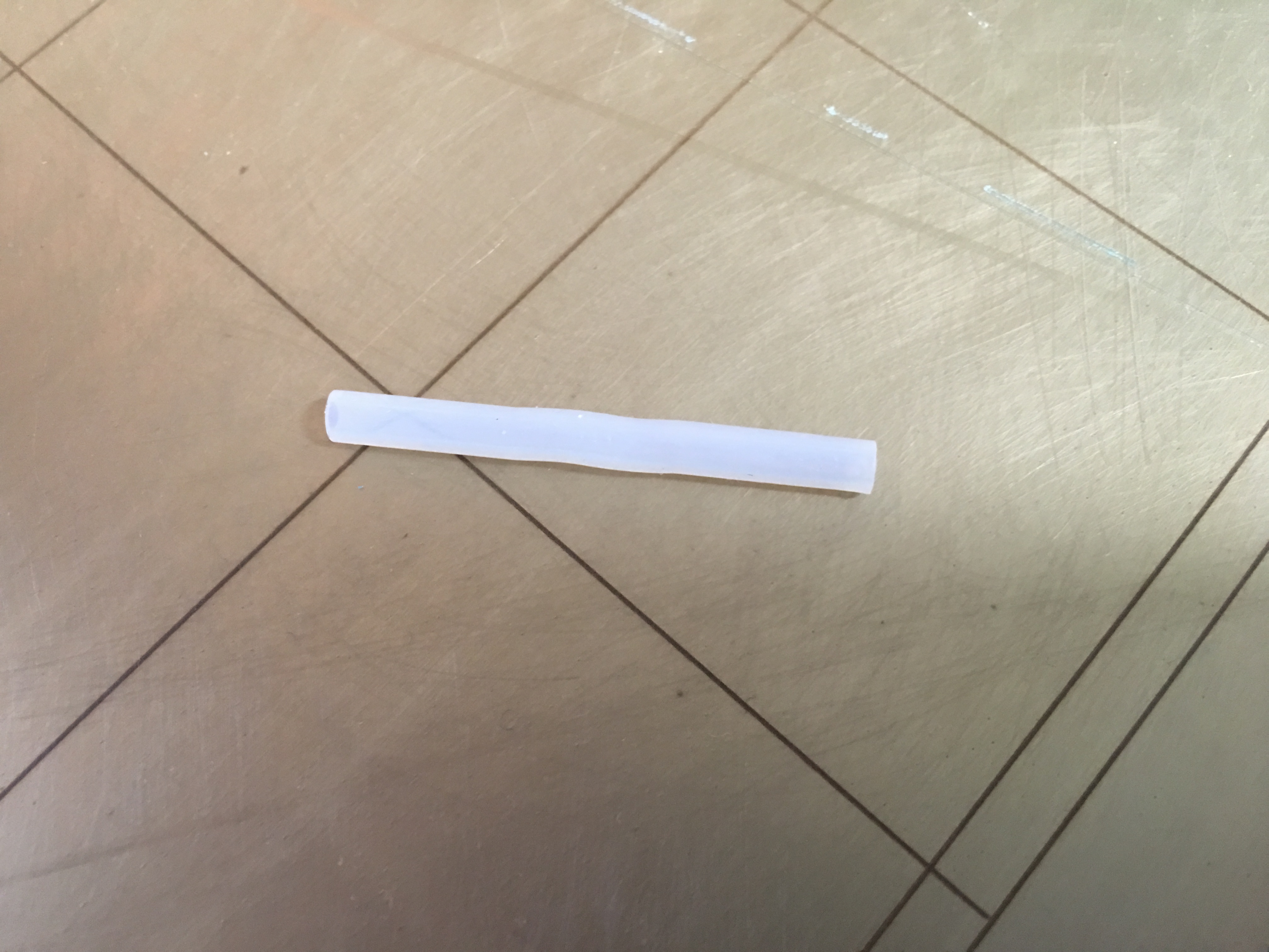

I knew I had a while before I could fiddle again, so I ordered some cap tubing.
The little insert of the hot end was actually kinked:
Got my hopes up too early though... I replaced it with a short piece of cap, and then replaced the whole bowden tube with some. The filament glides through so nice! But, alas, not my stringing culprit.

If you're printing with the default SE300 Cura profiles, it's unlikely that you've got a retraction issue.
I'd look at how hot you think you're printing vs how hot you're actually printing - test using a thermocouple.
I'll try your gcode sample and let you know how it goes.
[edit]
I cut back the temp from 205 to 198 and I was getting angel hair strings. I suspect had I cut it back to 190, it would've stopped that as well. If you can point me to the STL for that particular print, I'd be happy to slice it and trying printing it here at 190.
Re: First homing: horrible grinding sounds
Try printing this file. It's currently printing on my machine without any stringing at all. I was getting some at 198, so I backed it off to 190.
Stop trying to tear your hot end apart until you're positive it's the hot end. ;) (chances are that it's not the issue)
A300_string-test-minimal.gcode
(3.1 MiB) Downloaded 432 times
adarcher
Posts: 138
Post by adarcher »
Shoot, my file was wrong. It's the same model as before, scaled XY 200%
I had modified it from the duet web interface to 185... no change in strings.
I don't have a thermal couple, not sure how to even use one in this case to test things.
I put in a request to get a replacement hotend kit so I can test that.
I'll put my hotend back together in the mean time and try your gcode. I couldn't get the screws loose to attach a different one.
Thanks for the continued support.
