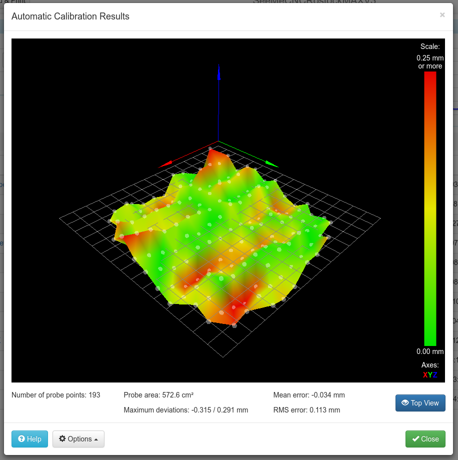

So not sure what has happened. I have a v3 with e3d v6 that has been working just fine. I auto calibrate with the Octoprint plugin and always come in around .08 to .02. Here is the series of events that occurred recently:
- I started noticing leveling issues on prints though I was still getting good numbers when running the plugin.
- Then the hotend started crashing into the bed and running the plugin would result in something normal like .08 but I would re run the plugin and it would correct again from something much worse like .2 or so. Its like the calibration was not saving when it ran. I didn't check the eeprom numbers during this to confirm unfortunately.
- I cleared the eeprom, re flashed the firmware, ran the manual delta calibration wizard a couple of times and got to .18. I tried again and same results. I can get .18 but nothing better using the calculator or the plugin (should be the same results anyways but figured I would try).
I have had this issue before when I upgraded firmware but running the manual delta wizard on the seemecnc site resolved it for whatever reason.
Not sure where to go from here. I looked the machine over and nothing obvious stands out mechanically. Any suggestions are appreciated.

So after a lot of reading I decided I would give a Duet FSR setup a try. I have finished installing a Duet wifi, Ultibot FSR kit, and Tricklaser FSR plate.
The best I can come up with is .08 using a 100 probe radius. If I try and back out the radius to 135 I get more like .16 deviation which is close to where I was. I have gone over the machine dozens of times mechanically and just cannot find anything wrong with it.
Here are my probe heights
G32 bed probe heights: 0.148 -0.100 -0.087 0.096 0.011 -0.160 -0.052 0.103 0.098 -0.104 -0.140 0.050 -0.136 0.015 0.101 -0.081, mean -0.015, deviation from mean 0.101
G32 bed probe heights: 0.136 -0.075 -0.137 0.059 0.061 -0.047 -0.027 0.178 0.111 -0.104 -0.103 0.025 -0.111 -0.035 0.051 -0.056, mean -0.005, deviation from mean 0.093
G32 bed probe heights: 0.073 -0.075 -0.137 0.109 0.048 -0.072 -0.052 0.128 0.136 -0.067 -0.077 0.025 -0.061 0.040 0.013 -0.106, mean -0.005, deviation from mean 0.084
I generated a heat map using the 135 radius. Any suggestions?

That pattern of ridges and valleys along the X axis suggest backlash in joints or carriages, making the nozzle height above the bed depend on which direction you approach the XY point from.

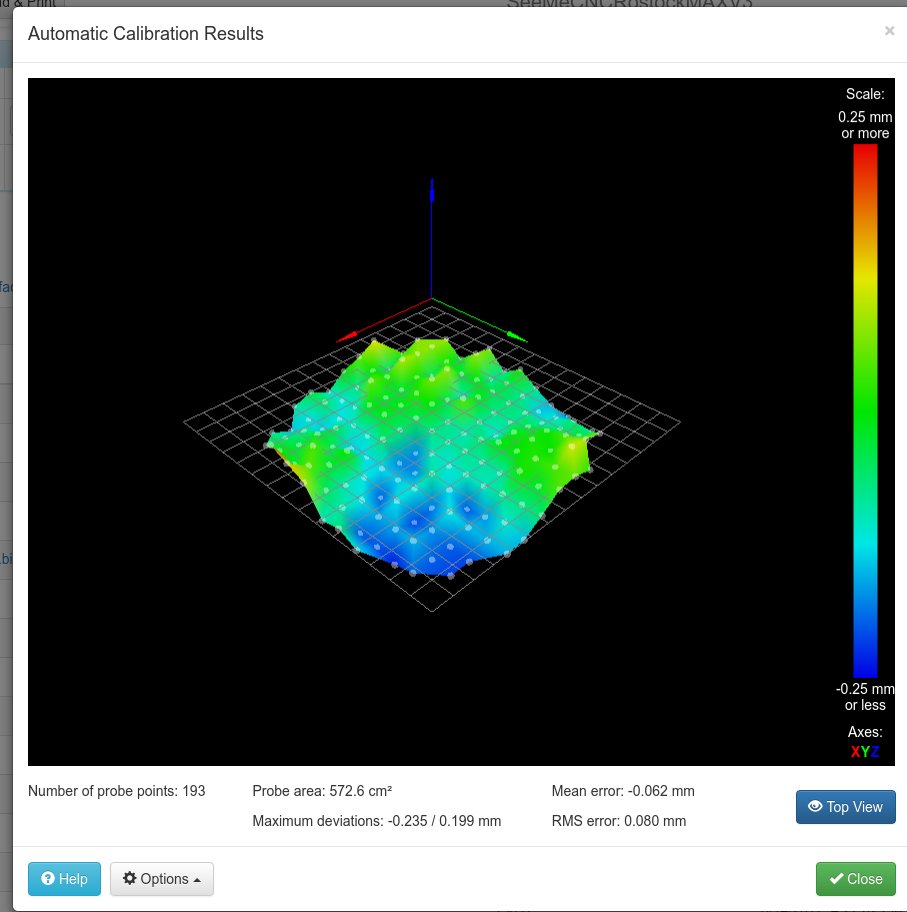

I didn't see any significant play or movement in the carriages. I went back through the pulleys and belts today and nothing seems loose or anything. I switched out the effector assembly back to the stock one to rule that out and got the same results and same basic map. I switched two carriages around and the map did change some but deviation stayed the same. I am thinking maybe just order new carriages and give that a shot?

So I swapped all my parts to a Tricklaser Max Metal frame. First calibration attempt was .06 and that is with me forgetting to tension the belts. I did use new FSRs but I was having calibration issues before I even moved to duet so I think I just had something wonky going on mechanically. Going to order a titan aero and I think this will be a very nice machine.
