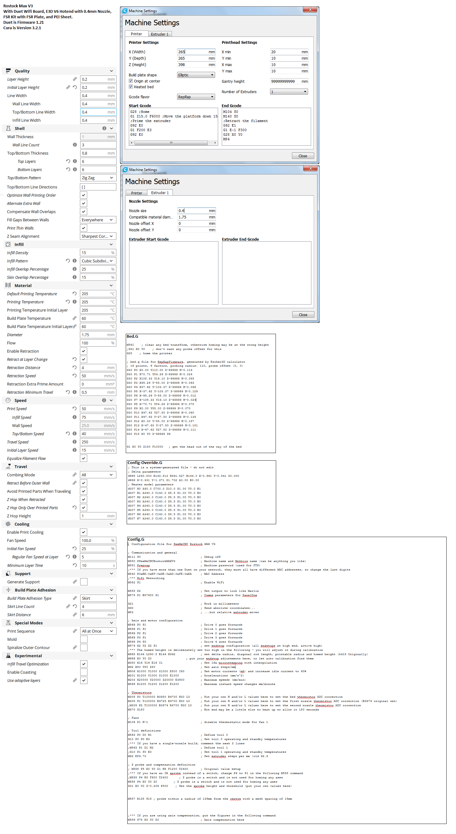

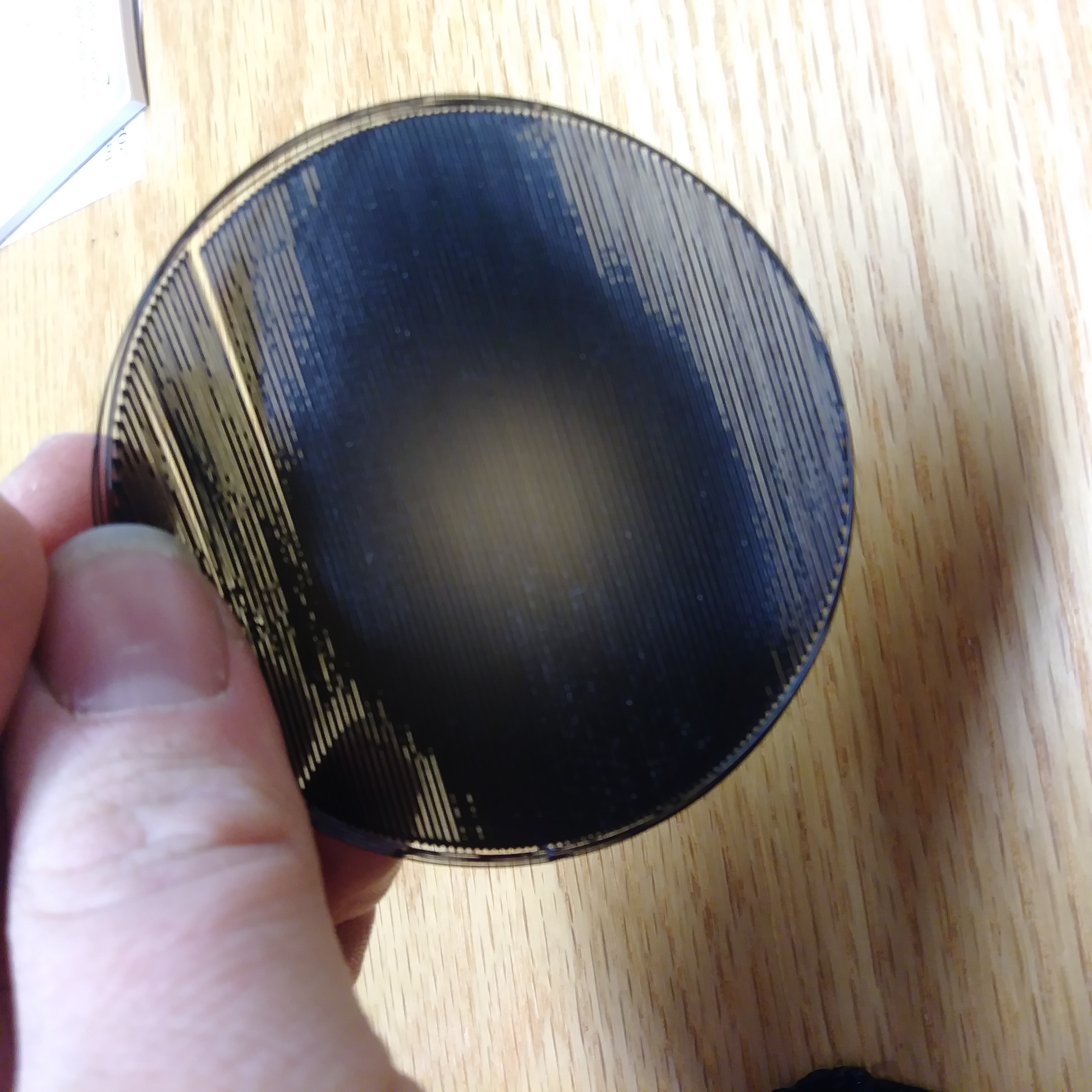

So i need some help, ive been asking people on a few facebook groups and a buddy of mine and so far no such luck. I may just be doomed to never print again. So ill give a brief history. I bought a used Rostock Max v3 it was all stock and printed fine, no problems. But I was getting my feet wet and wanted more and better. So I upgraded to a Duet Wifi Board, FSR Kit with FSR Trick Laser plate and toped it off with a PEI sheet.
Now after i finished all this (with the help from my buddy) it was time to calibrate everything with the new setup, but since ive done this ive been just having problem after problem with Z height and printing either way above the bed or the nozzle is dragging on the bed causing back pressure and making the prints very ugly. I proceeded to check everything(maybe not everything but a lot) people were suggesting on checking; Towers leveled, belts tightened, tension on the effector, if the boden tube was to short, Carriages were not cracked or wiggling, same with the effector plate and everything connecting to it, measured everything 3 times to ensure values in config.g was correct, i also manually calibrated each bed probe point to get an average and changed the H value and i think a few others but ive done so many things i cant remember the rest. And from then to now my g32's deviation has dropped from 0.300's to 0.080's but im still running into the problem that my heatmap is showing large spikes and valleys that its still messing up with my prints.
Im unable to correct the problem. As for the prints, the quality is bad, almost no bed adhesion cause its either printing too far from the bed or squishing the filament as it extrudes to a bald state. The only thing i have not done yet which i think is a sort of last resort, is to remove the m3 adhesive that is holding the Pei sheet to the glass, as well as the m3 adhesive that is holding the onyx bed to the FSR Plate. And why remove it, is because as much as i tried to avoid bubbles, i know i saw some. I had lightly scored the bubbles with a razor to pop them, but ive been told that can be whats causing the bad deviation and bad print job because it cant read a correct value. So why to put it off, is cause i feel trying to remove the adhesive from the FSR Plate and the onyx bed will possibly destroy it ( i will try everything i can to avoid it ) but seeing as im still new to this, i doubt ill be successful. As for the PEI/Glass i feel confident ill be able to remove the adhesive from that seeing as at least the PEI is flexible where as the FSR Plate and Onyx are not. But if/when i get the Adhesive off, ive been suggested to try a test with just laying them all together and using the big paper clips to hold it together and do a g32/heat map and see if all of my problems disappear.
So after reading my "book" my question is any suggestions or solutions to my problem that i can try before i attempt to remove the adhesive from the onyx / plate? Or even any other suggestions for everything ive said that can help. Thank you for any help and advice you can give. Ive been screwing around with this for almost 2 weeks now and nothing. Ill post some pics of everything i think may help, the config/bed/config-override files as well as the settings i have in cura and anything else.
All of my settings i can think of.

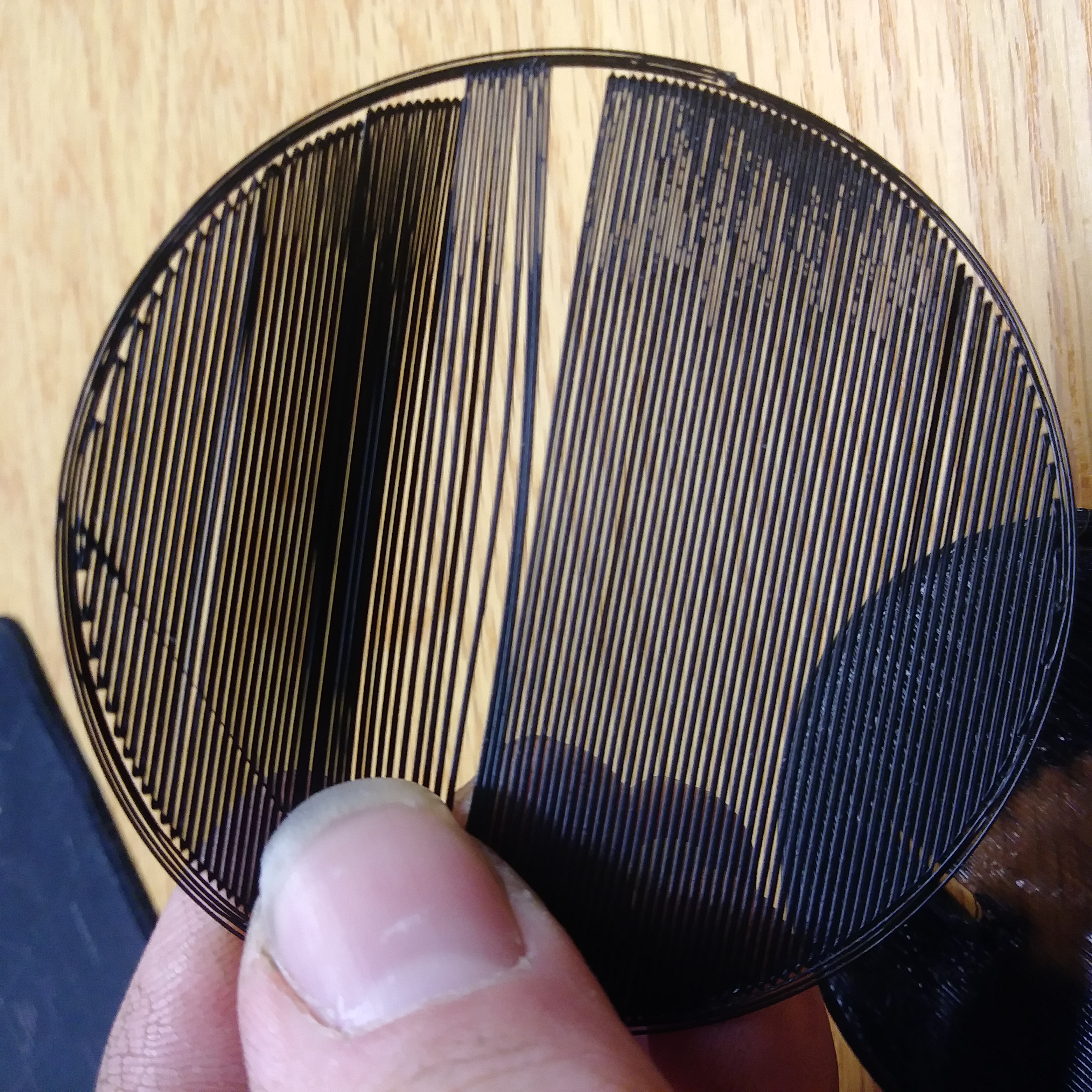

Do us a favor and post a picture of what it's doing to you.

bad bed adhesion and stringing. As for how sensitive one feels like it triggers alot easier then the other 2, but not by much. ive also got the FSR's and plate setup this way. Silicone Pad> FSR Sensor > Silicone Pad >Trick Laser plate > Onyx Bed > Glass Bed > m3 adhesive > Pei Sheet. Ive also got 6 binder clips holding the glass to the onyx bed. Even raising the z baby stepping im getting varying degrees of success. Ive just replaced my fsr plate and onyx bed and trying to test out something right now. Here are some pics of what i was getting prior. I will update with more once i get everything back to normal (rewiring the onyx bed and such)

The important thing with the FSRs is that they trigger with about the same amount of force. You can tell if one of your FSRs is "slow triggering" if you observe that either the bed deflects more on that FSR, or that it takes longer for the FSR to trigger after it touches the bed. Do your best to fix this.

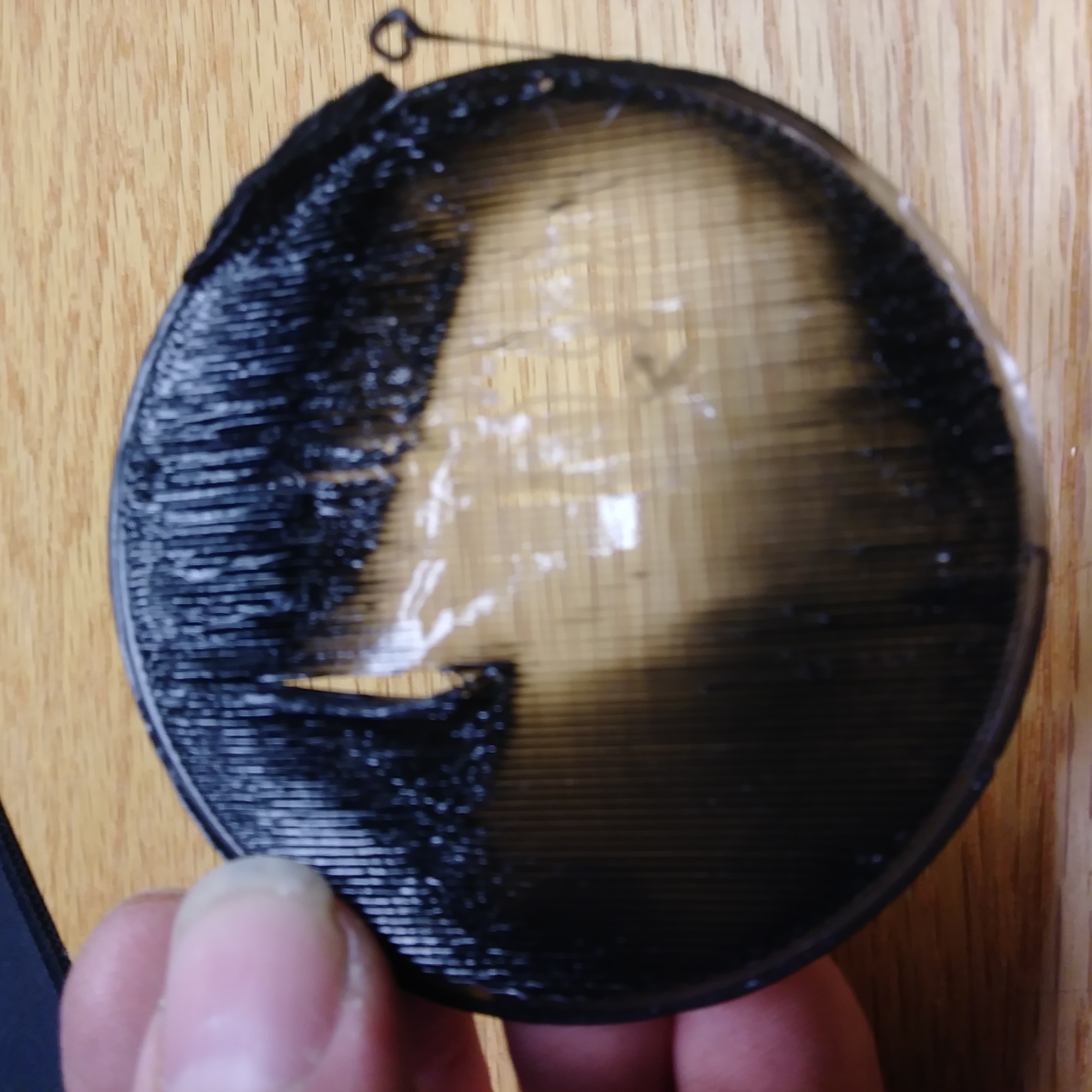

Your print pattern shows that at the very least your Horizontal Radius is too high. Fortunately the Duet makes this simple to correct. Run the "Auto Delta Calibration" and then enter the commands "M665" and "M666". Now open your Config.g and put these values in where your "M665" and "M666" lines are. Save the file, and upload it. This should get you pretty close.

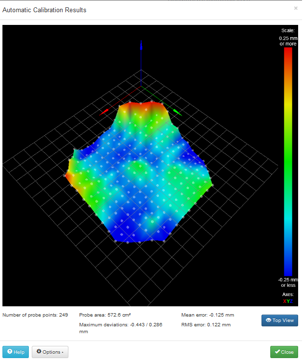

Still running into the same problems even with new fsr plate and onyx. It just seems to be high on one side then low on the other side of the print. Ive got some weights ill try to dial it in more as for how much force is required to set off each trigger. In hopes i can give better information. I will also try the m665/m666 lines and post the outcome.

did m665 /m666 and updated the config.g file and tried another print. It was pressing down on the bed to the point of setting off all of the fsrs. i had z baby step it up 2mm and it was still 1/3 of the print hitting the bed and the other 2/3 was high enough off the bed so as to cause the stringing effect, where each line was not touching one another.

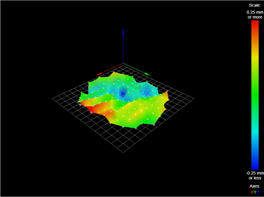

I had looked for FSR mounts but didn't come up with anything, so I used the three wedges that came with the plate. And I found what was wrong with my "problem child" sensor, I had it mounted too far to one side and not on the center. It might not fix it entirely, but at the very least it's no longer "skidding" the hotend across the plate.
I'll print up the FSR mounts tonight and use the new FSRs that I have coming with them.
Update: I just ran the grid comp, and things look pretty much spot-on! Yeah!
And it occurred to me that there is no reason for the wedges to be installed during the grid comp, so I removed them for the grid comp (which removes any chance of binding).

Not too bad...

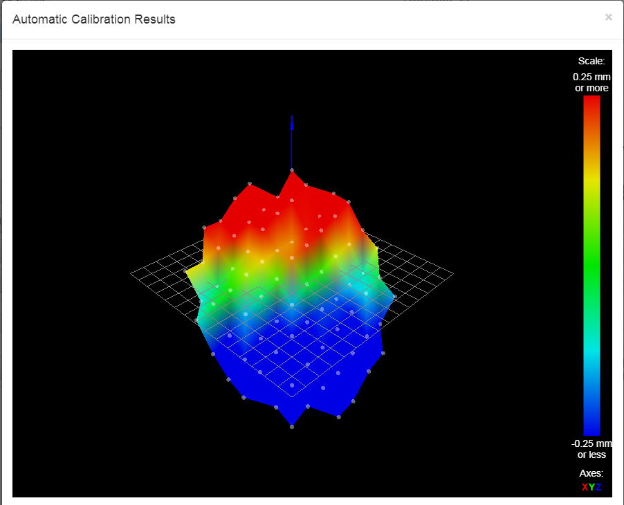

Oh yeah, this is what it looked like before:
