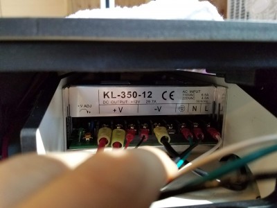

So I should at least replace the fuse. On the metal box (the power supply I believe?) I am getting 12.36, how do I attach a picture (I'll look after I finish this post)
Brodensears
Posts: 13
Joined: Sat Sep 01, 2018 6:00 pm
Re: Temp Undefined, possible broken heater for HE280
Post by Brodensears »
Here should be the image. I measured across the second from the left thick red wire and the thick black wire on the right

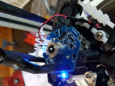

And I confirmed again, while trying to heat up the nozzle I get 12.1 V across the fuse and I also get 12.1 volts across the entire block by measuring from the two wires with the solder sticking out from the board
Brodensears
Posts: 13
Also, when checking from the RAMBo I get 12.1 across the hot end terminals.
Brodensears
Posts: 13

If you are indeed getting 12v across the fuse, then yes, it's an issue with the fuse. Fuses aren't always visibly blown, especially ceramic and thermal fuses. As for 1, well, if you look at your picture, the knob should be on the left side, underneath the V adjust
I think you're still confused a bit about the voltage drop though. Voltage does not have a universal zero. It's always relative to something. If the fuse is not blown, then the two sides are connected, and thus the difference between them is very small. This means a small voltage. If it's blown, then they are not connected, and the difference can be quite big. For other components, if you have a large voltage drop, and a high amperage, that means a lot of power is flowing. But a fuse does not allow any power to flow, because no amps are getting through, despite the voltage drop.

"So I should at least replace the fuse. On the metal box (the power supply I believe?) I am getting 12.36, how do I attach a picture (I'll look after I finish this post)"
"Will a blown fuse also be visible to the eye?"
Nope, you've got it backwards. A good fuse will have a few tenths of an ohm of resistance, and that multiplied by the current that is going through it creates a voltage drop across the fuse. Whatever that voltage drop ends up being will be robbed from the rest of the circuit, and won't be available for use elsewhere. But for a properly selected fuse, this is negligible.
A blown fuse will have infinite ohms of resistance, and therefore nearly all of the voltage drop will be across it. From your readings, the absolute max voltage drop across your fuse is about .25 volts (neglecting other drops in your circuit), that's perfectly fine.
Blown fuses are pretty obvious, ranging from blackened glass where the element should be, to brown goo on one end or both ends (usually indicating a bad fuse holder), to shrapnel when it blows to kingdom come (one of the ratings that we need to pay attention to is the symmetrical amps. 200,000 RMS symmetrical amps is usually a good number). Non-glass fuses usually require a meter to check out.
From reading further on in your posts, it appears that your fuse is working just fine, and you should leave it alone. Your 12.1 volt reading sounds normal to me.

NP. Next we need to look at your thermistors. But since both were going astray, I suspected a voltage drop problem.
And I'm still confused from your original post stating: "I tried the voltage across the fuse on the heater and the voltage going across while on is >12." Could you post a picture of how you are making this measurement when you test it please?
And I just took a close look at the photo that you posted in post #13, and the solder joint on the "-" terminal for your hotend heater sure looks wonky to me. Can you touch that up with a soldering iron and try it again please?
