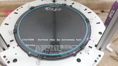

Betacha cant print this. wide Calibration test
Calibration errors in center tend to cancel each other out. At the edge sometimes they add together.
Also printer parts out of tolerance can show up on the edge.
If it has problems, it will make bare spots, trying to print too low, or print in the air which you can tell by
it not sticking.

Thanks for the file. You are probably correct in that most printers will not be able to print it without problems.

276mm ≠ 280mm
I can do a 276 circle too, but so far cannot really meaningfully print that far out.
I have elevated the bed on 2" spacers to allow the Cheapskate to move down past it further, thus bringing the delta arms closer to horizontal, thus extending their reach. So far the results are promising, but calibration seems to be a bitch - I'll be trying Rollie's method if I can: http://forum.seemecnc.com/viewtopic.php ... 8&start=25

There is an essential problem with tiny variations in arm lengths, connectors, which is almost unavoidable with sanding the parts to fit.
The geometry of two parallel arms is intuitively great, and variations tend to get averaged out in the center of the printer.
However, the "worst" places the small variations, say 0.1mm, which are generally ignorable, get multiplied
when the arms are moved to the side at maximum deflection. There is an area where the errors get multiplied vertically,
so even well matched arms may get a vertical error of up to 0.5mm, again not disastrous except on the very first layer.
If you can print this, you have an exceptionally well made machine, congratulations!

In the last hour or so I have printed this circle a few times;
ONE of them showed a pattern on parts of it that looked a bit like a braided rope, I discarded that before thinking very much about what that might mean.
I did it again to see if that pattern was near a particular tower, between two particular towers, etc.
That print had the pattern just about everywhere around the circle except maybe a couple of inches at the 12 o'clock position and another short segment at 6 o'clock.
I thought it might be looseness at a joint or a slack belt, but everything felt tight, so I got to thinking that it might be a "reluctance to move" due to friction, so I greased the rails.
Ta Dahh - - all is well, VERY WELL !!!
Conclusion; there was some sort of sticking followed by sudden movement, a chattering.
Thanks again for this test print.
