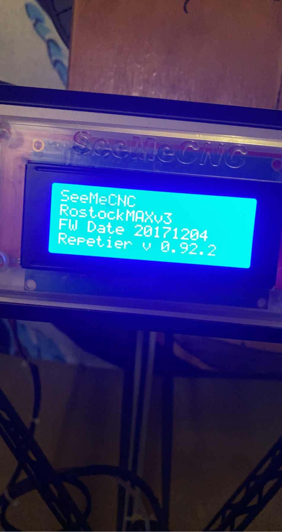

I cannot. The dial is not scrolling through different sections/ options. I am just stuck on the main screen. does this mean I have a hardware issue?
Posts: 5359
Re: no response from Rostock MAX V3
Can you post a photo of what your screen looks like?
Dexter Carhart
Posts: 8
Joined: Thu Jul 22, 2021 11:53 am
Post by Dexter Carhart »
Here it is.
Posts: 5359
I think I mentioned this before - if there's a wiring issue to the HE280's PCB, the firmware will hang on initialization, which it appears to be doing in your photo.

Check for shorts in the wiring harness - if there aren't any, you should probably reach out to [email protected].
