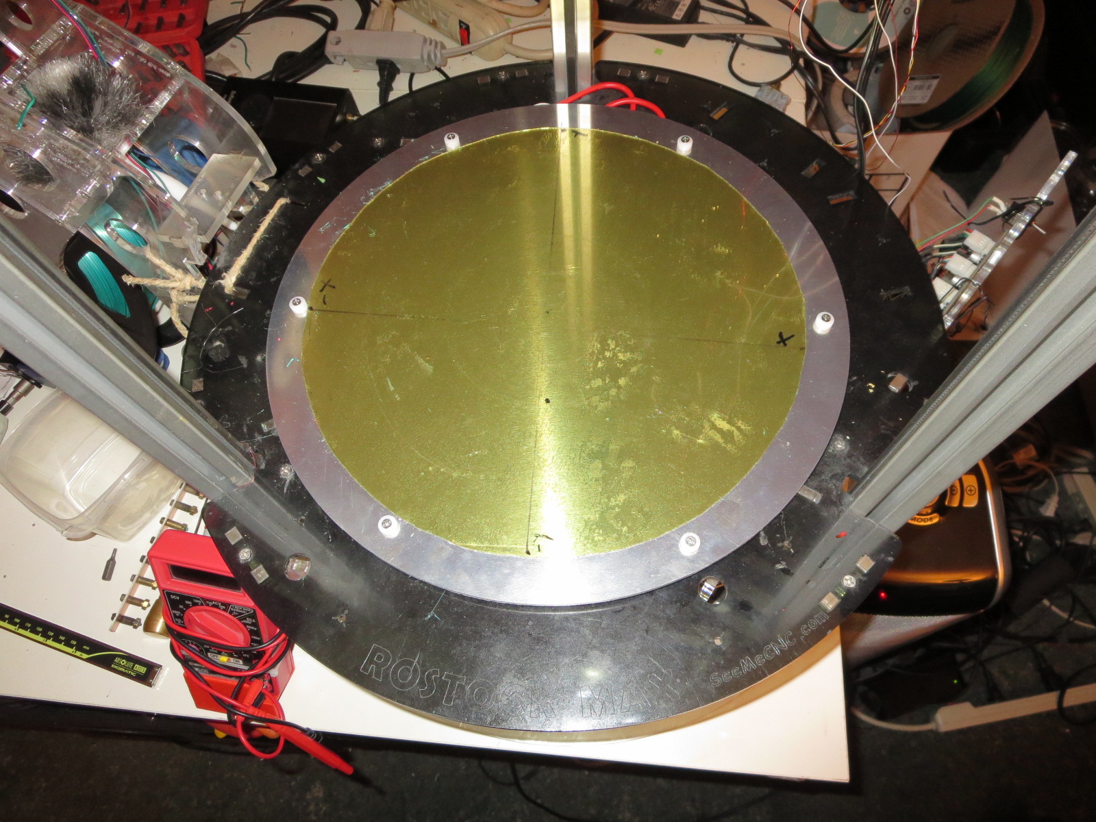

I dusted off my Rostock Max v1 from Indiegogo 2012. The arms are a bit loose and move a few millimeters if I jostle the effector.
It has Smoothieboard 32-bit electronics.
I've been trying to get auto-leveling to work. Adjusting the screws on each tower doesn't work well enough anymore.
I added a bltouch v3.1 to the Smoothieboard and have the process working. However, it does not level the bed.

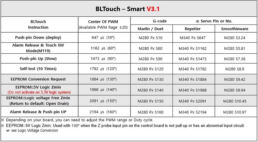

M280 S3.24; #deploy the probe

M280 S7.36; #retract the probe

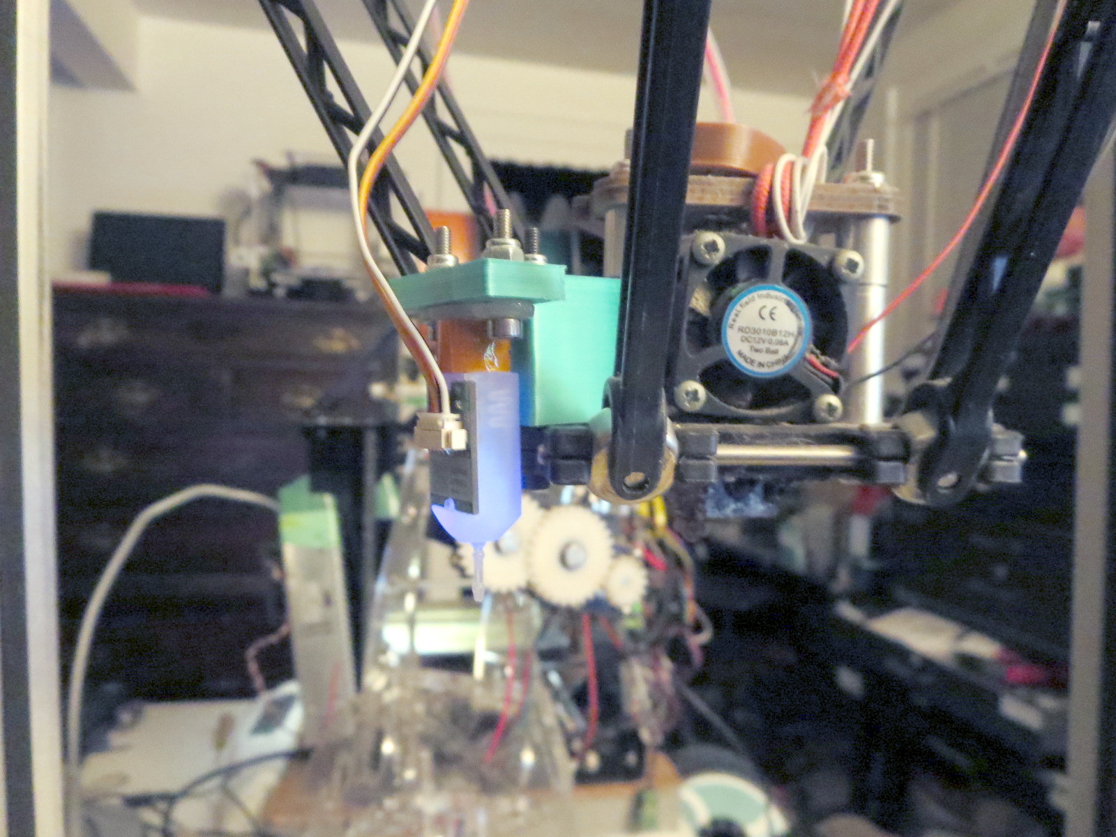

I mounted the probe in one of the corner holes of the triangular effector. It's about -50mm on the Y-axis, relative to the bed. The maker of Smoothieboard said that the probe needs to be in the same position as the hot-end in the X,Y to get accurate results.
Anyone have advice? The bed is still off about 1mm when moving from X100 to X-100 and Y-100 to Y100.

Maybe I should measure the distance between the effector and the bed to see if it's parallel. Another idea is to make the leveling screws exactly the same height before trying to auto-level.

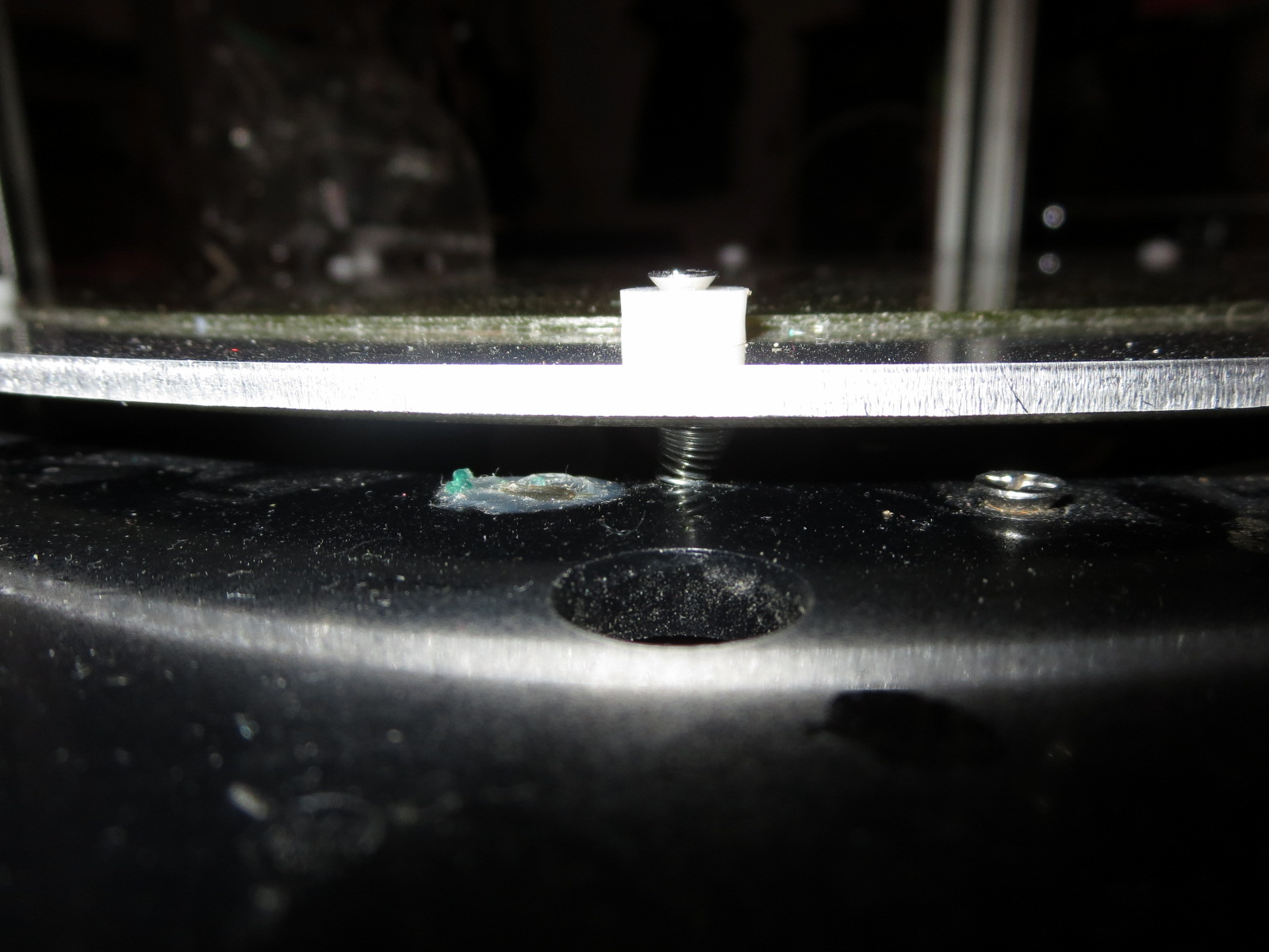

I think the autocalibration is needed because my bed is not flat.
I replaced the original MDF wooden fractal star with a solid disc of aluminum, thinking that it would help.
Maybe the acrylic has sagged over time or the aluminum disc is a little raised in the middle.
I put springs under each of the 6 mounting points and that helped enough for 0.5mm layers but not for 0.25mm layers.
Steve from SeeMeCNC sent me a few links to buy the parts to fix the looseness in the arms which will cost about $100 + shipping.
Re: bltouch probe
I suspect those springs are your problem. Even the Rostock MAX v0 didn't use springs under the bed - it was nylon spacers.

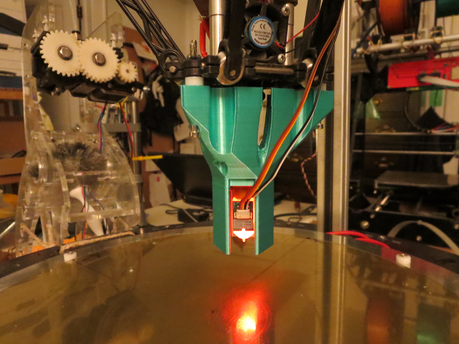

The maker of Smoothieboard (electronics) said that the auto-level probe is supposed to be in the same spot as the hot end in order to make an accurate delta probe grid. So I may need to 3d print something so that the bltouch can be mounted under the effector temporarily and then removed.

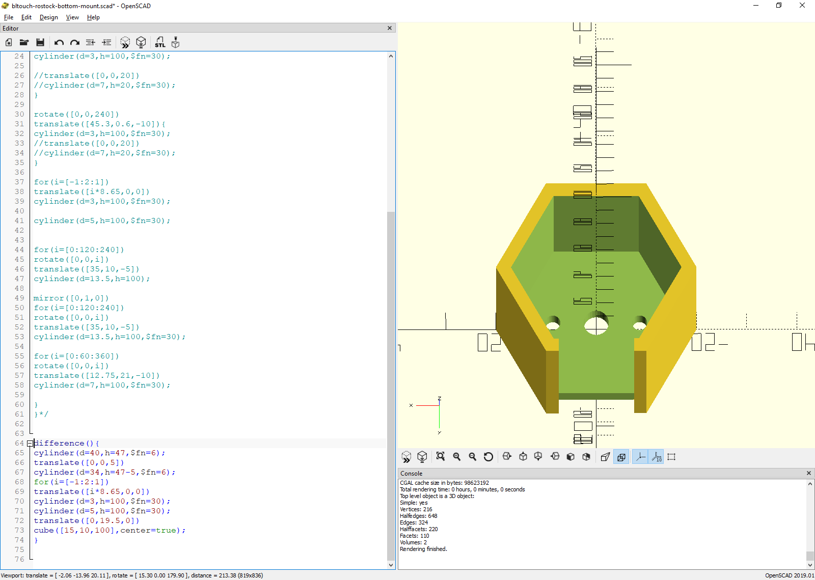

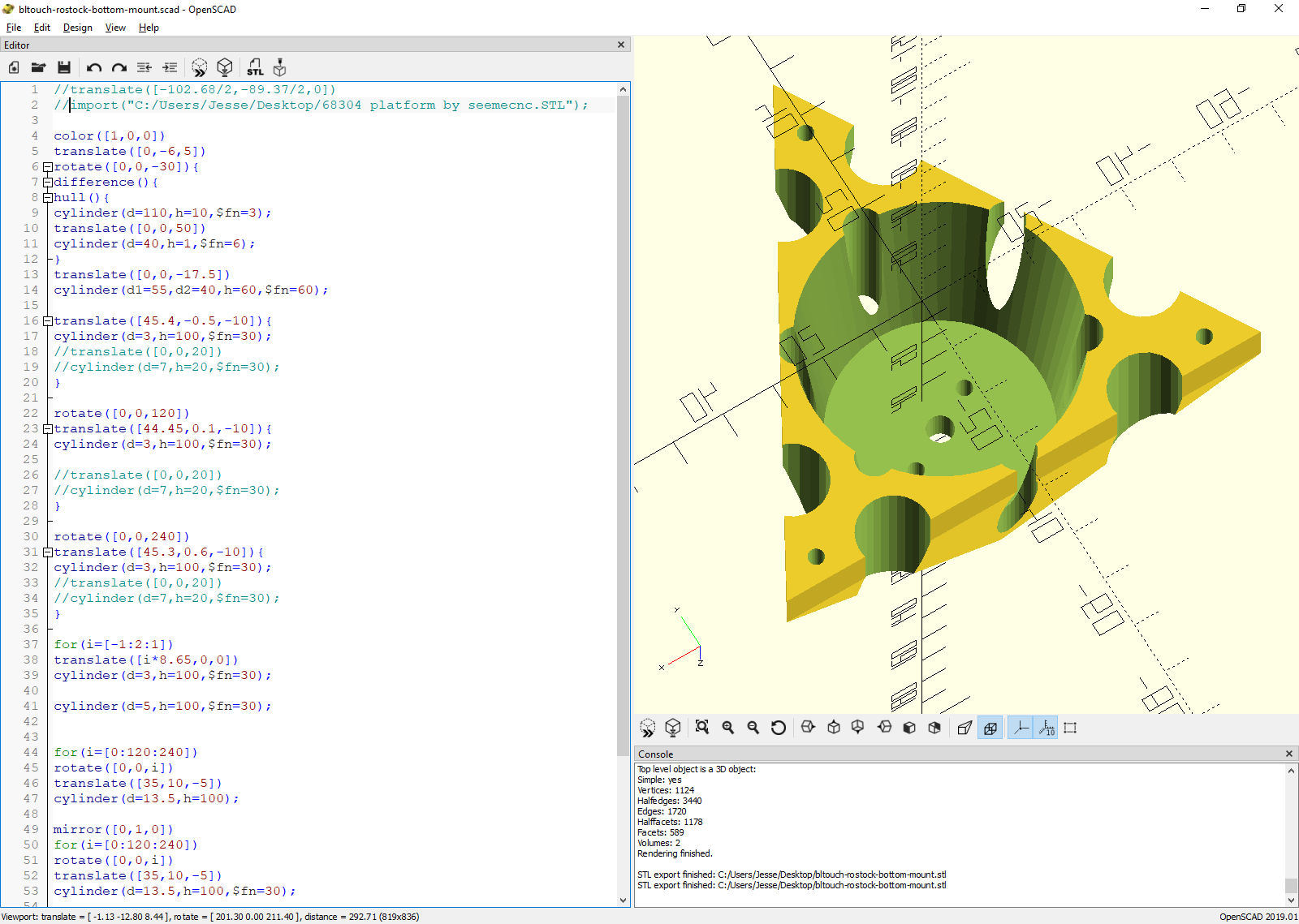

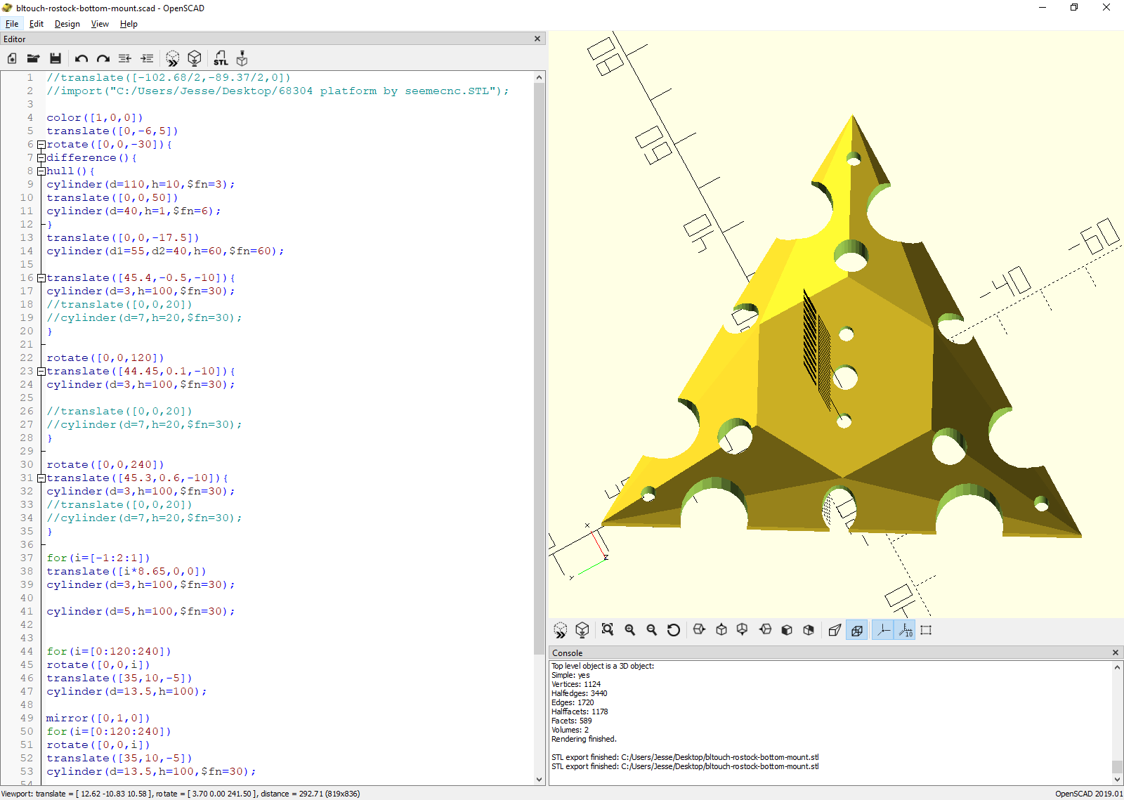

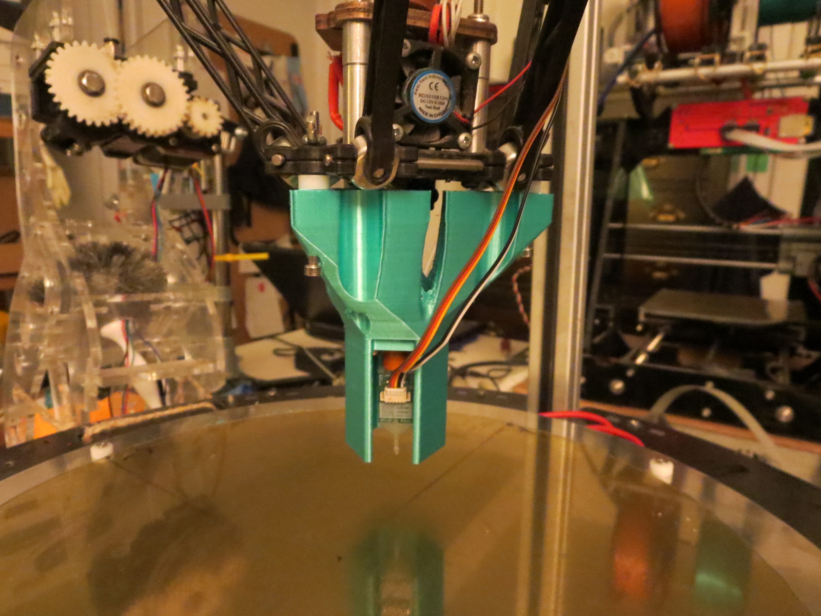

Here's what I came up with as far as a mount for the probe. I put a shroud around the probe so that it can't slam into the bed if something goes wrong.
Re: bltouch probe
Does it work well for you that way?

Yes, it works now, mostly. The printer can make a 9-inch cylinder with 0.25mm layers.
A 10-inch cylinder would be nice, but it doesn't work. Not sure if it's because of the limits of the printer geometry.

The probe is attached to the effector using a set of three M3 screws and wingnuts.
