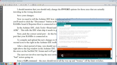

I checked the limit switches multiple times and they're working fine. The temperature control works great for both the hot end and the bed. I finally got the arms to move smoothly by cramming the crimps in the 4 pin connector for the X axis, but they slide out easily after a while. I don't like the 4 pin design.
Now I just need to invert my axises to be able to G28 home. I inverted the directions in the configurations file like the directions said, but how do I upload the code to the rambo? I attached a screenshot of the error last time I tried.

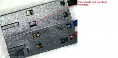

there are locking tabs in the pins, if they get crushed they wont lock in place

I still can't upload the firmware. I followed the directions in the latest manual but they aren't very specific about how to upload code. See the screenshot a few posts above.

try arduino 1.0.3 and above, doesn't seem you have the files loaded in your arduino ide, when you select repetier.ino/ repetier.pde file. it should open all the files that need to be uploaded.
not sure that you can just upload the config.h file like that.

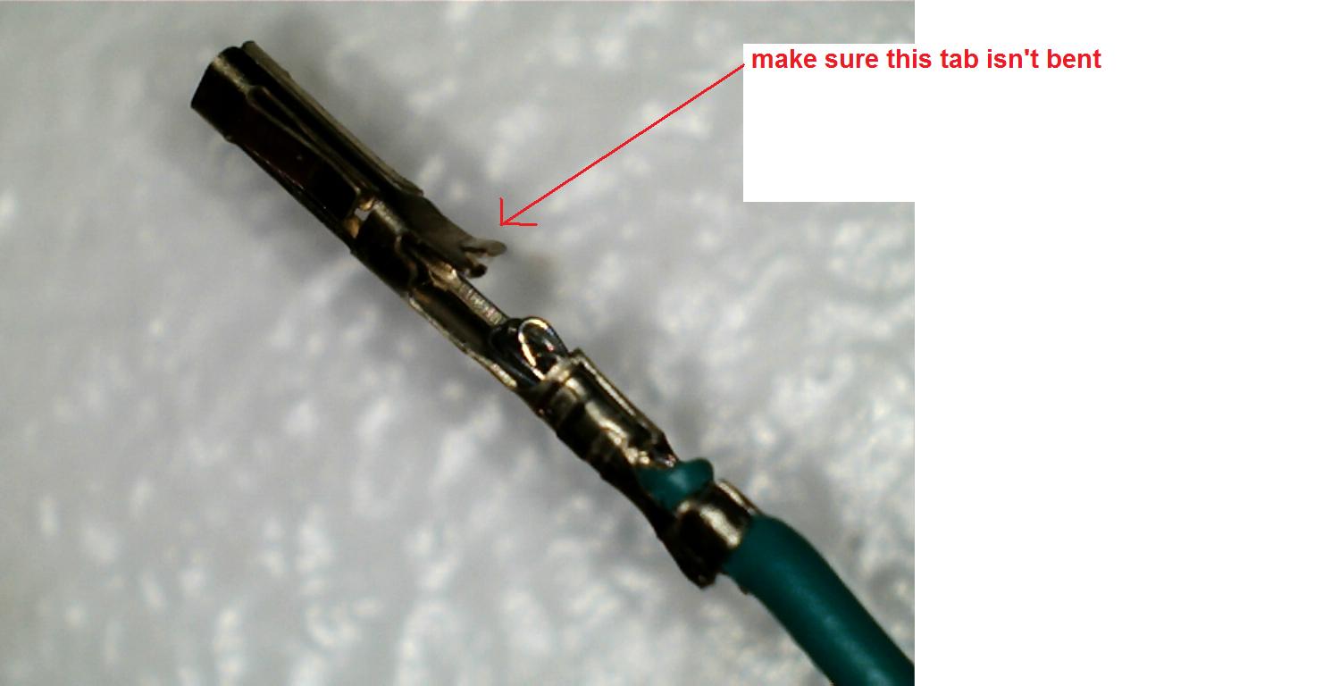

do have a pic of your pins? i'll take pic of what they should look like for you
make sure this tab isn't bent down, it should be sticking up as shown. if its bent down, take some tweezers and slightly bend it back up.

On the firmware front, you need to load the Repetier.pde file into the arduino ide, not just configuration.h.

I also checked my crimp pin inserts, and they look just like that picture. The plastic pin connectors that actually fit into the rambo receptacles are wobbly, but I think that's normal.

The shouldn't be wobbly, did you feel the click when the pins go into the connector?
You should.
There is a point when inserting the pins where it looks very similar but it's not in far enough, you should not be able to see the pin from the top, and that often means using a pair of pliers to push the pin in using a small amount of the insulated wire at a time. If it was easy to get the pin in then its probably not far enough, although sometimes you get lucky.
