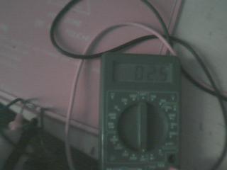

meter set to 200 ohm setting iam getting 2.0 on the post of hotbed

ya i did, i un-sodered the hot bed and metered , it came to 2.2 with out wires and i put new ones on and getting same 2.2 ohms

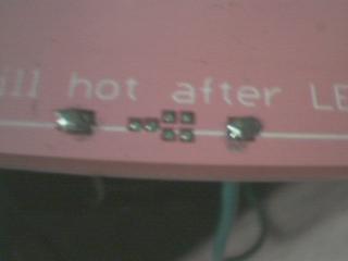

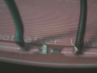

what i was trying to see was if you shorted the solder connections.
pic would help.

some pics. this hotbed came with pre sodered resister and led.
3dpics2 101.jpg (6.37 KiB) Viewed 14818 times
3dpics2 095.jpg (6.18 KiB) Viewed 14818 times
3dpics2 094.jpg (4.97 KiB) Viewed 14818 times

Re: any one know how to get a mk2 heat bed to work with ramb
Post by cambo3d »
hard to tell anything from those pics
