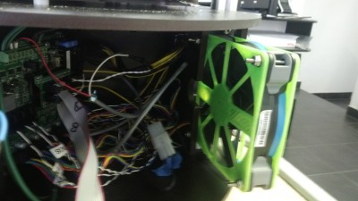

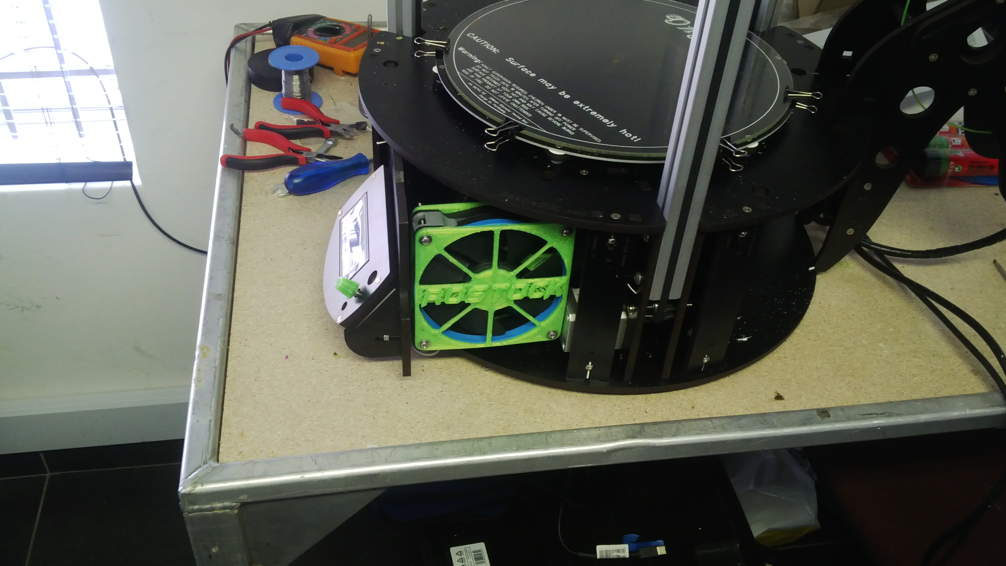

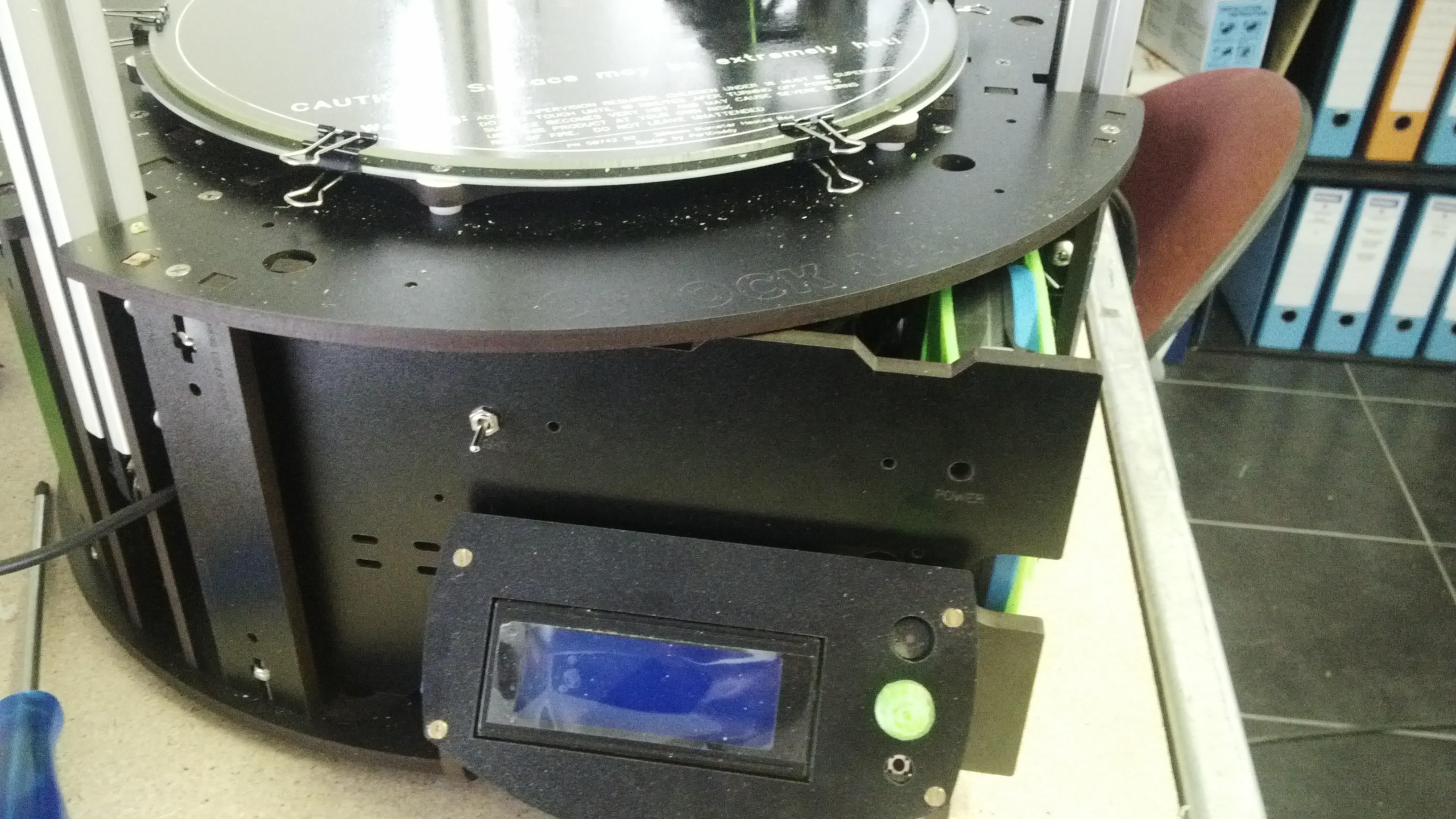

So.. I has a large print crash on me and I believe the culprit could be a overheating RAMBO, so I Went all out and slapped on a HUGE 120mm cooling fan.
Designed a couple of cool looking fan Grilles on Rhino and printed them out. - Quality is not fantastic as I am still waiting for the Bearing "tyres" for the outer bearing support that were short in my kit.
So far VERY happy with the machine, and I am truly amazed at how easy it is to use, Now that I have the hang of printing off the SD card.
Next upgrade will be Tricklaser arms and a E3D hot end, maybe a "Gregs" extruder.. ?
RAMBO 120mm Cooling Fan

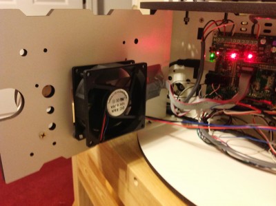

Not sure if you've done this or not, but I added some small heatsinks to the back of the RAMBo where the stepper motor connections are and then using some of the extra nylon spacers that came with the kit as spacers mounted the board with some clearance on the back. I have a fan mounted to the door that pulls air through the gap where the LCD is mounted and blows on the RAMBo. I haven't had any overheating issues and have printed a couple of prints that took around 8 hours.
Re: RAMBO 120mm Cooling Fan
If you ever get a chance a picture of that fan and how it is mounted would be appreciated. This sounds like the best solution. I don't like fans just stuck in an open door.cpunches wrote:Not sure if you've done this or not, but I added some small heatsinks to the back of the RAMBo where the stepper motor connections are and then using some of the extra nylon spacers that came with the kit as spacers mounted the board with some clearance on the back. I have a fan mounted to the door that pulls air through the gap where the LCD is mounted and blows on the RAMBo. I haven't had any overheating issues and have printed a couple of prints that took around 8 hours.
It's in my n00b build thread, but since I can't figure out how to get a permalink to a specific post here's the pic again:Eaglezsoar wrote:If you ever get a chance a picture of that fan and how it is mounted would be appreciated. This sounds like the best solution. I don't like fans just stuck in an open door.cpunches wrote:Not sure if you've done this or not, but I added some small heatsinks to the back of the RAMBo where the stepper motor connections are and then using some of the extra nylon spacers that came with the kit as spacers mounted the board with some clearance on the back. I have a fan mounted to the door that pulls air through the gap where the LCD is mounted and blows on the RAMBo. I haven't had any overheating issues and have printed a couple of prints that took around 8 hours.
I have it wired so that it runs whenever the printer is on.
