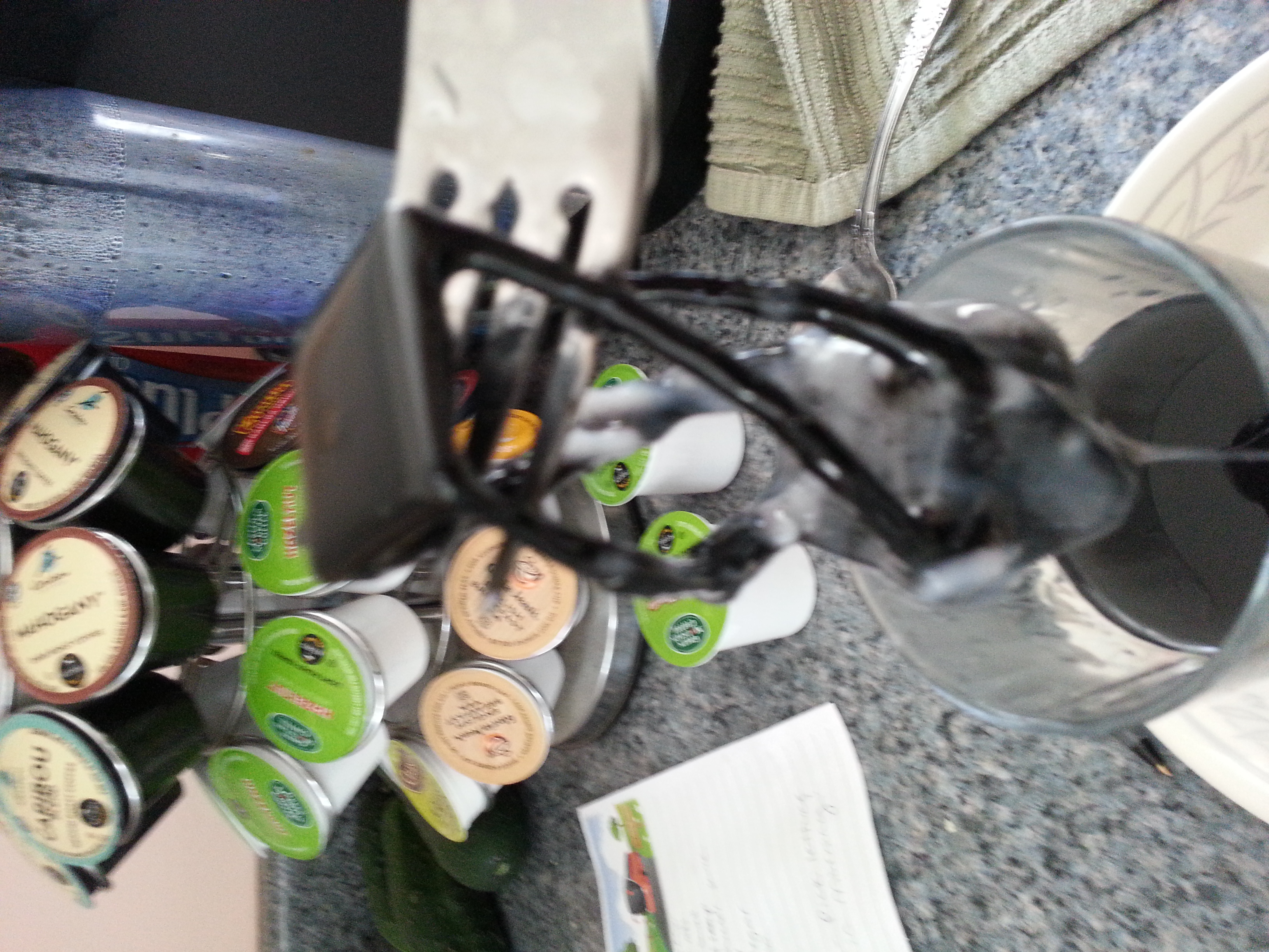

Just gave the first print that had the hips support a bath in limonene. It didn't come out clean as a whistle but it did melt the support material. I ended up getting a 100% pure limonene and think it could be diluted because it "melted" the ABS similar to an acetone vapor bath and it only took about 2 hours to dissolve the HIPS were I read it could take 24 hours. I tried using some other citrus based cleaners that were about 5% limonene on the raw hips material but it had no effect, so there is still a lot of room for testing.
Note: it could be that my ABS filament is crap and thats why it melted because I have had a difficult time with this role of black (kinda why I wasted it on the test). I suppose I can test it on a good roll
PS: Don't mind the poor print quality...it was the first print with duals. The machine is nice and calibrated now
Re: Dual extruders
Nice.
With regards to diluting, I saw this post (https://groups.google.com/forum/#!topic ... Os3lmLrgbo):
"I just received a gallon of the limonene, and tried to see if it
really does dissolve the HIPS filament. It dissolved it completely in
under four hours. I also put some filament in a cleaning solution I
made with about 1/4 cup of limonene, a squirt of Dawn dish washing
liquid, and 1 3/4 cups water. The filament dissolved in under six
hours in that. "
