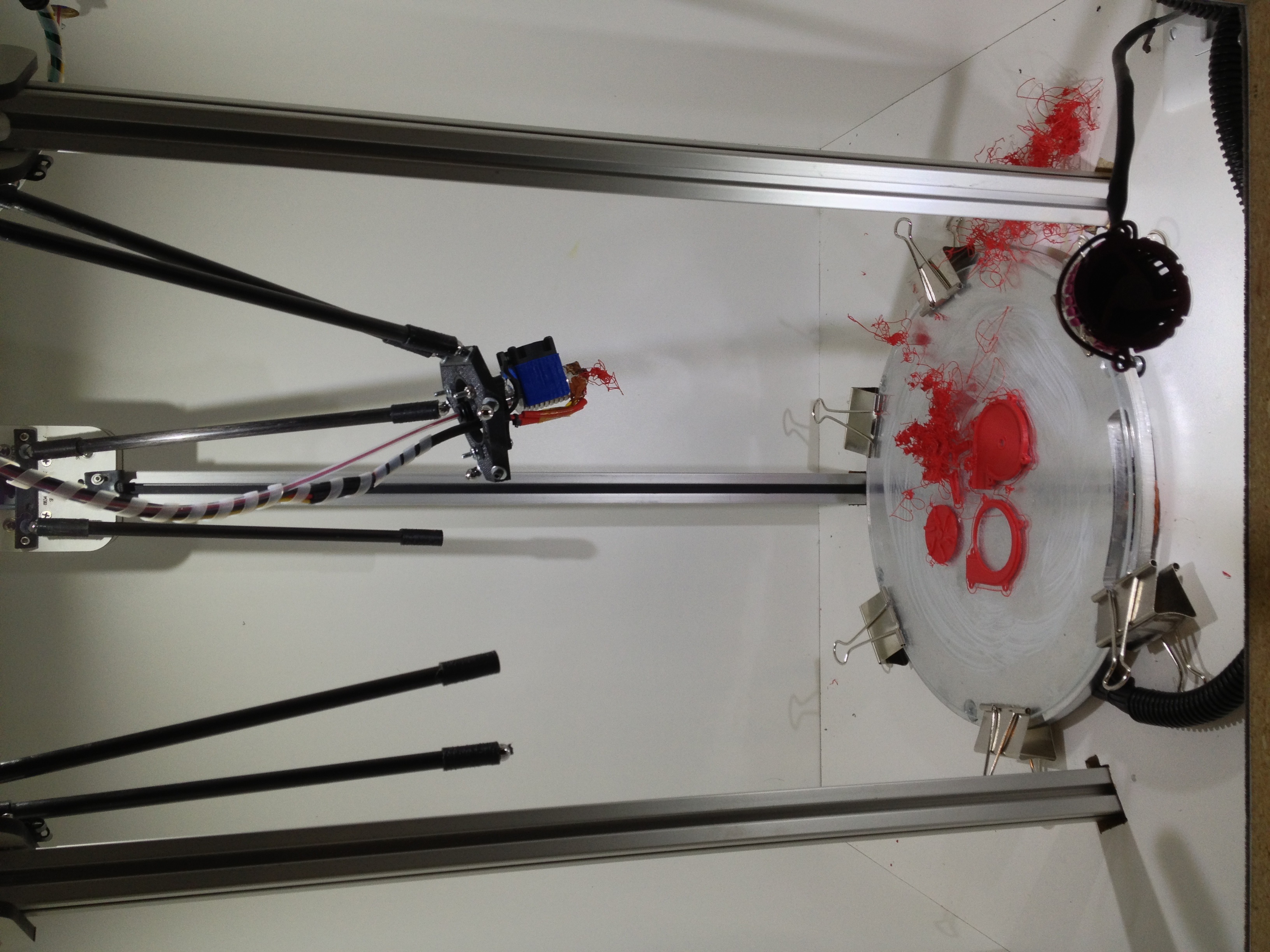

This is about the third or fourth time I had to reapply jb weld to the ball ends. I ran a bunch of prints just fine. Then I changed a few things during a upgrade period.
It could be the heat in the enclosure since I started using the glass window.
I tightened my belts with tensioners.
I re adjusted the pillars.
Installed dampeners
Ever since I did these things I can't print for more than 4 hours without my balls breaking. Since I did it all at the same time it's hard to tell the source.
Of course this happened right after I fell asleep.
Also the red filament I bought from see me cnc was 1.58
How weird is that? I haven't checked my other colors yet since my big filament purchase.
Installed dampeners

Mine have all held up just fine. Maybe something in your preparation? I can't see how any of the changes you mentioned would be a cause... The only one acting on the balls would be your enclosure, but jb weld is good to 550F so it seems unlikely this would cause a problem.
You definitely want to scuff the balls where the screws are going with some sandpaper so the jb weld has something to grab. When mixing the jb weld, once I think it's mixed I keep mixing for another full minute. Clean the balls and screws well with alcohol or acetone. Be sure to let them cure the full recommended time before putting them in use (I think 18 or 24 hours).
Hope that helps.
Hope that helps.

I'm going to go ahead and reveal I've gone against the common knowledge here because I was having the same issue. I used Locktite Super glue - professional. In my experience with it, it has held better than the epoxies I've mixed, and I use the part within minutes. Same prepping (since I had already done all the cleaning and scouring for the epoxy). If I didn't use what I already had, I would have considered using their ultra gel super glue.
Re: Keep losing my balls.
Heh, I've had the same problem for the first week after converting to magarms.
Here are some of the things that I've done that have resulted in better ball retention:
- quick rinse and shake of both the bolts and balls in acetone. specifically the bolts are covered in a machine oil.
- take a file and scuff up the top of the bolt a bit
- get some overlap when you jbweld the bolt to the ball, don't just dab the top of the bolt and expect it to stick
- when you do this, jbweld some extras, "just in case"
- let the jbweld sit for at least an hour. I know it says 6 minutes, but the longer you wait the better the bond

That's jb kwik. It's faster but not as tough as jb weld. I wonder if others experiencing failures are using this instead of jb weld.gestalt73 wrote: [*]let the jbweld sit for at least an hour. I know it says 6 minutes, but the longer you wait the better the bond[/list]
I used the highest hold strength full blown cures slower than pain drying two part tube of awesome and it was popping. *shrug* I don't argue with superglue working for me.

I MIG welded mine to the tops of the cap screws. Mine have never come off.

As long as you don't vaporize the screws, just a couple tacks should work. It's not like they're holding any weight.edward wrote:What kind of setup and settings did you use? Wire size? Feed rate? Gas or flux core?Flateric wrote:I MIG welded mine to the tops of the cap screws. Mine have never come off.

My trick to getting them all seated and consistent was to use a large magnet or a magnetic grounding attachment for the welder. Place this in a vise, let the cap bolt magnetize to the magnet and then let the ball magnetize to the cap bolt.
Then with extremely low feed and at the lowest setting on my welder a selectable 4 power levels a tiny and quick tack was all that was needed. Any more sand the tiny cap bolt will warp or burn off. Does not need strength so much as just being held in position.
Flux based, being messier and not as precise would be more difficult but not impossible.
For one of my effectors I currently use a hd platter from a hard disk that has small holes drilled for each ball to sit into and then I use jeweled stick from the bottom through the hole. I rub he uncared but mixed stick over the surface of one side of the ball (slightly roughened with 400 grit sandpaper) until I feel the jeweled stick I am rubbing against it start to get tacky and adhering then place the ball and squish the stick through the hole leaving a small amount on the opposite side of the hole to act as a lip as well. This is a zero chance for failure mount technic if you do not want to or have the means to weld.
The disc of the hard drive is the perfect diameter for a effector platform and has a decent sized hole perfectly centered for the hotend. It is also stiff and light in weight and can be easily drilled for the standard hole pattern for mounting options.
It also will not melt or deform from the heat of the hotend. And best of all can be had for free since everyone can get there hands on an old or bad hard drive to disassemble.

In my prior testing, I could not get the balls to adhere enough. They kept coming off even with careful prep so I never installed this modification to my rostock.
Welding is the probably the best most reliable way of doing it. Unless you can find magnetic balls with studs already screwed to them.
