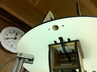

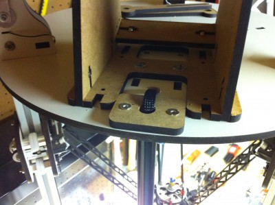

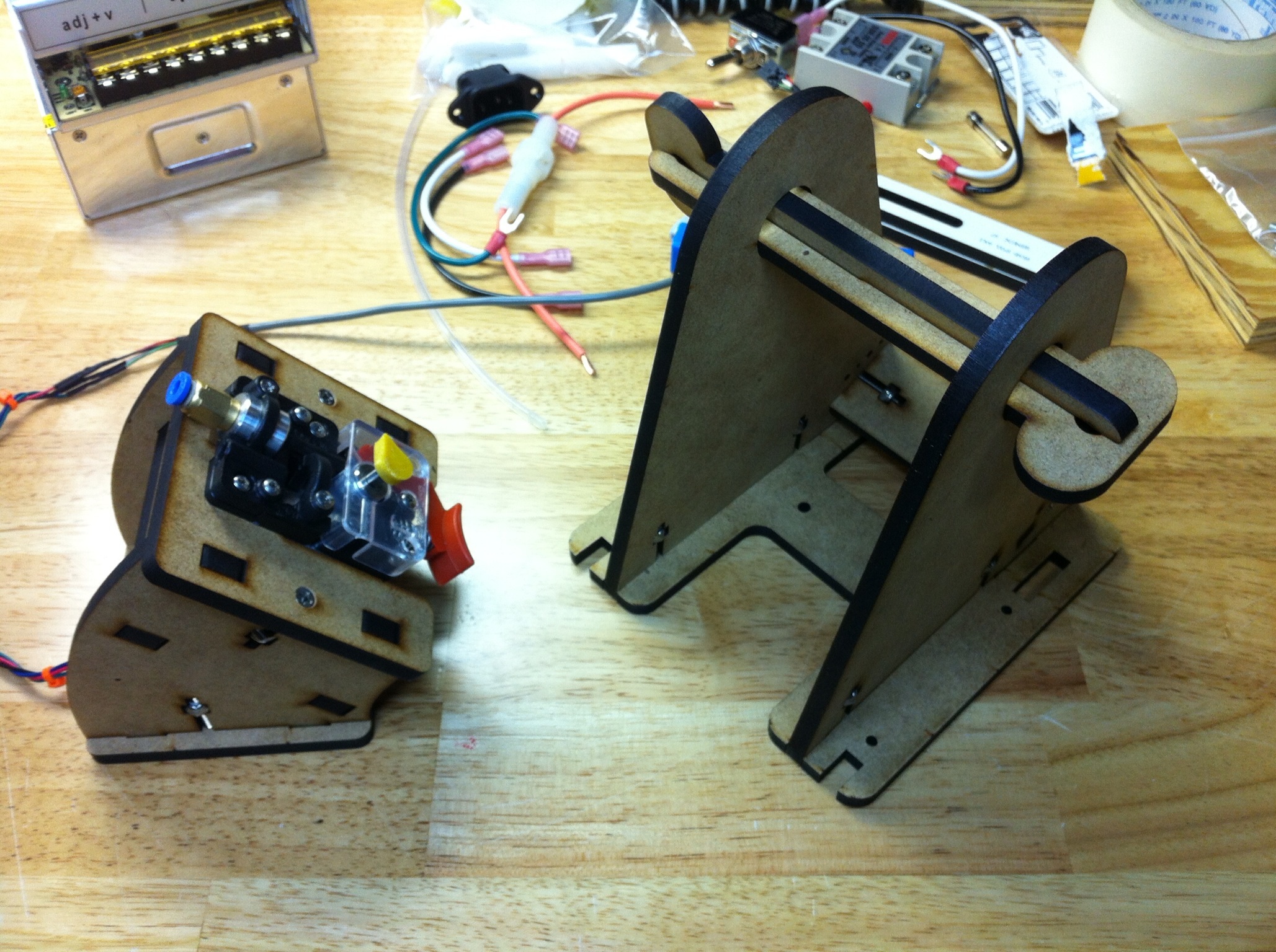

Last week, I took the opportunity to use NextFab's laser cutter to cut a new Tricklaser-designed overhead filament holder and EZStruder mount. The local HD didn't have melamine, but they had 1/4" MDF and I figured these aren't critical dimensional items so I figured I'd give it a shot.
Thanks to Brian for the design. I like not having that stuff hanging off the side.
- dan

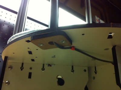

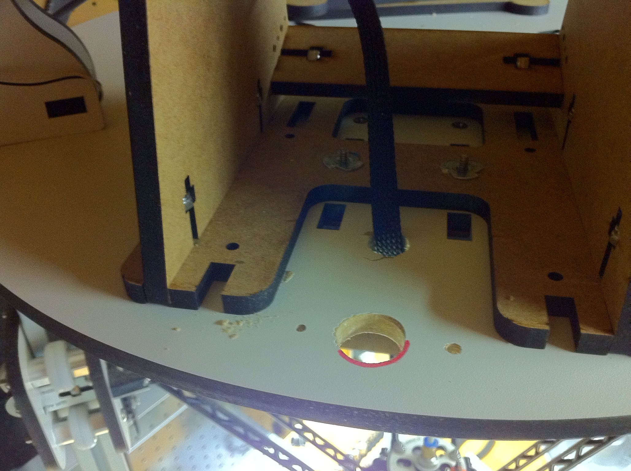

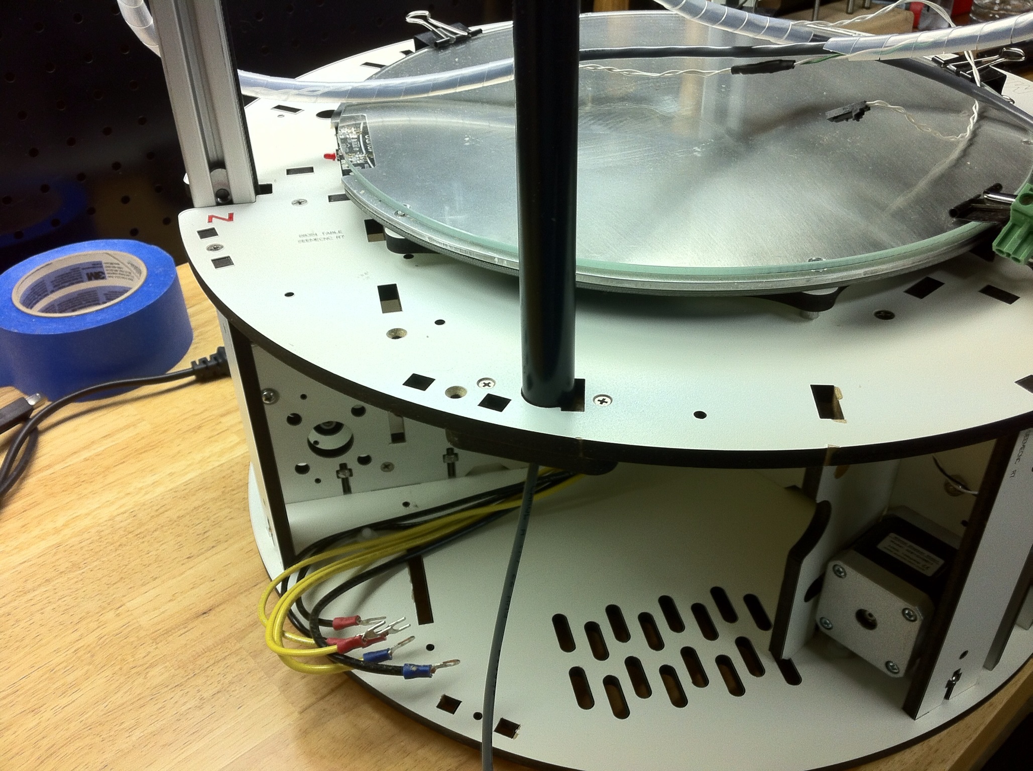

Of course, then I needed to run the extruder wiring up to the top. So I got a piece of plastic tubing, and made holes for it where the side-mount extruder used to be. I took a couple leftover pieces from the laser cuttings, drilled holes matching the ID of the wiring conduit, and used them as retainers.
Yeah, I know the melamine chipped a bit; it doesn't like forstner bits, not even with a block of wood on the back side of the hole while drilling. At least my countersunk screw holes are clean. :-)
- dan

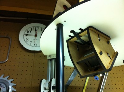

dbarrans
Posts: 273
Re: Dan's Rostock Max
Post by dbarrans »
And here it is back together again.
- dan

Cool! I wasn't going to take on top mounting until I had a cable solution. Without using something other than T-slot, I think you came up with the only other thing that would work.
That tube also leaves enough room to run wires for....
http://dropc.am/p/KhiI1a

The tube I used has an ID of 1/2", just enough room to allow the 4-pin extruder connector to pass. You could also use some PVC electrical conduit or plumbing pipe, but that's a bit larger, and I wanted to use the smallest tubing that fit. It cost me about $7 + shipping vs. $1.58 + driving to the store.

That tube actually looks pretty good on there. I hope you don't mine me stealing your idea. :)
