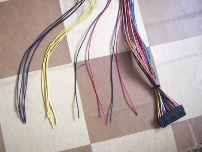

excuse me , i am a new guy from Taiwan
this is first time assembling rostock max kit
RAMBo controlle require four yellow wires and four black wires in the power supply
to provide power to the the Onyx heated bed and the hot-end.

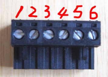

according to the assembly guide the four black wires on the left most should insert into
pin 1 in the black terminal block connector as pictures indicated, and the four yellow wires insert into
pin 2, then a single black wire for pin 3, then red wire for pin 4 respectively , is that correct? any reply would be appreciated

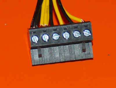

I think you may have an old or bad copy of the guide.
The latest guide can be downloaded here: http://www.geneb.org/rostock-max/Rostoc ... -Guide.pdf
I have enclosed a picture of what the connector should look like after wired properly.
Welcome to the Forum!
Posts: 5359
Re: power supply problem
...and I've never used a red wire. Red wires out of PC power supplies are 5V. :)

judged by the picture from you , i just need to replace the red wire in pin 4 and pin 6 with yellow wire
and it's done, is that right ?
That should be correct. There should be no red wires. Just follow the picture I sent.
