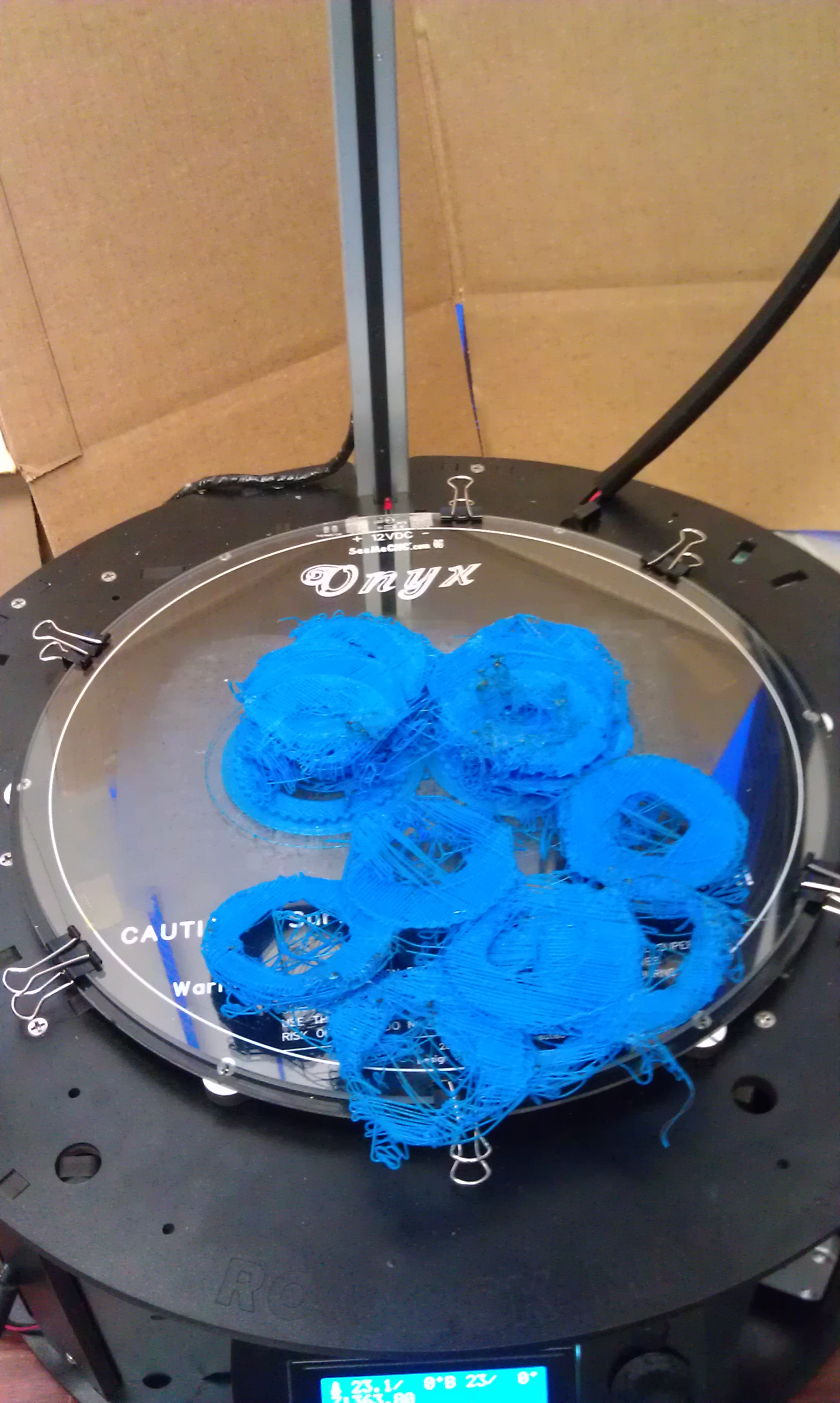

It was a good one... I think it was caused by a tangle in the spool that caused belt skips but then released and kept printing...
Looked pretty fun when I came in this morning.
Not really even that mad
