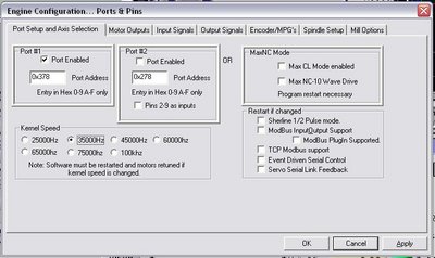

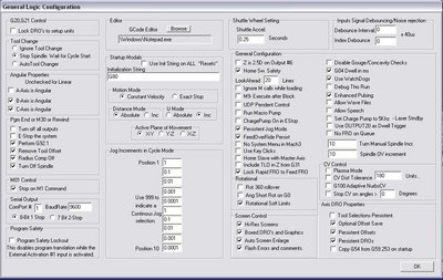

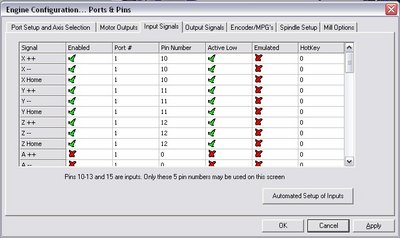

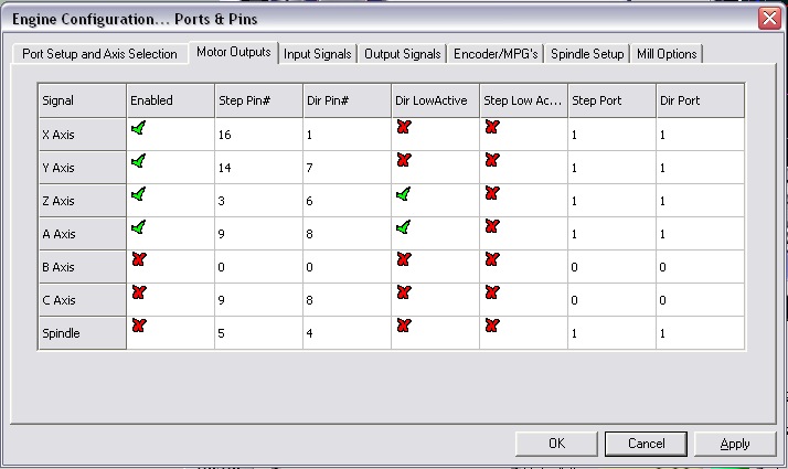

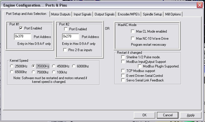

Here is my Mach configuration file for the Chinese 4 Axis (TB6560) boards. These are low cost on eBay and after correcting the opto isolator issue by removing and jumping them, they work great on this machine with lots of torque on X, Y, X AND A.
Note that you will have to unzip the file after downloading - the forum does not allow XML nor would it accept this if I changed the file extension to TXT.
Make sure to setup Mach for Native Units of millimeters. Also, your motor tuning may vary. I am still tweaking my A (extruder) so this one may be off.

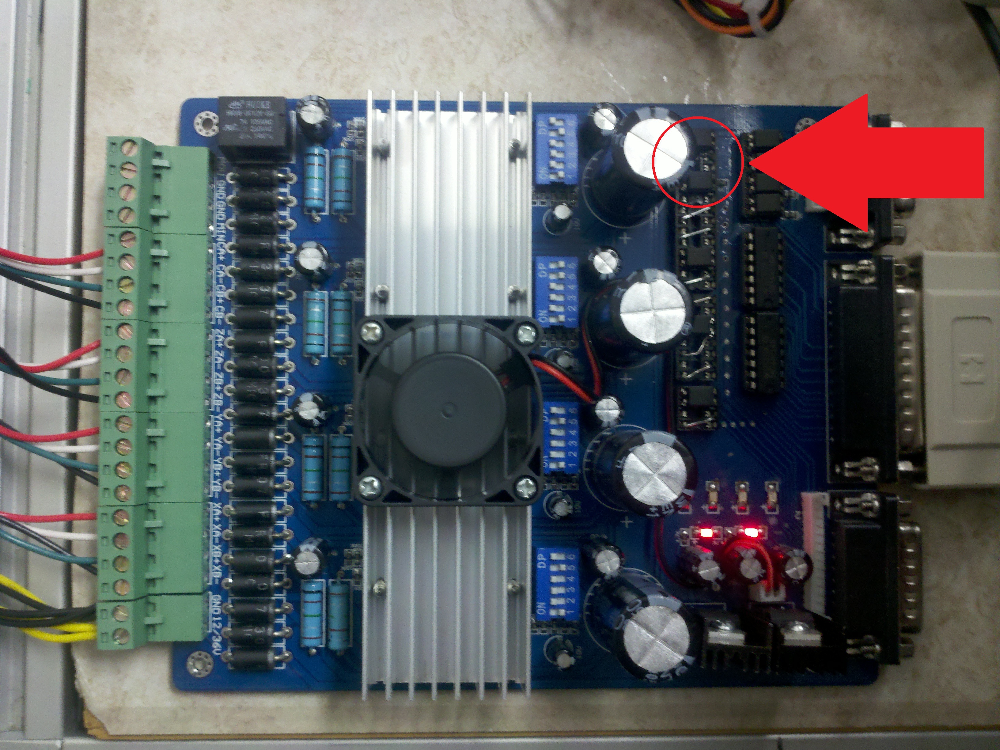

I was wondering about this opto isolator issue on the Chinese drivers. I have been using one of these 3 axis drives for a while now on my mill and have had no issues. Are these issues only experienced when 3D printing or should I consider making the mods on my mill as well?

Tony, there is a LOOOONG thread on these boards over on the CNCForum. Go there and search for the TB6560 (or google it). Even with a mill, you should probably make the changes. I got a 4 axis board and had to make the changes on it as well. It is a design flaw and the opto isolators do not actually isolate! So there is no harm in removing them. Some guys actually fix the problem with additional circuitry piggybacked on. But worse case, you blow your parallel port and have to get a $40 replacement. BUT, I have not heard of a single incident of someone blowing their port after making this mod.
I'm going to use my 3 axis board on a little Sherline lathe I converted many years ago with a now no longer made or supported driver. I want to run Mach on it.

I think it has something to do with the power of your parallel port as well. We had our prototype machines running just fine with the optos installed. However, some computers have weaker power (milliamp wise) ports, and those are the culprits I'd assume in not having the oomph to push through the opto. Also, a reason I think that the 3D printing side of these boards makes this flaw stand out is the speeds at which we are printing and moving our machines. I'd bet it's safe to say you don't rapid your mill at 1200 in./min rapid speeds do you? (that's about 16,000 pulses per second on the P-port) So, maybe with a slower pulse stream because of the slower movements, the missed steps etc... don't happen as often obviously? I agree 100% with mike, go ahead and do it to your mill. You will notice a difference I bet.

It most certainly does! with the weak optos on the board, your motors will "stall" and generally act up as you increase the speed. It's not really the motors or the driver chips, but rather the signal can't travel fast enough through the optos, and it will start missing steps, skewing etc...

Wow, just got round to doing the mod on the week-end and what a difference. When you said I could get more motor speed I was expecting 10 or 20 % at best. I got 110% on X, 90% on Y and a whopping 280% on Z,
Thanks very much for this massive improvement.
One more thing I would like to know is do you have a picture of the mod for a 4 axis board? I would love to get that one sped up as well.

Here's a photo of the 4 axis board with jumpers installed

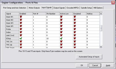

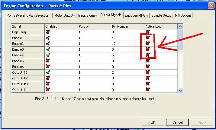

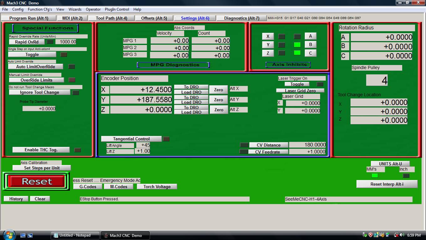

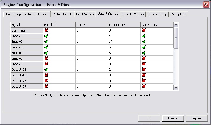

If your motors go 'dead' when you reset the e-stop, check this: Following MHackney's post screen shots above, and specifically referring to the "OUTPUT SIGNALS" tab on the "PORT & PINS" dialog box, you might need to reverse the "Active Low" settings. We had to do this on one of our PC's at SeeMeCNC headquarters. If the 'enable' pin and "Active Low" settings on these outputs are reversed, the stepper will receive power during an "Emergency Stop". Then turn off when the E-Stop is reset. Simply open the "PORTS & PINS" and go to the "OUTPUT SIGNALS" tab. Then reverse the setting under "Active Low" for each "Enable 1, Enable 2, Enable 3, Enable 4).

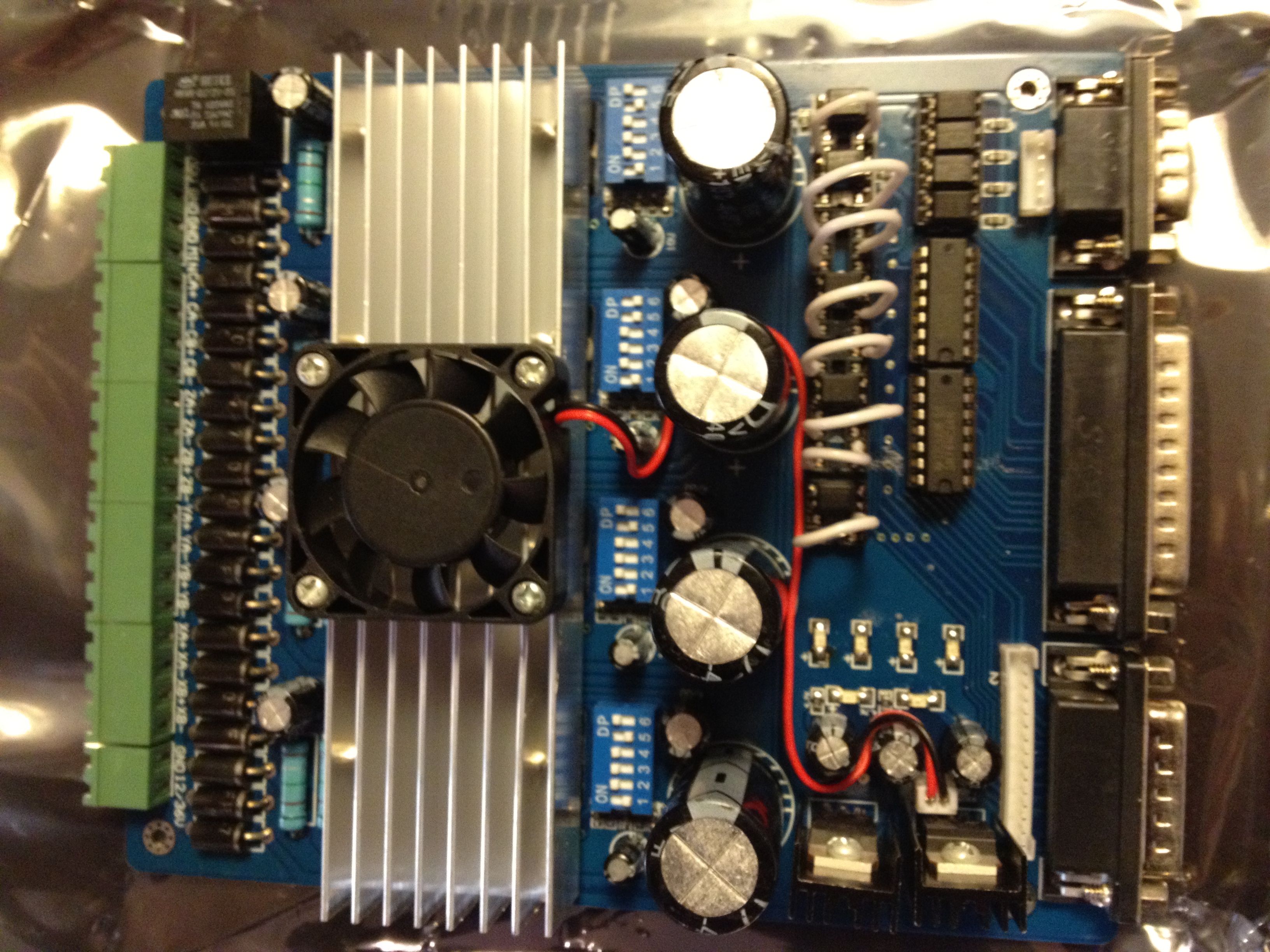

And a photo of the 4 axis stepper control board.
DIP SWITCHES IN THIS PHOTO ARE SET to go with the 'Mach-Loader' Profile above. The A axis for extruder (not spindle) is Slic3r ready! The photo also shows jumpers installed on a HY-TB4DV-M:

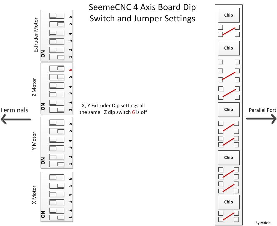

Currently working on the jumpers settings for the 4 axis board. What did you use for the jumpers? Kinda looks like staples. Also wondering what the top jumper setting is, hard to see PIC attached.

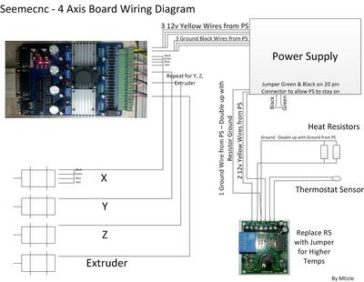

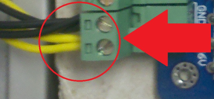

Looking at the 4 Axis board the 12v and Ground terminals have 3 wires connected. Just to make sure I have the correct wires connected they are as follows:
12V Terminal
1 from power supply
2 from Thermostat
Ground
1 from power supply
1 from Heat resistor (Hot end resistors)
1 Thermostat
Pic included
Thanks for any help,
Mtizle
12V Terminal
1 from power supply
2 from Thermostat
Ground
1 from power supply
1 Thermostat
Pic included
Mtizle
Re: Mach 4-Axis Board Configuration
Hey mitzle. John here. You will want to bring 3 yellow 12V lines from the PS and 3 black gnd lines from the PS to the 3 axis board. Run seperate power/ground lines from the PS to the heater board, this will help with any signal interference. The axis board can be "noisy" and running the lines from the PS seems to eliminate this. Also, your hot end resistors ground wire comes back down and doubles up on the thermostat boards ground wire. That's fine. And you should have a jumper from the thermostat board going into the COM (center lug) on the relay terminals, and then the NO terminal runs up to the other side of the heating resistors.
Can you give me a visual example of this? Don't really understand the procedure. Took a look at the thermostat board and I think in my wiring diagram has it this way.And you should have a jumper from the thermostat board going into the COM (center lug) on the relay terminals, and then the NO terminal runs up to the other side of the heating resistors.
Mtizle
Created an updated Wire diagram for the 4 Axis board. Added jpg and pdf files. Wanted to add the visio file also but not allowed. Next will be the 4 axis Jumper and Dip switch settings. Edit Diagrams Verified.

4 Axis Board Dip switch and Jumper Settings Diagram. Settings were taken from photo found on this post by Seemecnc admin. Would it be alright to use solid core wire for the Jumpers? Looks like you used some kind of staple or solid core material. Edit - Diagrams Verified - Went ahead and used 22 gauge solid core wire for Jumpers, added a pic of my finished board with Dip and Jumper settings.

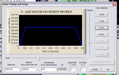

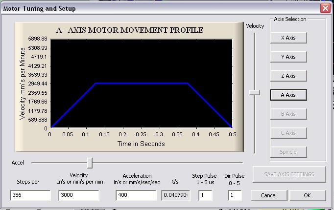

Anyone have a Motor Tuning profile for the Z axis? On the first page of this post are X, Y, and A but no Z.
Mtizle
Mtizle
Ok, Here is my Z Axis tuning. It's been working great for me.
