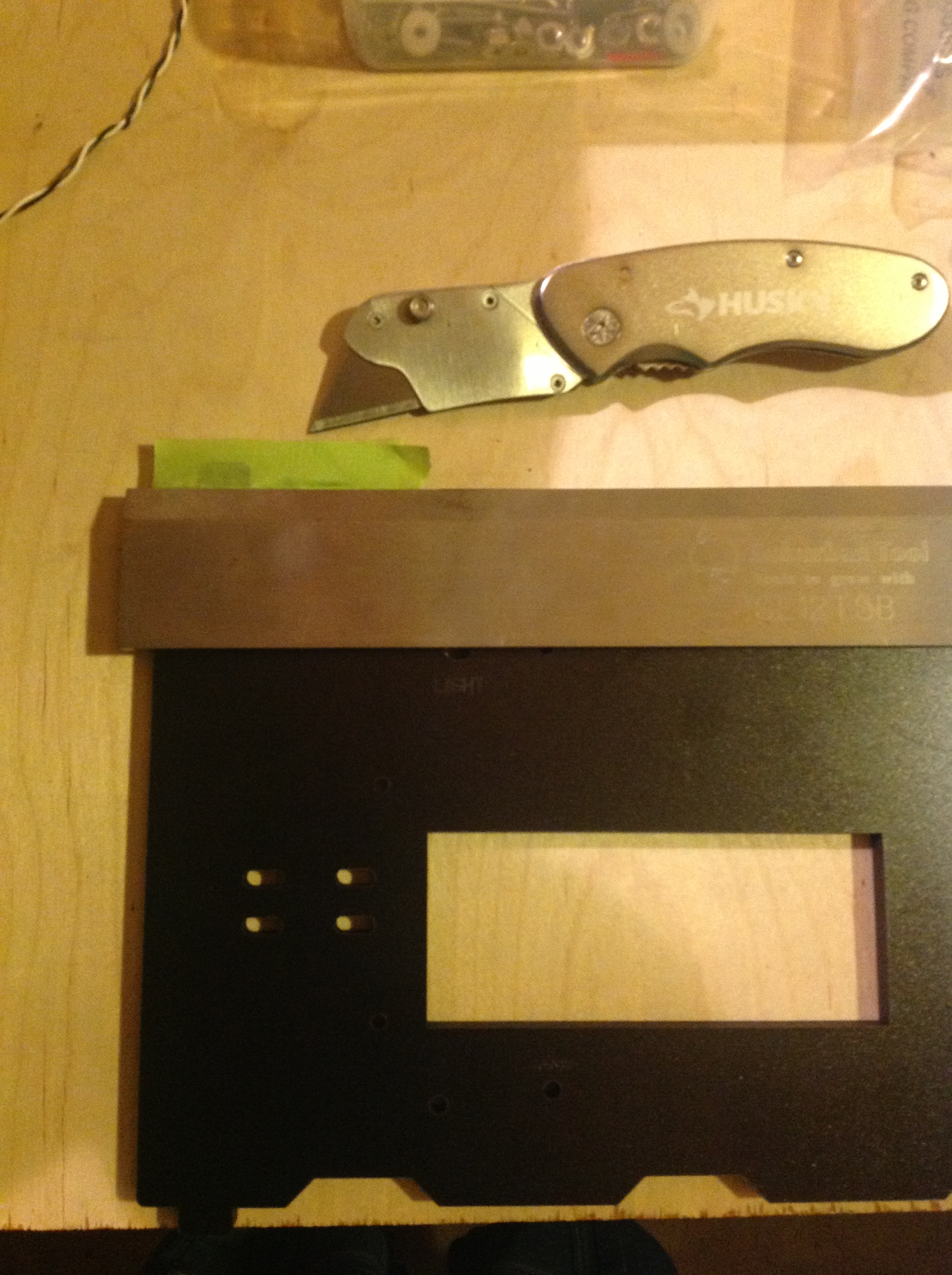

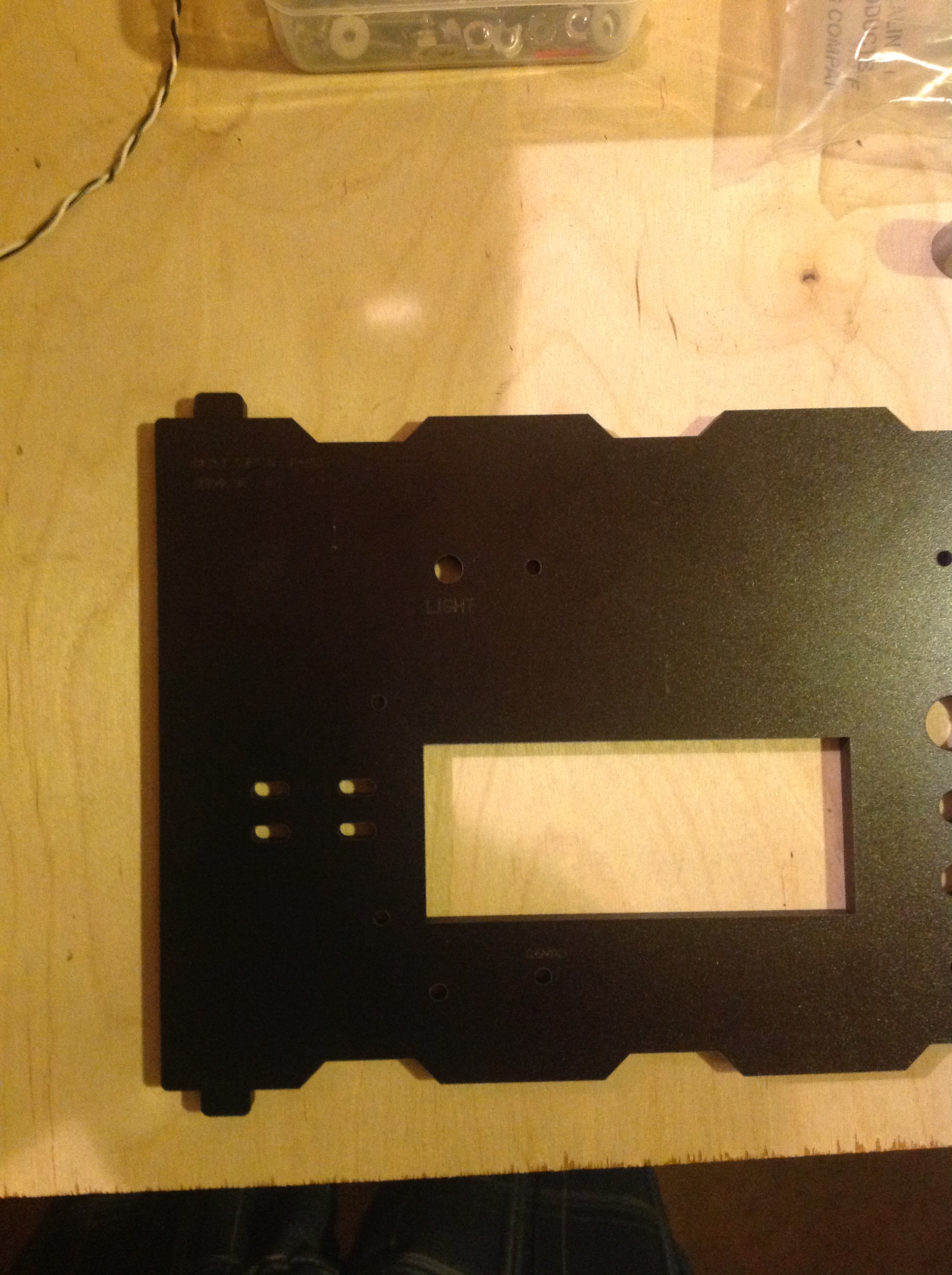

Here is how I modified the Doors:

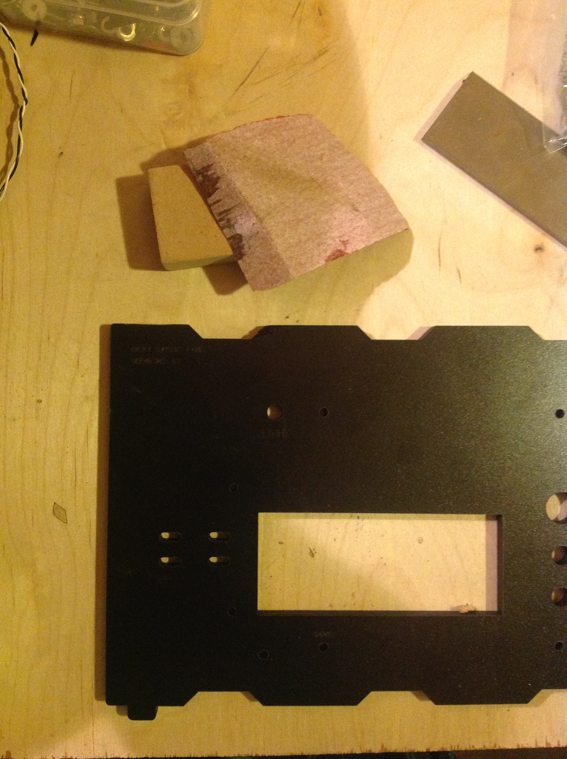

1. Lop the hinge off the TOP of the two doors. (only remove the TOP tab). To do this placed a piece of tape over the melamine to now crack it, took a straight edge and used that as a guide to score both sides then snapped the tab off.
2. Sand the removed tab flat.

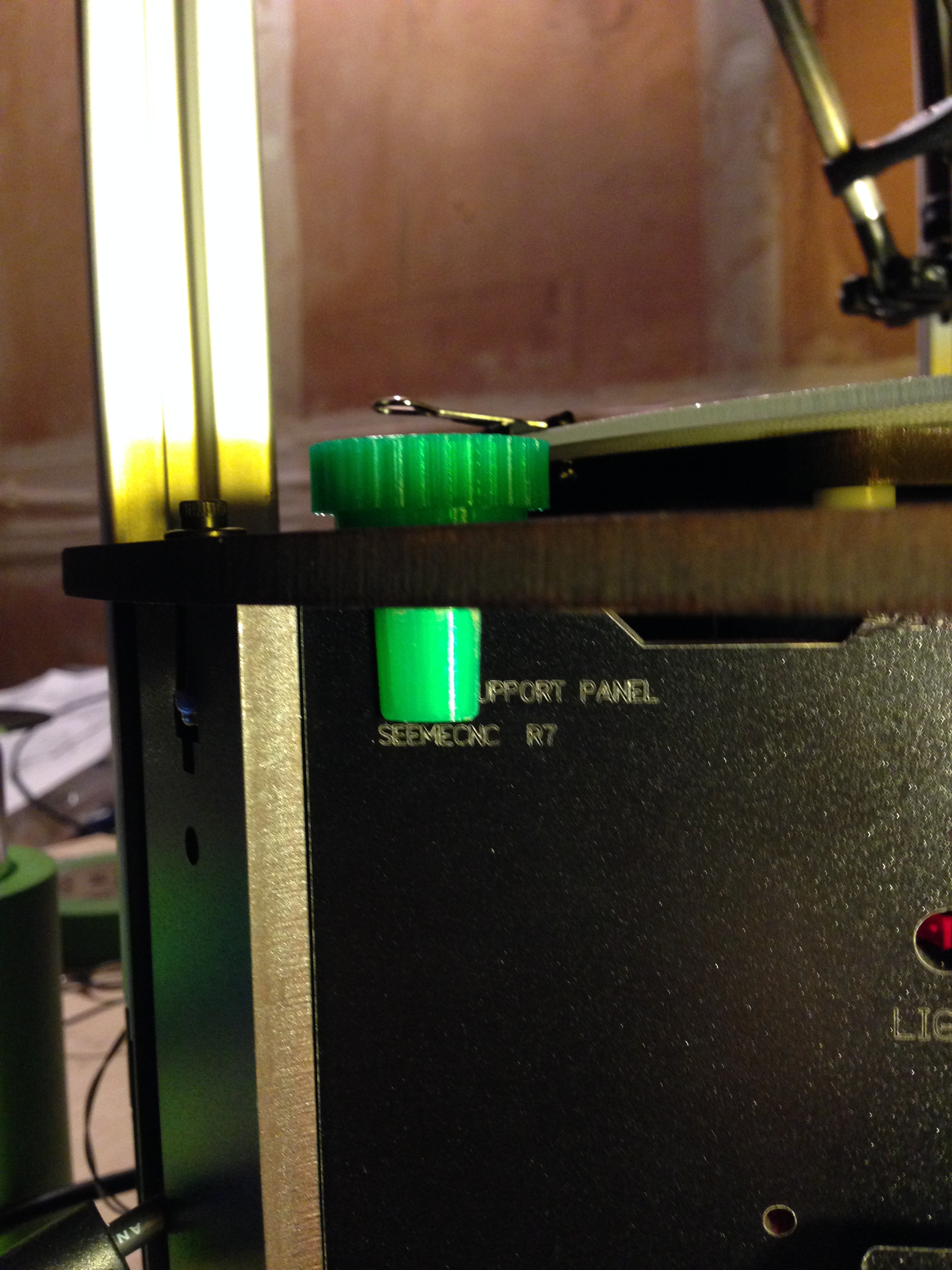

3. Print this file: http://www.thingiverse.com/thing:171424
4. Install door by placing the bottom tab in the hole and then bring the door upright.
5. Install printed door hinge
6. remove door when needed
7. Sit back and enjoy...

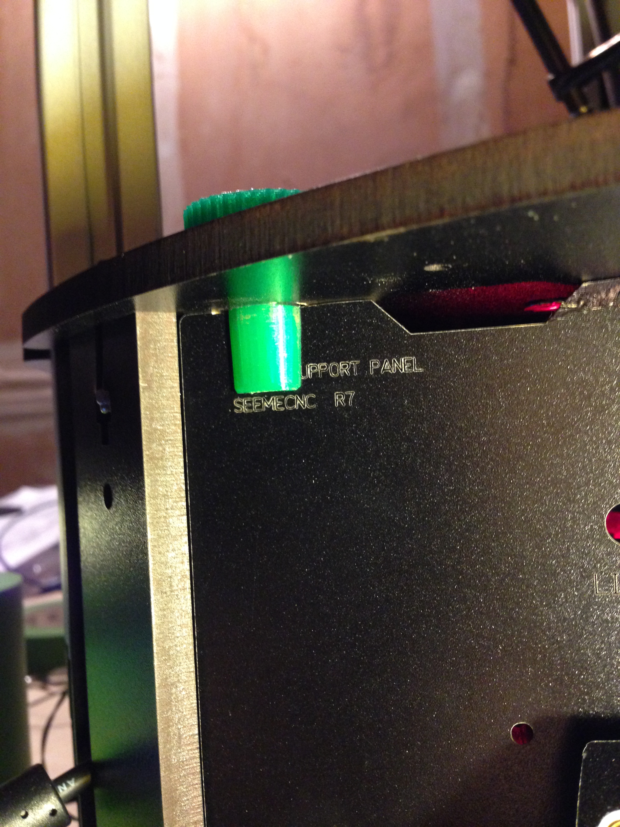

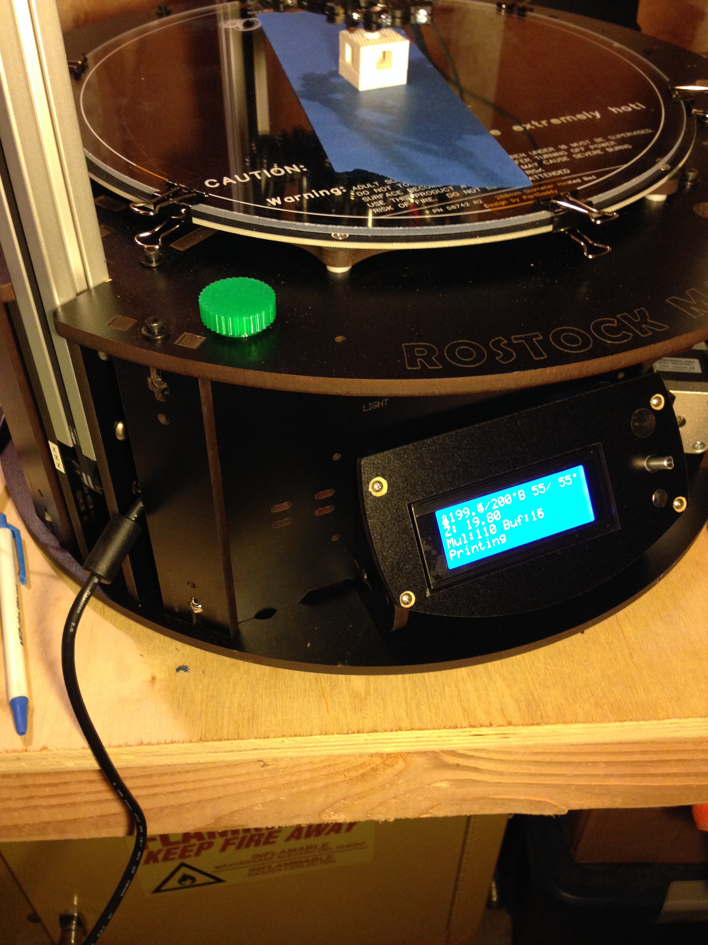

Installed the doors with hinge, should look like this:
I made a grove so removal of the hinges is easily done with a flat head screwdriver.
I had the luxury of not installing the doors prior to this, those who are making this modification after doors are installed are going to have to get dirty and creative with a chisel. should be OK if you are careful and sand sufficiently.
This could also be used on the other side to keep doors closed/locked.
