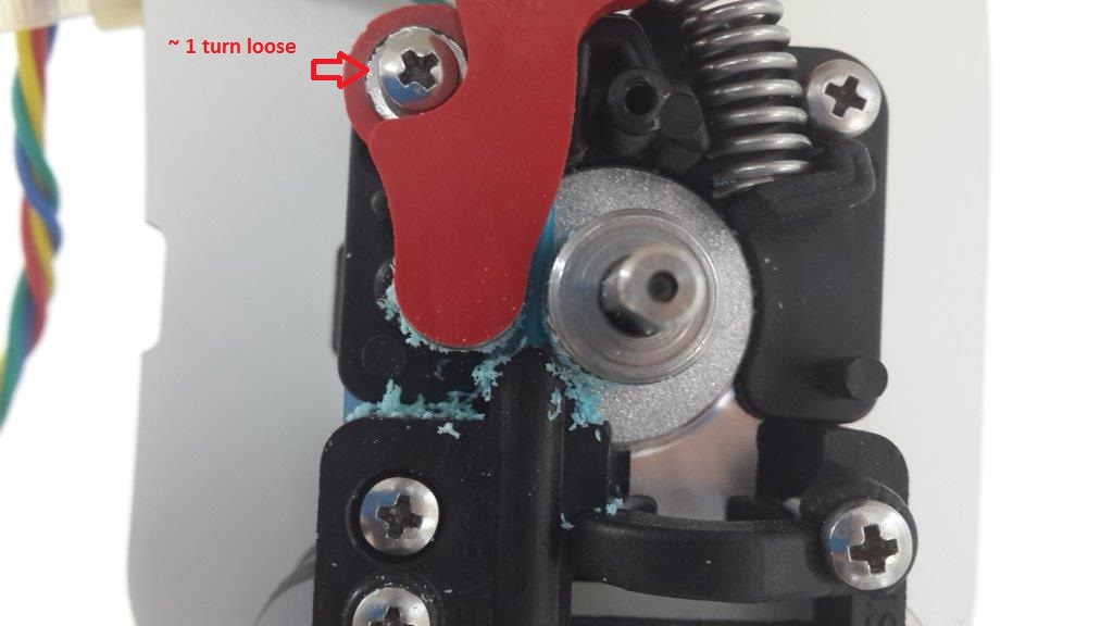

My extruder fills up with abs dust so fast i took the cover off so it would not jam.
Pictured is about half hours worth.
Without the cover the filament dust falls on the print, which i solved with an
abs particle collection device, a piece of paper taped to the bottom of the extruder.
I searched the forum, and found no one commenting. Basically my extruder would not work
with the cover on for a big print.
I have calibrated the extruder via manual/triffid's instructions, 200 mm is within 1%.
Is this dust normal?
If not is it my filament?
Or is my extruder malfunctioning or out of adjustment?
I made no adjustments from how it arrived.
(I did have a BIG problem with the plastic and aluminum pieces being way out of alignment, such that filament would not go through at all.
It is resolved and filament does travel easily through the entire path with the extruder spring lever opened.)

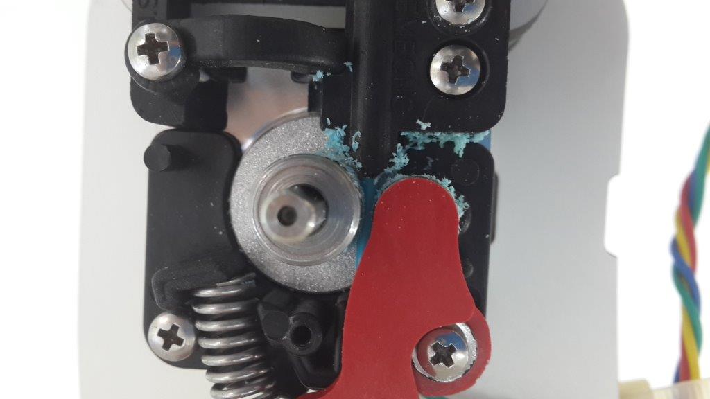

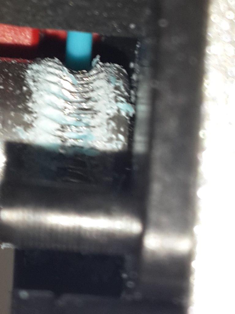

mrbi11
Posts: 94
Joined: Mon Nov 18, 2013 7:18 pm
Re: Is extruder ABS dust normal?
Post by mrbi11 »
Here are close ups of the filament and drive wheel
left
left
right
right
Posts: 5359
The hobb is eating your filament because there's too much back-pressure on it. That can be caused by feeding too fast for the temp or a clogged or partially clogged nozzle.

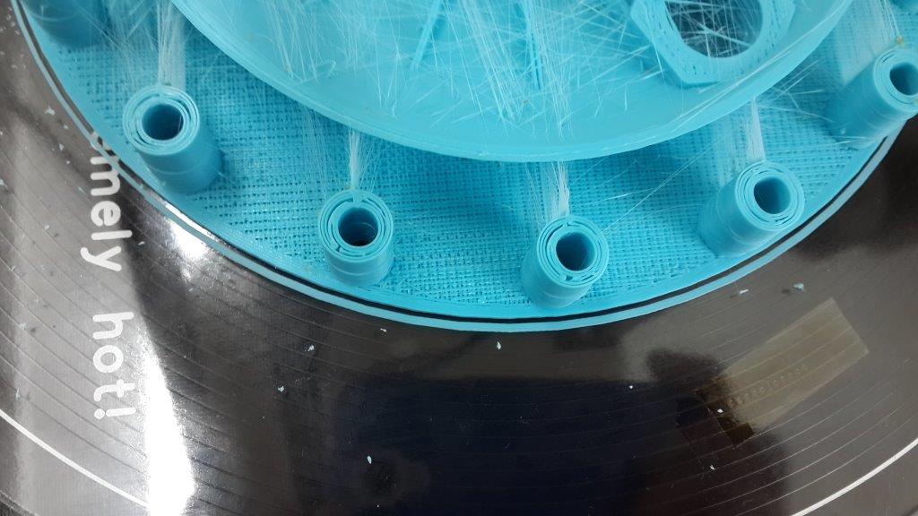

I run ABS at 235 1st layer and 225 thereafter using kapton with acetone/slurry mis painted on and have not problems. No bed heat for 1st layer and then 60c for remainder of the part. I am having problems with the fill around hole circles having gaps in them. The infill leaves the gap holes around the inside of the circle walls. If anyone else has had this problem I would appreciate a tip.
mrbi11
Posts: 94
Post by mrbi11 »
Yes I do, see pic. IMHO, it is the slicr program putting in insufficient fill in gcode, not a printer hardware issue.

I think I found it.
New nozzle, no change. Cant run hotter.
I noticed the red lever twisted slightly as it opened, and found the screw SLIGHTLY loose.
Maybe a full turn.
Seems improved. Idler well centered now.

For all the fuzz you see accumulate in the shield, there is more built up in the grooves of the feed wheel. For me, the problem slowly builds from the first slip, gradually clogging all the grooves. I agree completely with Lochemage as to the resolution and would only add the longer it goes on without cleaning the grooves out the worse it will get.
