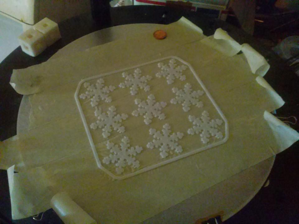

I'm messing around with the calibration cube. I was running the hotend at 230 deg and the bed between 40 and 60, I'll try 90 in the morning. I have used tape, hair spray, and the glue stick, but i haven't made any abs juice yet. It prints really well if i could just get it to stick, the corners are lifting, but i printed anyway just to see how it would come out. I'm also using an 1/8" aluminum build plate instead of glass because my glass plate was broke during the build.

For ABS, I'd try an 80C bed temp. 40-60 is way too cold.

Thanks, i ended up staying up because i wanted to try it one last time. I used tape and hairspray with a 90c bed temp and It worked flawlessly! I was even able to pull the parts off without letting the bed cool down. I am one happy camper right now, Thank you so much for the help!

Ok so i put my settings to the test. These snow flakes were printed on tape with hairspray and a 230c hotend temp and 90c bed temp. The print time was 30min. Thank you for the help!!!
