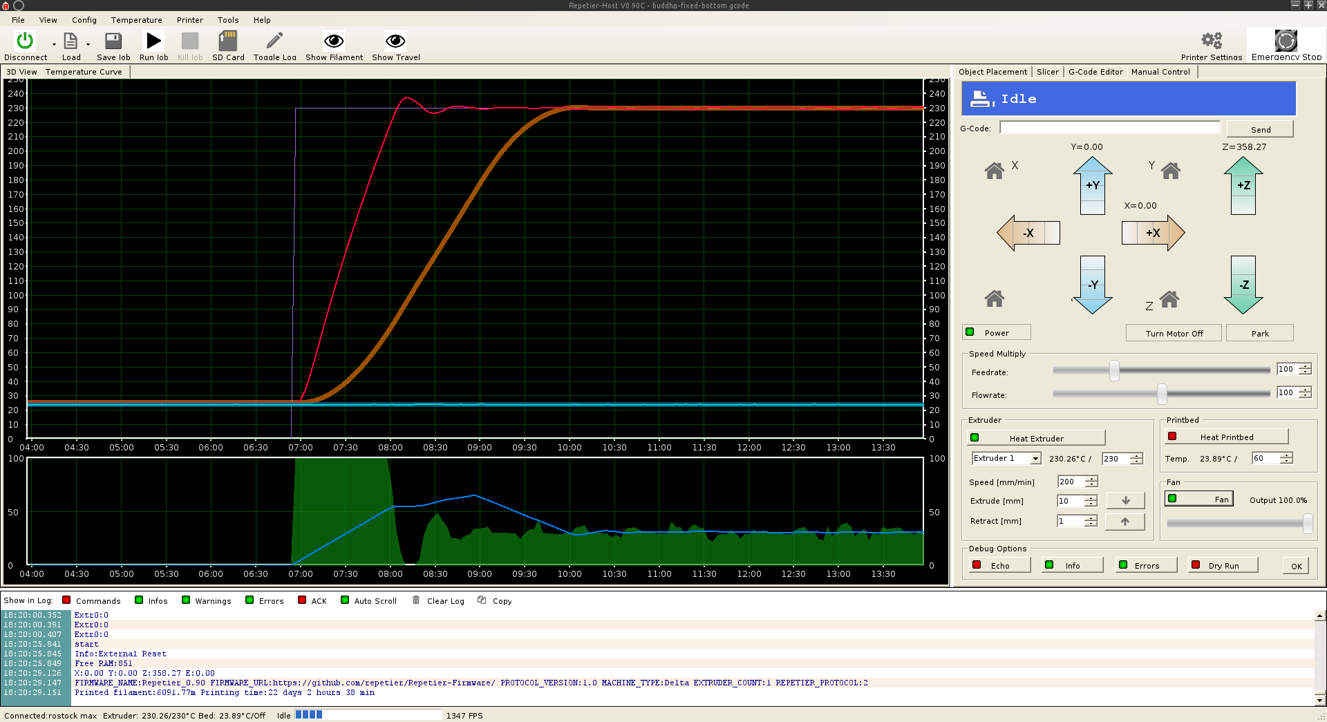

Here's what I would do. COMPLETELY disassemble the hot end, including unscrewing the PEEK from everything else and carefully inspecting it and the PTFE liners. You may find a thin layer of plastic hanging around on the outside of the inner or outer liners (or both.) You can remove that pretty easy as it will be thin and won't adhere well to the PTFE. (Yay for Teflon, I guess.) Make sure that the ends of the liner tubes are completely flat, of equal length, exactly long enough to reach from the top of the inside of the hot end to the nozzle when screwed in, and that there are no burrs. Inspect the inside of the metal and PEEK components and ensure no plastic is hanging out in there either. What happens is that this plastic will swell and increase the feed pressure, and then the cussing starts.
IF:
  • The inside of the hot end and both PTFE liners are clean and free of burrs;
  • The hot end is assembled tightly, with no room for plastic to get out;
  • The nozzle is not clogged and free of burrs;
  • The temperature is correct (might want to verify with a thermocouple, since the thermistor can't be sworn in);
  • The PEEK section is cooled with a fan and shroud;
  • The fan shroud is insulated w/ Kapton tape to prevent it from leaking air down onto the hot end;
  • Your PID loop is tuned well*;
  • Your extruder steps/mm is calibrated correctly; and
  • Your heat is correct for the filament...
...then you should be good to go.
The asterisk for the PID loop is because I don't use the SeeMe hot end anymore. Someone who does can tell you where the duty cycle (% of time turned on) should be in Repetier. That's the lower of the two curves in the Temperature Curve tab. I have an E3D hot end, and when I've had some issue the duty cycle has often been 50-80%. The usual duty cycle is 25-35%. When it shoots up too far above normal, it means something's wrong and you're likely to have critical melt creep sooner or later. The automated PID tuning you get with Repetier is okay but not that great. It produces a duty cycle that looks like an earthquake on a seizmograph. For even heating, it should look more like the profile of a gentle mountain range (see attachment).
I got a lot better at PID tuning after I read this: http://www.pcbheaven.com/wikipages/PID_Theory/ (way more useful than the Wikipedia article)
Repetier also has a "dead time" heat manager that you can elect by changing the heat manager in EEPROM from 1 to 3. You have to be using a newer version to get that feature. Information is here. I don't like it as much as PID tuning beacuse the duty cycle curve can be made a lot flatter with PID.
If all that doesn't work, I recommend upgrading to an E3D all-metal hot end. It can withstand much higher temperatures and has fewer things to go wrong with it. There's a huge thread here if you're interested.

What happens if you heat it up, feed it through by hand, then leave it alone for two minutes and try to feed some more through? Does it require noticeably more force? Also, what happens if you turn off retraction? I've been flabbergasted about how easy it was to feed filament through a hot end, but as soon as it's left to sit still for a short while it gets plugged up like it's been to a chili cookoff. The retraction thing is because sometimes the filament will run through fine, but as soon as it's retracted it'll find a tiny crack somewhere, expand into it, and then it jams.
