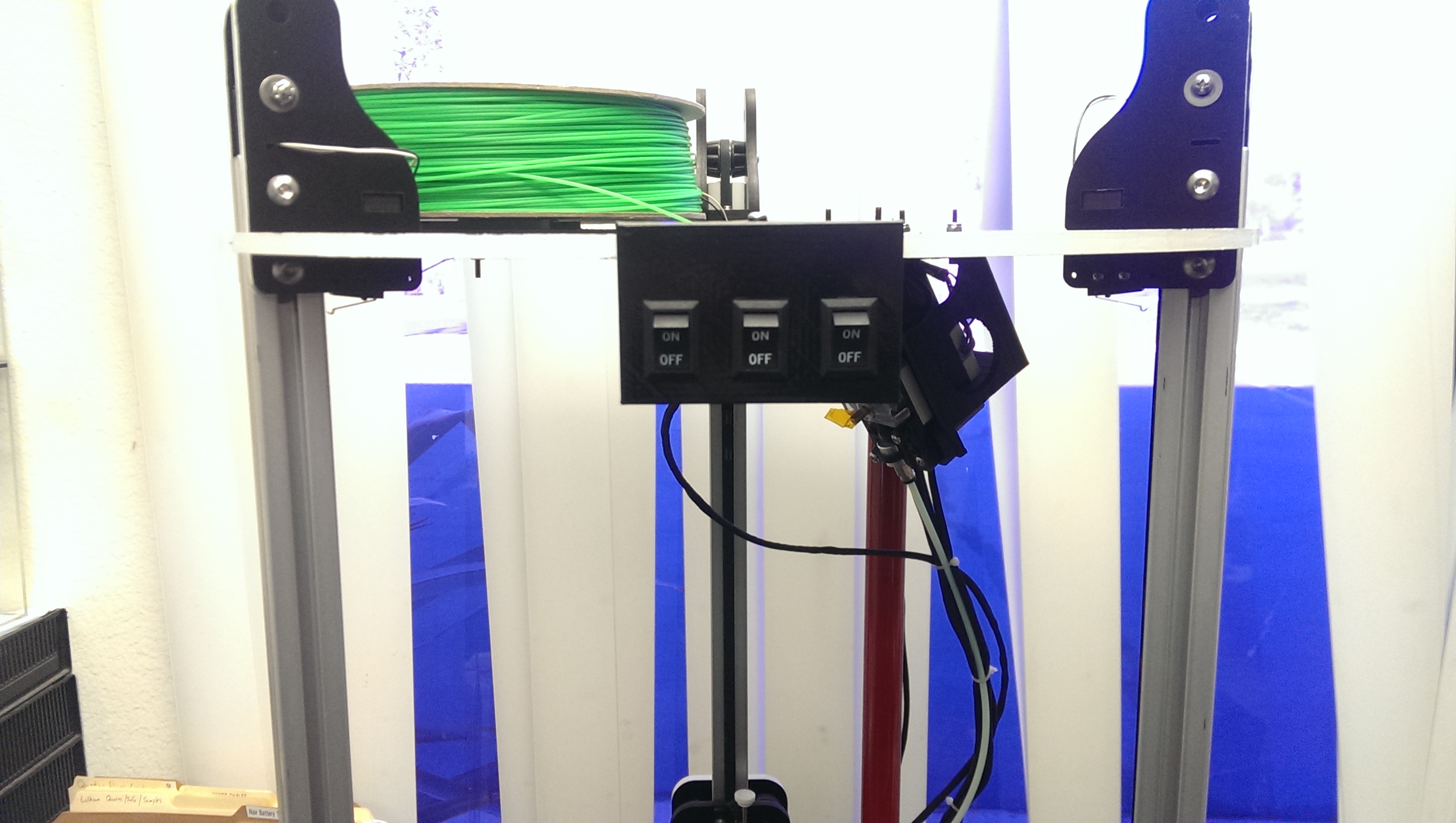

Wanted so share a couple upgrades I've made lately.
First, cooling fans shrouds/mounts. Variations on a theme, but I've had a recent uptick in print jobs in PLA and I wasn't happy with my layer cooling setup - and couldn't find anything I was happy with online, so I designed my own.
In case you can't tell from the pic, they are 40mm x 10mm fans. 12v. They are rated at 5.75CFM. I plan on installing a rheostat to be able to pot them up/down, but that's not necessary right now.
Also, the fans print great without support provided you print in .20mm layers or lower and have decent bridging ability.
I didn't want to use screws, so I just used some RTV silicone to attach them.
I also made a panel that mounts to the top plate for on/off switches for each individual fan
I attached the Solidworks files for any that may be interested.
Really happy with their functionality. I'm printing PLA nicer than ever before.

Nice. Have you restricted your build area to make sure the fans don't hit the extrusions? The seem to stick out pretty far
- Posts: 446
- Location: Orange County, CA
Re: I'm back... and I'm here to show some new upgrades
They can't hit the extrusions
They would hit if the print bed was 285mm, but at 280, free and clear
That tube and bearing upgrade sounds interesting.
That is an E3D you are using for PLA yet no problems. Interesting.
- Posts: 446
Yeah, I really don't know why it has a bad rap for PLA.

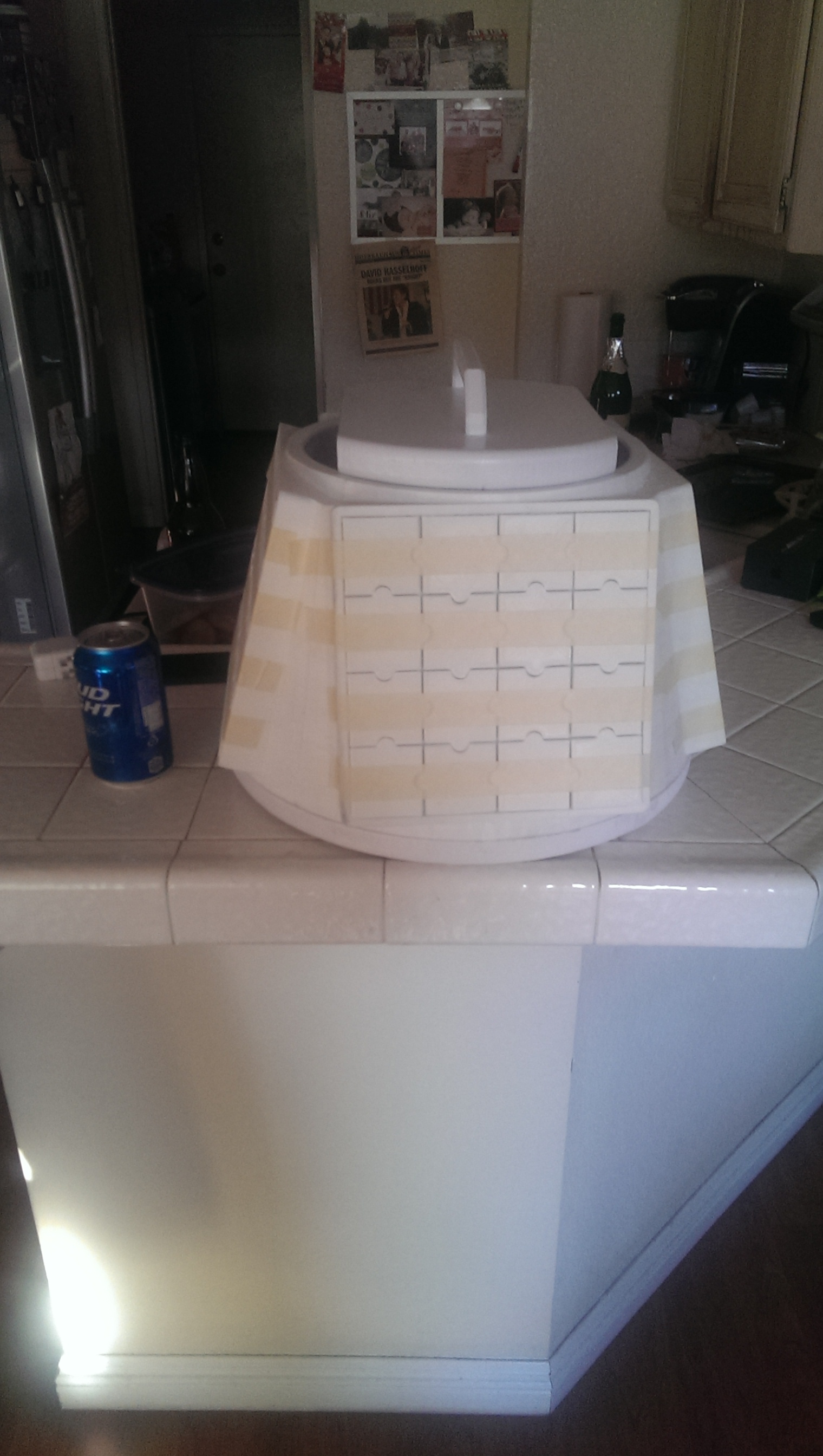

I printed this guy in November for a customer... and I didn't have good cooling fans.
Massive print. Over 6lbs of material. 3 different spools. 75 separate pieces.
Not even the slightest hiccup with PLA.

the iphone and beer can are for size reference

Impressive as the print is, I really want to know what the mystery item is. Unless your customer swore you to secrecy?cope413 wrote: I printed this guy in November for a customer... and I didn't have good cooling fans.
- Posts: 446
Yeah, hah. I was really curious too. It's some sort of board game prototype. Not really sure, but I think it's aimed at kids and has something to do with shape recognition and such. The whole thing spun on a lazy Susan type thing that you can't really see in the picture.
