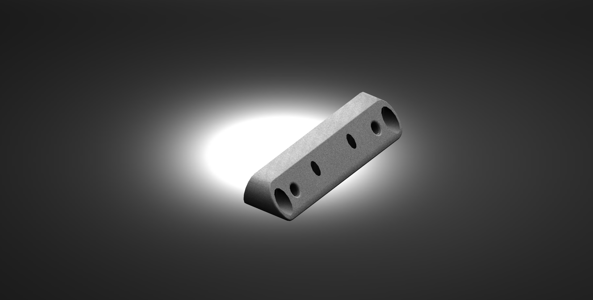

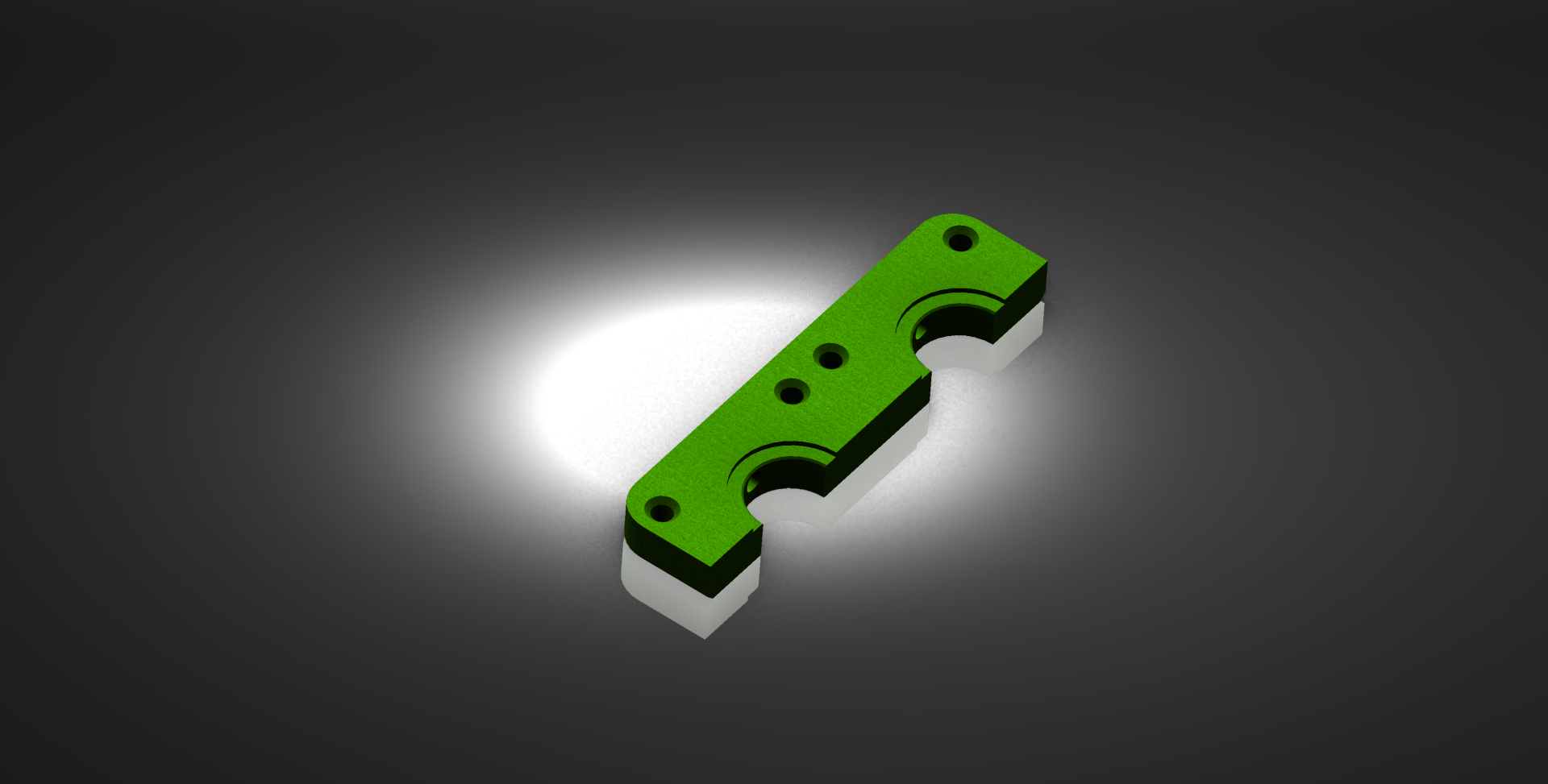

- dual e3d groove mount quarter.STL
- (176.25 KiB) Downloaded 589 times
- dual e3d groove mount half.STL
- (262.39 KiB) Downloaded 543 times
- dual e3d magarm effector.STL
- (1.01 MiB) Downloaded 679 times
- rail mount.STL
- (858.77 KiB) Downloaded 512 times
