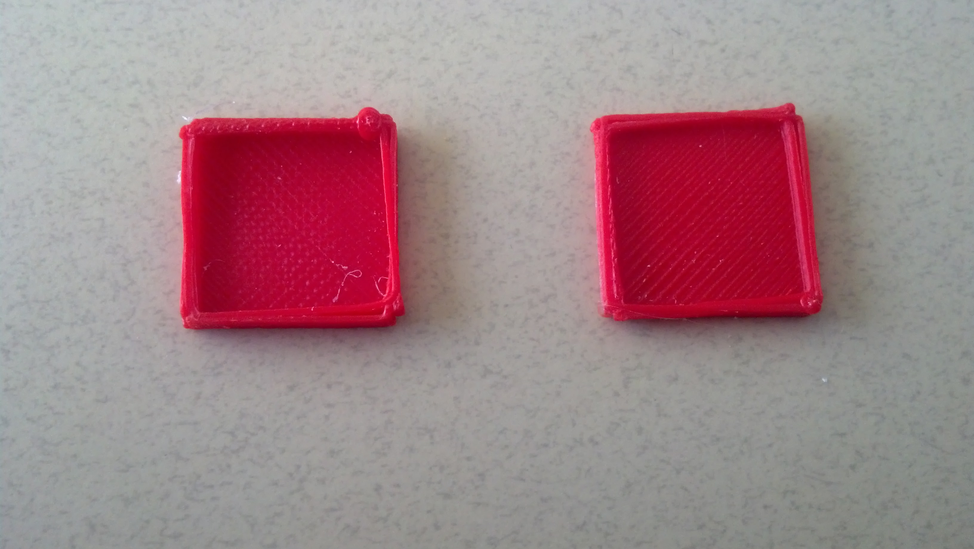

Hi Everyone,
I've been working on trying to get my Orion dialed in. When I run a 20m test cube, the bottom layers look fine, but when it starts to build the walls, they look like they are misaligned. This happens no matter what slicer I use. Attached is an image of what I am seeing. Anybody have any suggestions?
Tom

What kind of filament and what temperatures are you using?

Sorry about that. I was in a hurry last night when I made my post. I'm using ABS at 240 degrees.
Re: misaligned layers
Try running the ABS at about 215-220 and see how it works. At 240C, you're nearly to the thermal limit of the PEEK thermal break in the hot end.

Ok, I changed my hot end temp to 220 degrees on this one. Still getting the same thing. See picture. This is sliced using 1 peremiter shell. I am going to try this again in Kisslicer to see if it behaves differently. This was sliced using Simplify.

it's look like slicer problem, try to print another cube, maybe the stl file have errors....
and btw use G28 at the end of the print, i can see that in the right upper corner the printer sfinish the printing and stay at the same point , G28 at the end of the printing will make your all axis go home as it finish the printhing

So I guess my issue was the slicer that I was using. Kisslicer provided a nice looking test cube. Now on to figure out why my cube is about 1.5mm too small in the x and y direction.
