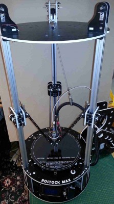

Batteau62
Posts: 389
Location: Connecticut
Re: Bowden Tube Popping Out
Post by Batteau62 »
I don't use a piton and carabiner...I use a retractable badge clip, large fishing swivel and carabiner :)
The bowden isn't actually in the carabiner, just the wiring harness.
