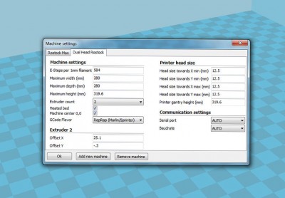

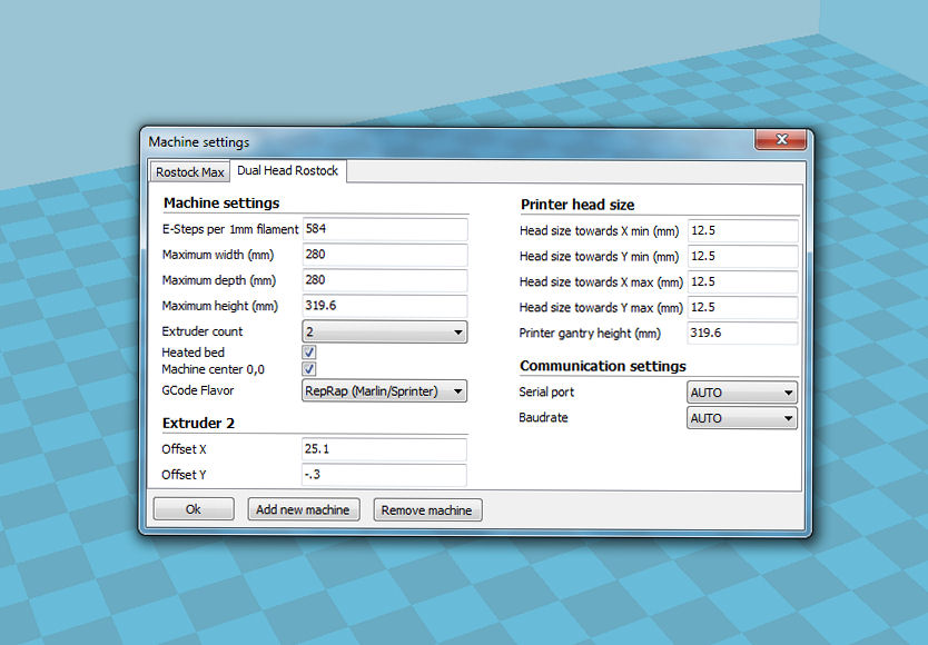

First, I modified my Rostock MAX for dual hotends using the simple adapter you will find here: http://www.thingiverse.com/thing:243270. This is a very simple adapter I designed that takes a lot of the guesswork out of aligning dual hotends (more on this later).
I have recently "upgraded" my stepper motor pulleys from the original 15 tooth design to the current 20 tooth design. On X, Y, and Z this leads to 80 steps per mm of movement compared to the original 106.666... steps per mm of the original pulleys. I think the original pulley "math" led to "rounding errors" that were transferred to the "looks" of printed items. I may be wrong but I believe it is easier to get good-looking prints with the 20 tooth pulleys. Or maybe its a "placebo effect." I dunno'.
I am still running Repetier Firmware 0.83seemeCNC. It has worked well for me so I have not upgraded.
I am using Cura 14.01 as my preferred slicer as I learn to use dual hotends. I also use it when I am using a single hotend. If you want to follow along with the following discussion you might go ahead and download Cura from this link: https://www.ultimaker.com/pages/our-software.
To follow along with this example and use Cura to slice the model (see below) you will need to create a dual hotend machine in Cura. Here are the settings for my Rostock MAX:
After you create your dual hotend machine in Cura download the following .stl file and load it in Cura.

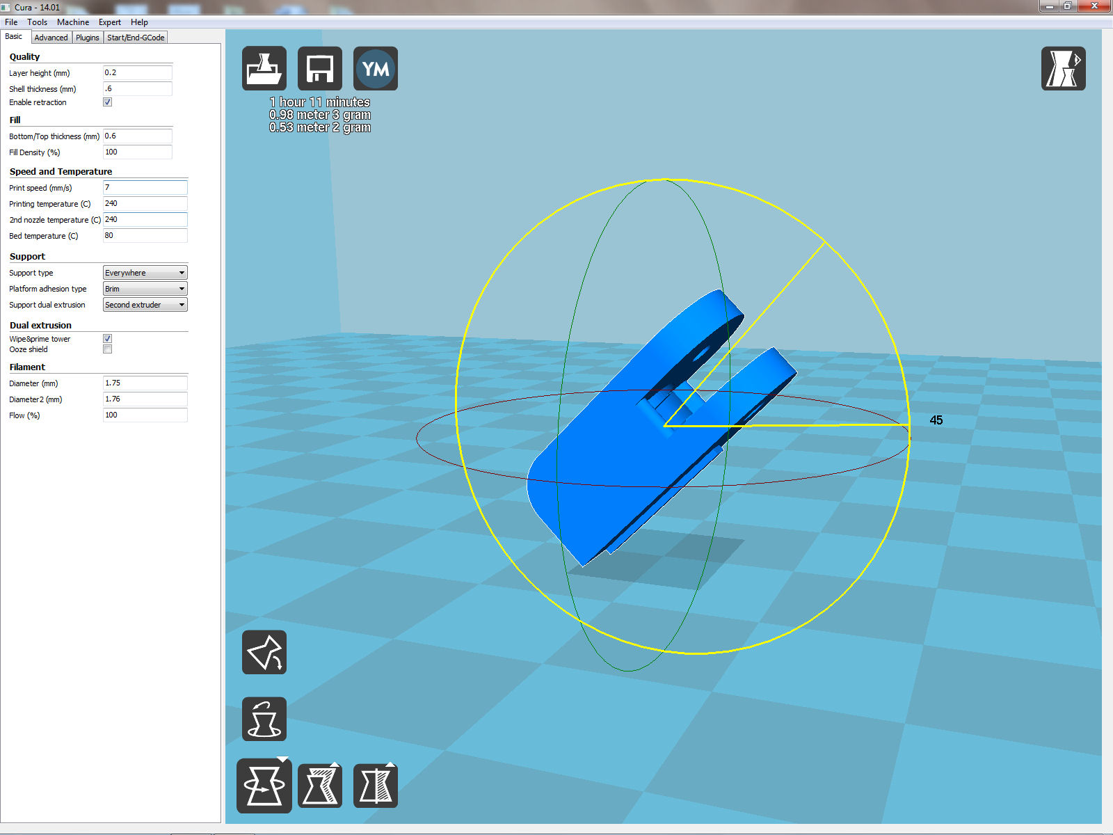

Click on the "View Mode" icon again and this time click on the "Normal" view icon. Then click on the model in the middle of the build area. When you do that a set of icons will appear in the lower left corner of the build area. Select the "Rotate" icon and a set of "gumball" circles will appear centered on the three axes of the model (the X, Y, and Z axes). Click and drag the Y axis circle and rotate the model clockwise 90°. Here is an image of this technique in process:

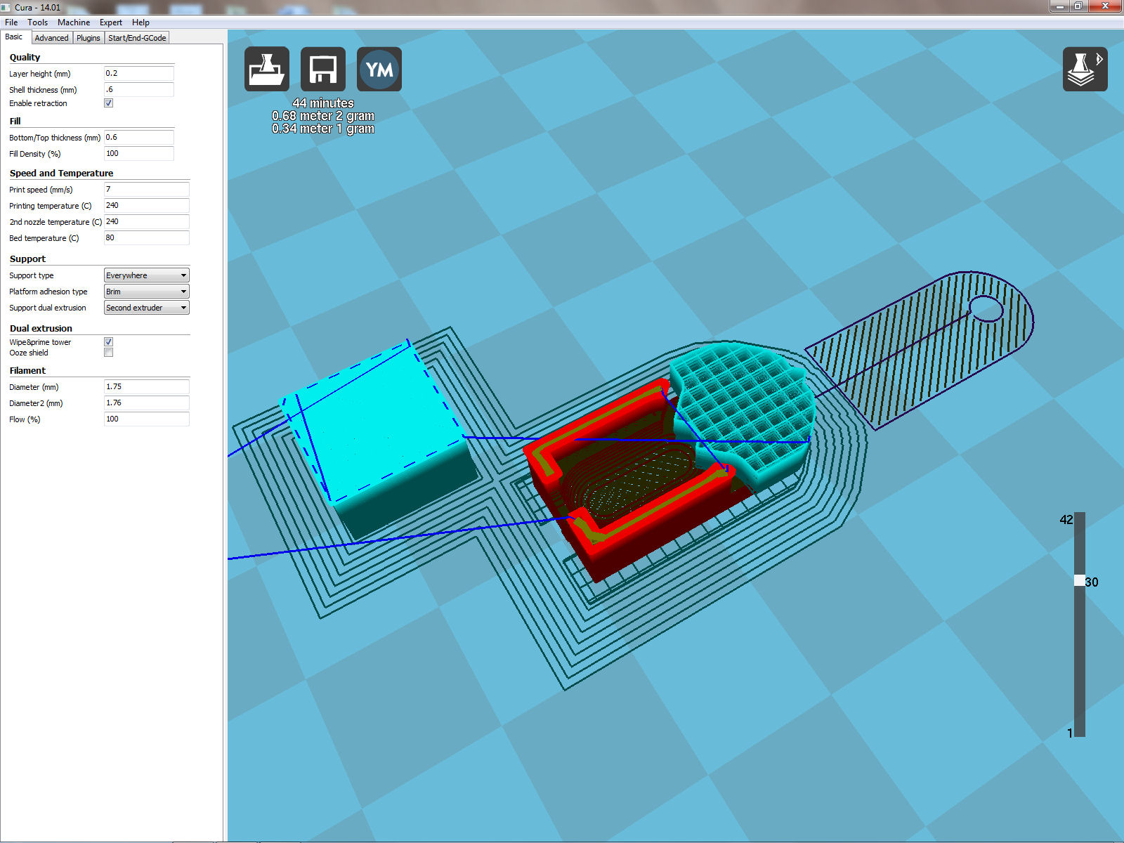

As soon as you release your mouse button Cura will "re-slice" the model. Use the View Mode > Layers icon to view the layers of the re-oriented model. You'll see support material generated on several of the layers.

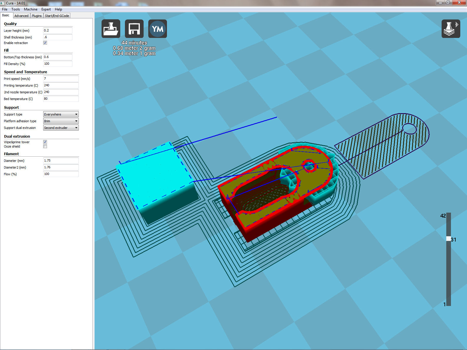

The most troublesome layers of this model are the transition from Layer 30 to Layer 31. Layer 31 presents a huge unsupported overhang (over the horizontal cylinder in the middle of the model). I have not found a way to "force" Cura to build support in that area. So, I have attempted to use the "Plug-Ins" feature of Cura to adjust both print speed and temperature as these layers are printed (see the Plug-Ins Tab in the Cura window to see some of the settings that change as the print runs). Here are screen shots of layers 30 and 31.
You will notice I am using the "Prime and Wipe Tower" in Cura. The name of this feature says it all; when it is an extruder's time to print it first puts down a layer on the top of this tower (it primes the extruder) and then the gcode "drags" both extruders over the surface of the tower (or vice versa - heck, I'm tired and confused). This wiping removes "drool" from the extruder that has been "turned off" and cleans the tip of the extruder that is about to print. After the extruder primes the gcode "hurries" the active extruder to its starting point and it lays down its print layer.
I will quit here and let you study and/or explore what I have done thus far. But first, let me say that the HIPS I am using for support material is interesting stuff. It doesn't "drool" much; ABS drools like crazy! So HIPS seems to be a great choice for two extruder prints where support material is needed but is not laid down frequently.

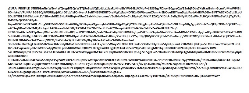

Now that I have slept I remembered there is a big problem using Cura 14.01 with a Rostock MAX (well, really with Repetier Firmware). MSURunner covers the issue in this thread: http://forum.seemecnc.com/viewtopic.php ... ock#p27290.
The Cura Engine is written such that it is easy to share configuration files (or "Profiles" as they call them). These are all of the settings used to print a specific file. The Cura Engine (I think I'm saying this correctly) embeds all of these profile entries as a one-line comment on the last line of the gcode file. It is a very, very, very long line of code and Repetier Firmware doesn't know what to do with it - your Rostock MAX will hang up; I don't remember if it leaves the print nozzle on/in the print, but it gave me the "heebies" when it first happened.
MSURunner may have developed a solution for this (I haven't tried his fix). I simply go into the GCode editor in Repetier Host, delete the last line (the long comment) from the gcode, save the file, and go on with my printing. If I'm tired and forget to delete the last line of code...
So much to learn!
Posts: 5358
Re: Printing With Dual Extruders - My Early Lessons Learned
Bill, are you using 0.95F of Repetier-Host? I ran a file the other day that was sliced with Cura and it finished without issue.
Maybe you're just missing a G28 in the end.code block?

It's not a missing G28. It's that long profile comment stored as the last line of the gcode.
Daid just released a beta of Cura 14.02 (e-i-e-i-o) yesterday(?). And there is some mention of "fixes" that I scanned a few moments ago; I "think" I saw this specific issue addressed.

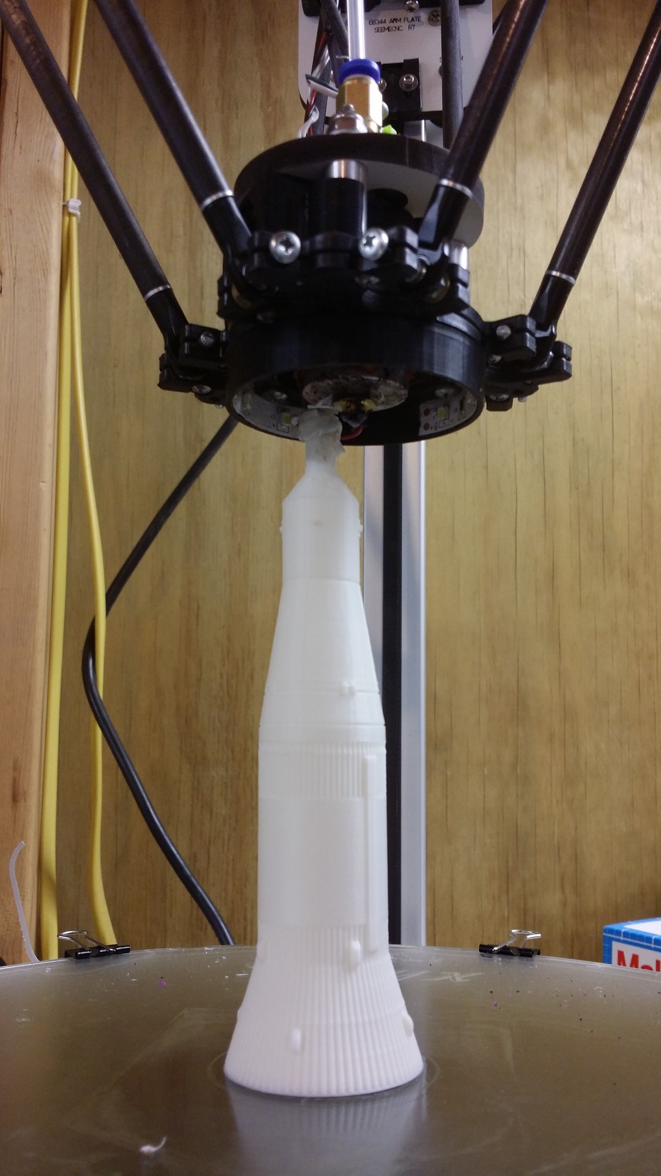

Speaking of Cura,
I had beed using Slic3r but decided to try it. Immediately better prints but there are problems. I was running 14.01 but tried 14.02 RC05 after a bug was found. (If you set your machine to reprap, then add a makerbot also, all gcode flavors after that are makerbot and added to evey gcode, regardless of what machines you choose or if you delete the makerbot.)
In the gcode, it adds that profile data, which when I remove it doesn't cause any problems and my last "end gcode" is a g28. But at random times, after the prints are finished, the printer goes nuts and slams the head down on the prints, and then other times will move to g28, disable steppers, and shut down properly. If I leave the printer on overnight (not printing, and I know this is bad to do) it will randomly run the head back down on the plate at the bed. I think there is something in the code that is being interpreted, run after the code ends. I know it isn't just the machine dropping the effector to the part, because with my machine off, they stay put and don't fall on their own. Something is causing the motors to slam the head down long after the print is finished and the gcode has been run. It happens even if the usb cable is unplugged.
The last time was last night. It was on a 5 hour print job of a scaled up saturn v rocket tip. It destroyed my print by melting the part onto the hotend and ripped the hotend thermistor and one heating element lead out of the end. Unless the effector was powered this couldn't have happened. (On the other hand, the rest of the print was perfect.. lol)
I love Cura for the simplicity and so far it just works for me. But the "Profile extra" and the random slamming is about to end it for me. I never had that problem with Slic3r, just not as good print quality.
The profile code looks like this at the end for those that want to see what I am talking about:

cjdavis618
Posts: 78
Joined: Mon Feb 18, 2013 4:08 pm
Post by cjdavis618 »
Agreed, but it prints so well in comparison. I think I am still going to use it, but make some changes to the code so after the print is done, an emergency reset is triggered to clear out the rambo. The option to add or remove that profile code needs to be in the program. I haven't found a way to automatically remove it as code is posted. I have been editing manually.
I have new parts on the way to fix this and I was already printing parts to go dual extruder. So now that it is apart, why not. :D
With the info you have provided (Which is greatly appreciated) i see no reason not to join the fun.
