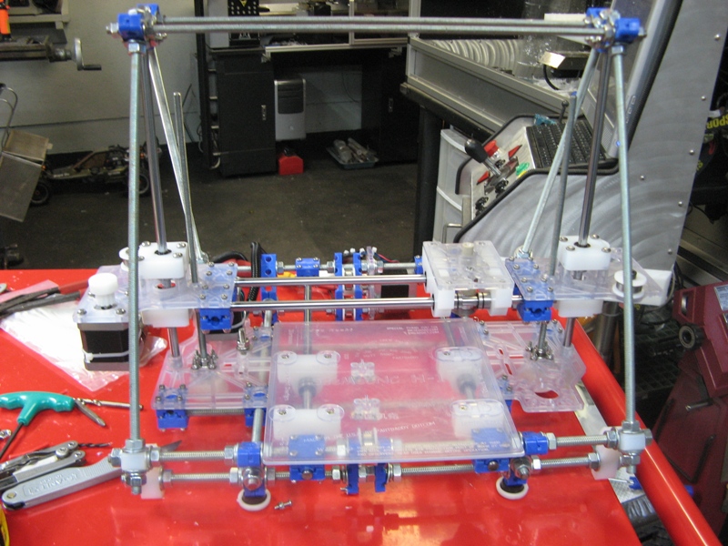

Holy smokes! Michael is already on page 3 I better get on the ball
As promised Dave here are some pics of my progress so far. I am going to finally order some filament tonight as well as the heated bed.

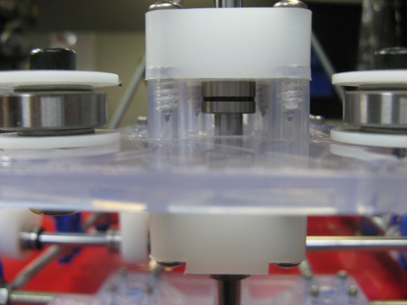

Here is some more

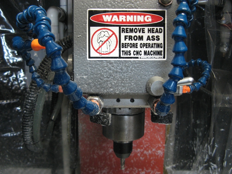

And my favorite warning sticker that stares at me during mill setups

OK JT I believe you now
Looks real good. I have not done my z axis linear bearing mod yet. Trying to get the heated bed going. I have some printing for a job I need to get done ASAP.

On the Z fixed plates instead of turning the 8mm rod down I chucked it into my lathe by the boss and bored it out to 5/16" for a nice snug fit, I aligned it with a .25" drill in the tailstock before tightening the chuck and was surprised at how well it worked! I was sure I would be remaking them out of AL seeing that thing whipping around, but all turned out well.
Some of the flex I see in the frame is coming from those plates, but I think an extra "foot" on each side would serve wonders for that, but I gotta keep telling myself this thing isn't going to be machining metal.

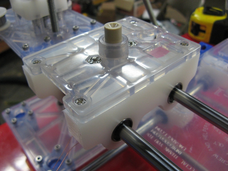

Ok I will try to load a couple of the .stl's Here are the Y and Z bearing blocks, will try to post the X tonight.

First, sorry not to clarify earlier, the parts were machined on my cnc mill not printed. I dont even have any filament yet haha, got some on order from protopardigm. Even picked up some glow in the dark!
The 8mm smooth rods were ordered in 30" lengths (need 3) on ebay from the seller irvineman, (VXB) http://www.ebay.com/itm/8mm-Shaft-30-76 ... 5d303b69f5
The 8MM LM8UU bearings were also purchased from ebay http://www.ebay.com/itm/American-Seller ... 7618555299

Here is the .stl for the X carriage.
