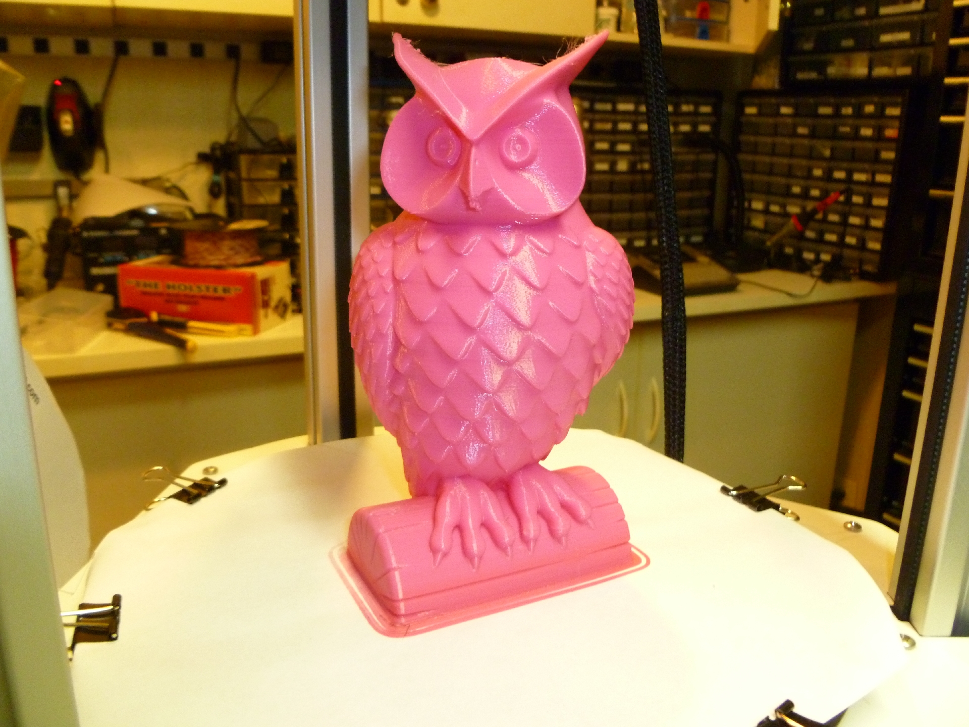

Re: Print PLA on paper...First PLA print
My very first PLA print ever. I have always used ABS but I wanted to give PLA a try.
The owl was done on paper just clamped to the heatbed.
For my first PLA print ever I think the owl turned out pretty good.
It has a few bumps under his beak and some some more bumps and threads on the ears but it came out pretty good.
Temperature was 200c with a 60c bed. I don't know if it is possible to completely remove the "hairs" that show up between
the ears but I will try to eliminate them by playing with the retract and temperature settings.
Tell me what you think of my first ever PLA print. Almost forgot, this was done on the Orion.

That looks really good for a first PLA print! Show it to me when I come this weekend to pick up "the stuff". Was this with the stock hot end or an E3D?

Eagle: Looks very good. I could not get anything to print well until I glued the paper down. Too much viscous drag, but that was before I tuned my hot end.

Stock hotend. I plan on keeping it stock and using the Kraken on one of my RMAX, the other RMAX will be a dual E3D. If I can ever get work on them.mhackney wrote:That looks really good for a first PLA print! Show it to me when I come this weekend to pick up "the stuff". Was this with the stock hot end or an E3D?
I was really surprised how well the paper worked! The owl still has some paper on his bottom.
Any tips on eliminating the "hairs" between the ears, they weren't too bad but I would like them gone.
I got the thin PEI in this morning and will putting one sheet on the Orion, this stuff is about the thickness of the plastic they use for an overhead projector and will cut
easily with a razor knife or anything sharp. It has the 3M adhesive on it so I need to careful not to get any bubbles in it when I put it on. My plan is to put it on and
try a left facing owl with a slightly lower temperature and maybe a small additional retract size plus any tips I can get.

Pretty good looking print for your 1st PLA.Eaglezsoar wrote:My very first PLA print ever. I have always used ABS but I wanted to give PLA a try.

The thin spider web PLA "hairs" are a tuning thing. You can usually find settings that will eliminate them but some PLAs are worse than others. Things to do:
lower the hot end temp 2-3°C at a time, you want to print low enough that this does not happen
speed up the retract if you can, a quick "pop" retract helps eliminate this
use wipe if you have it.
make sure the retract you use is not being "eaten up" by the Bowden setup. I think you know about the stock PTC fittings actually moving up to a mm on a retract
more cooling air directed at the print site can help
sometimes speeding up or slowing down the print at the point of where these occur can help
It's sort of an art to eliminate those!

Good Tips! I have kisslicer and a license for it along with your kisslicer files, I think I can experiment better with kisslicer than Slic3r.mhackney wrote:The thin spider web PLA "hairs" are a tuning thing. You can usually find settings that will eliminate them but some PLAs are worse than others. Things to do:

Thanks for taking the time to write those tips.
