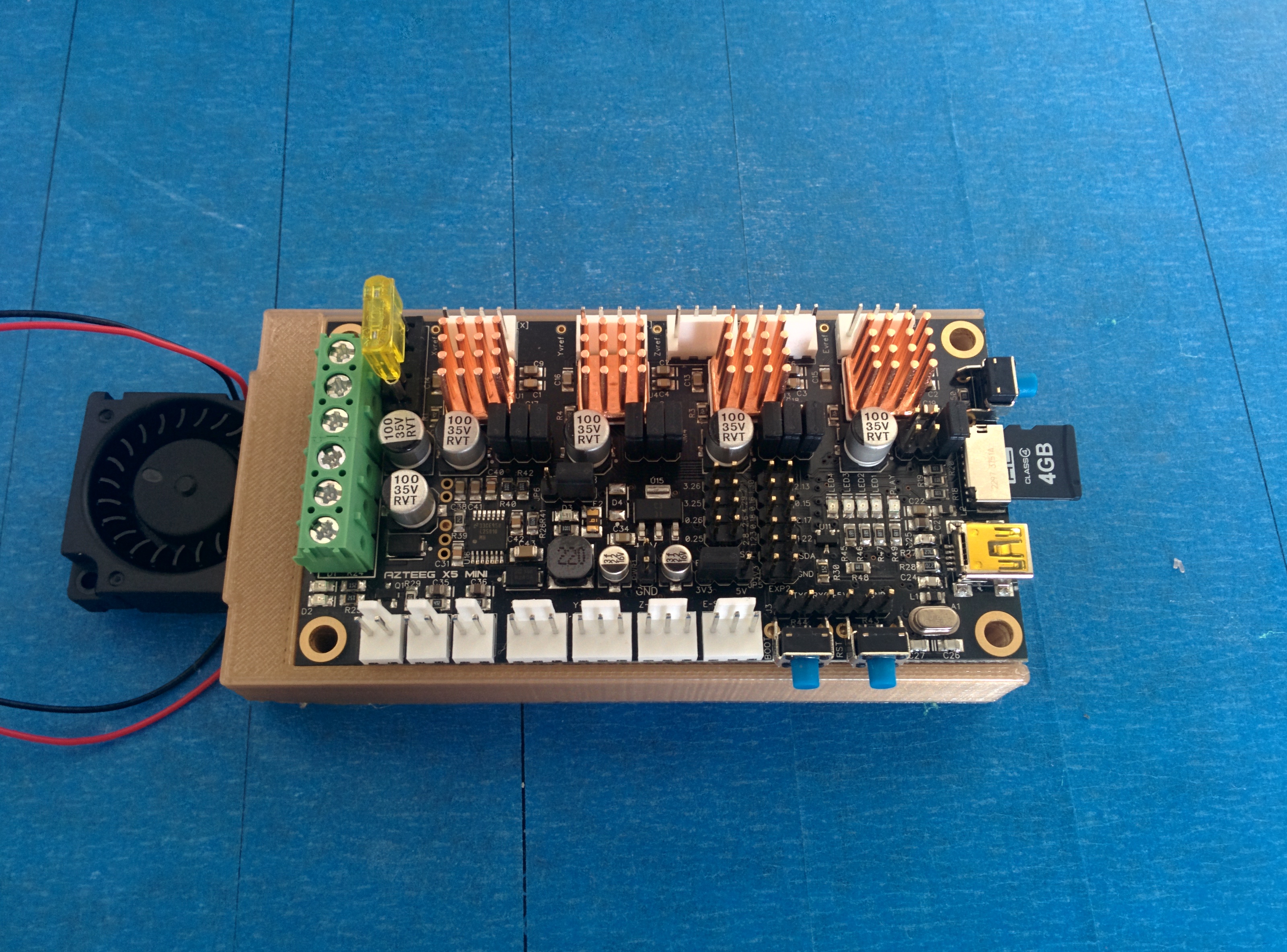

I've been happily printing away since my last post and have been curious to see where printer electronics are headed with newer, faster boards.
I picked up a smoothie enabled board, the Azteeg X5 Mini and am going to be doing a conversion shortly. I've seen a lot of positive reviews of it both on this board and elsewhere. I also really like the IRC community and its dev environment is extremely easy to setup, with easy to comprehend and modify code. Couldn't ask for much more!
I also designed a mount converter for my Arduino holes for the X5, which includes under-board cooling. It's been noted that the heat of the DRV8825s are directed to the bottom of the board and passing air over it is recommended to help keep things cool. Check it out!
I'll be making the mount available on thingiverse once I'm satisfied with it :)

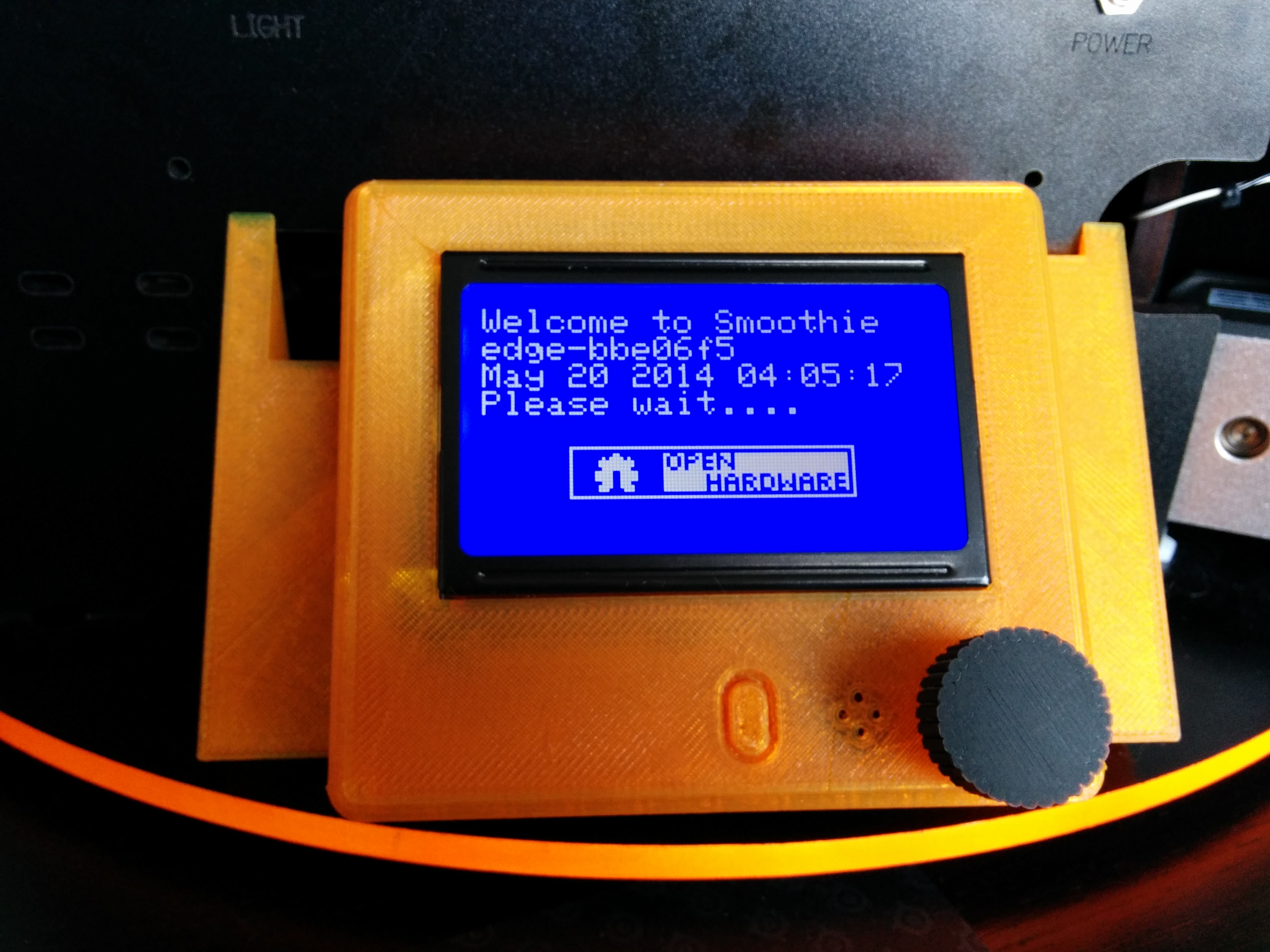

Success!
I also changed my heatsinks so that they lay on the bottom of the board. The folks in #smoothieware pointed out that the PCB is designed to direct the DRV8825's heat to the bottom of the PCB. I modified my mounting bracket to support this as well.
