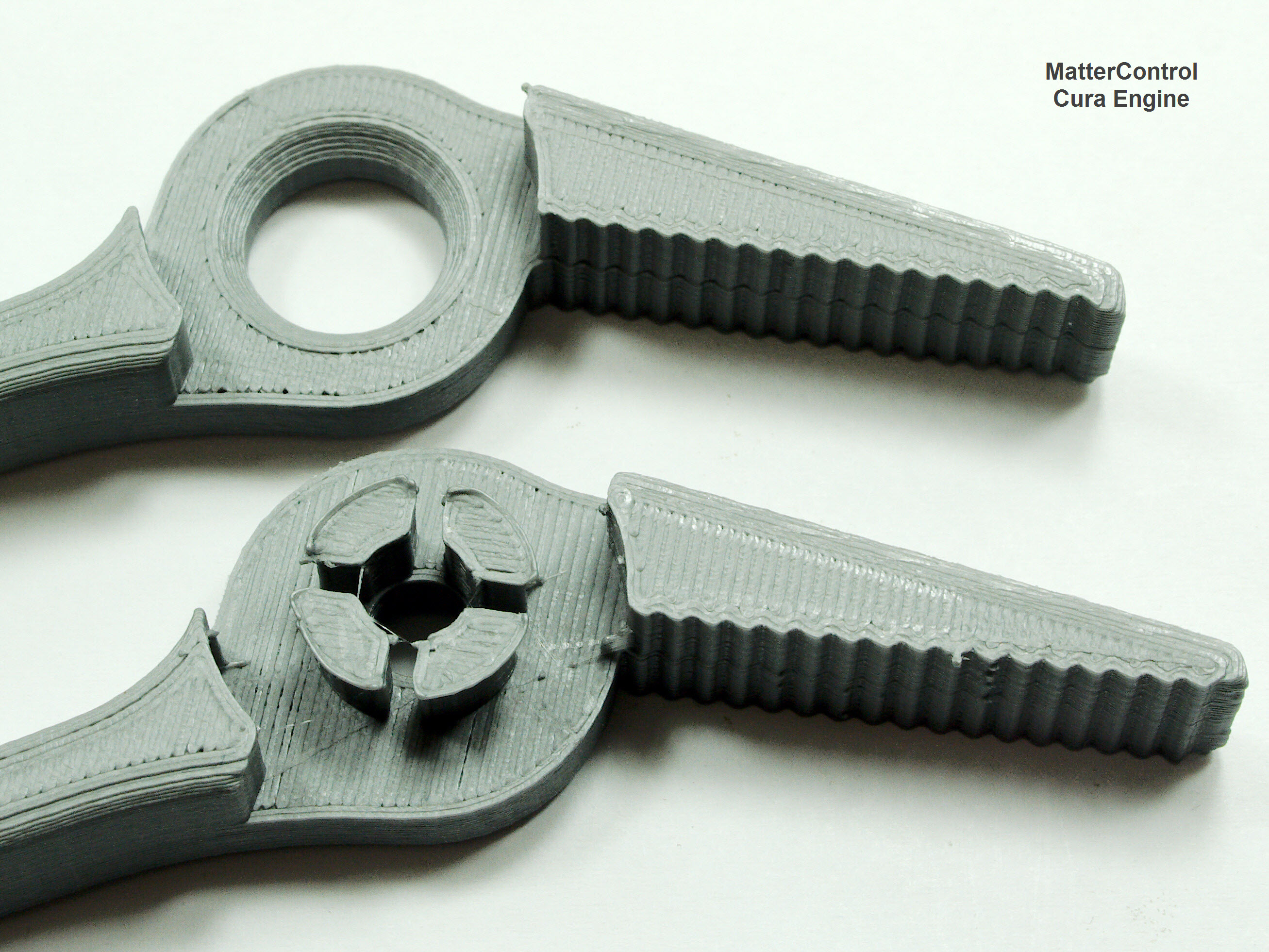

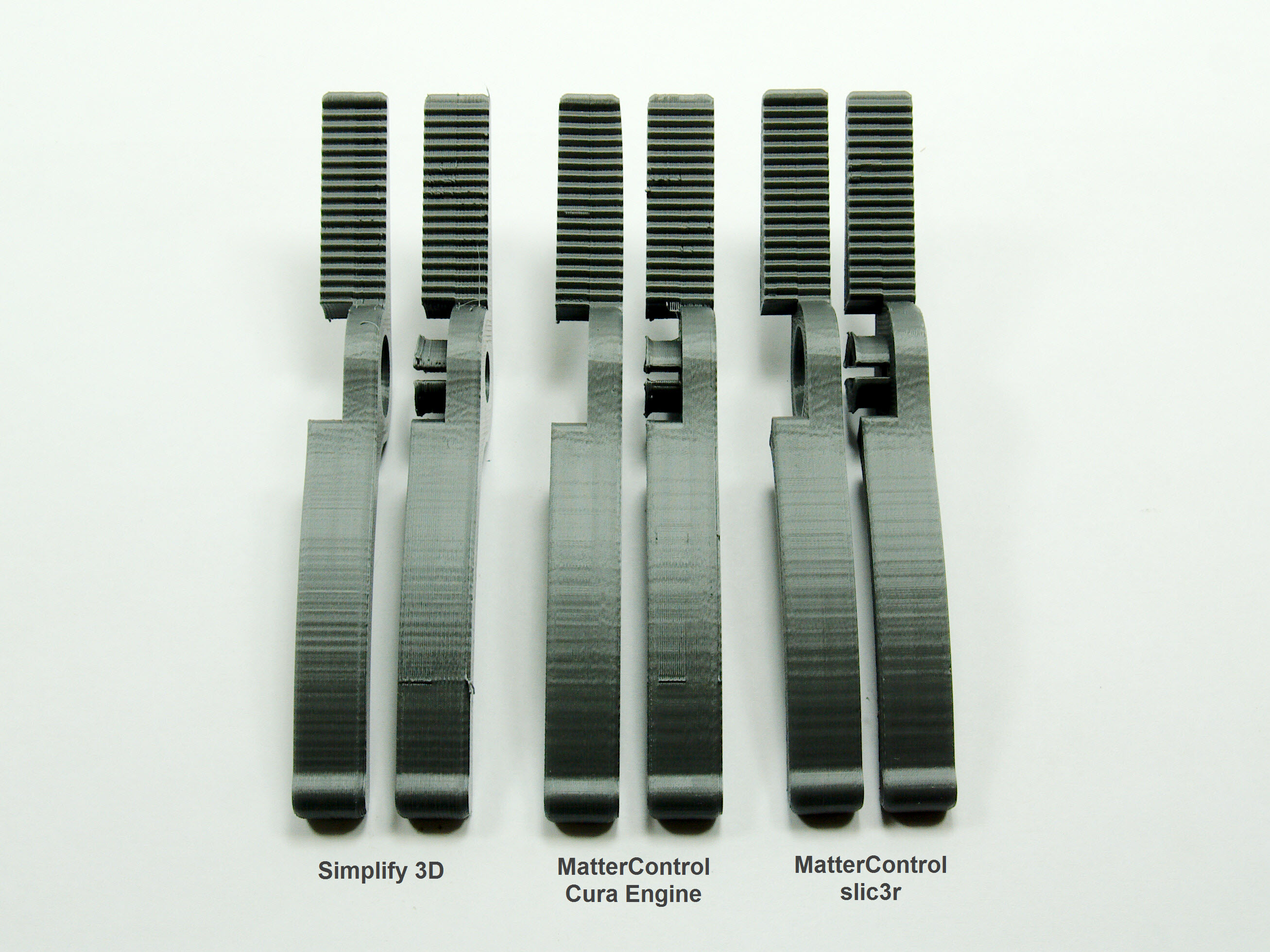

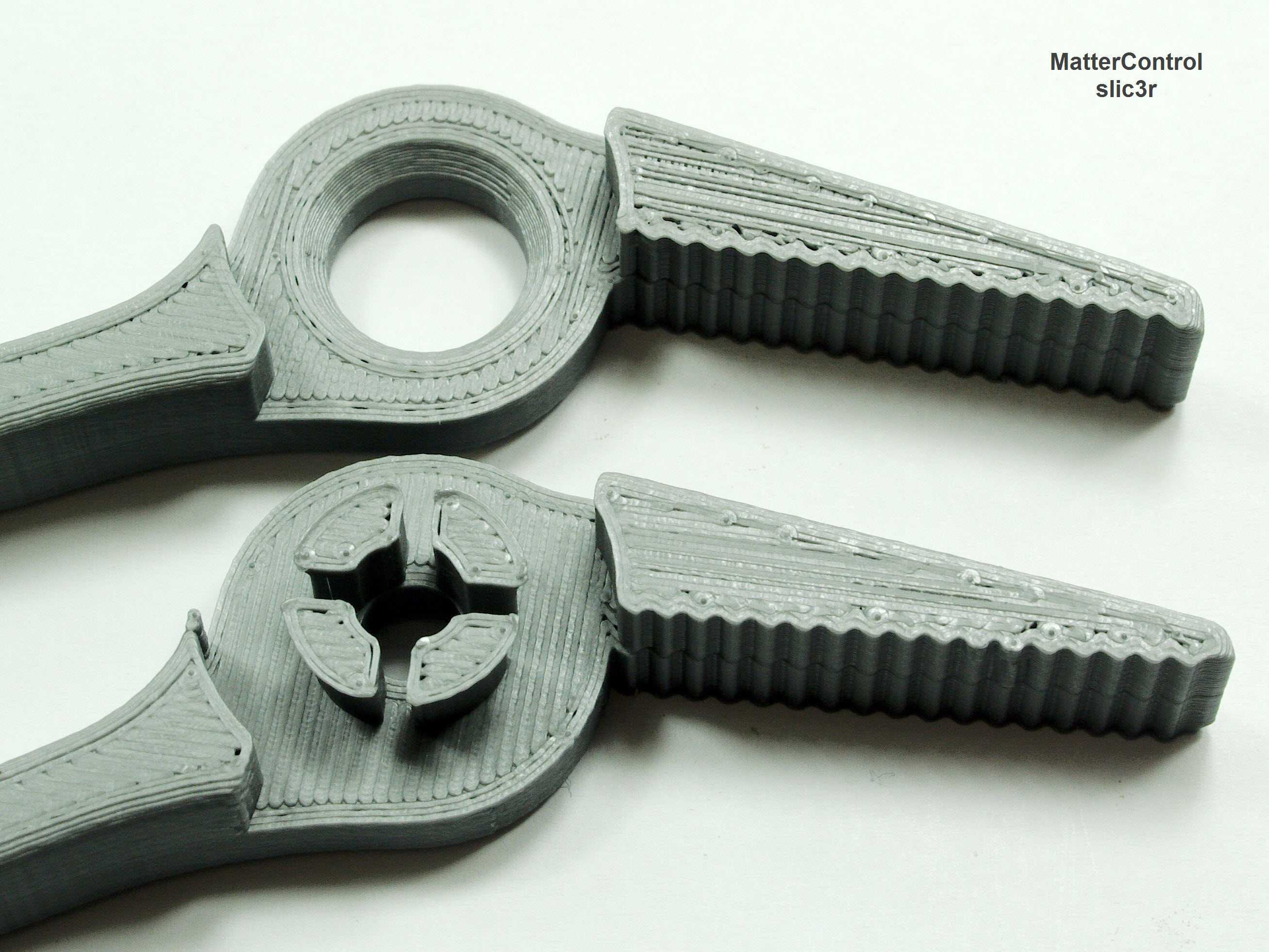

Here's what I found today. I printed a pair of pliers from Thingiverse (http://www.thingiverse.com/thing:11816). I printed these on my FlashForge last night and brought them into work this morning for a comparison. Anyway, I printed 3 pairs of pliers on the Rostock using S3D, MatterControl/cura and MatterControl/slic3r. Overall, I got a better result with slic3r but really crappy top surfaces. Always something, right. On the other hand, cura is really really close. Cura handles those top layers wonderfully but extrudes much thicker lines. I don't see where I can control that. Even though I wanted S3D to win, I think it came out in last place on all of my comparisons. My FlashForge print blew the doors off of all three of my Rostock prints. I definitely have my work cut out for me. For now I think I'll use MatterControl/slic3r until I learn some new tricks. Anyway, pictures are attached for you to review. Perhaps y'all have some tips for me.

Thank you very much for this impressive examples !
But I am a little bit confused, which one is now with the rostock and which one with the other printer.
I can see which program makes it better, but not which printer.
Do I understand right that the Rostock has no chance against your F.Forge printer ?

I'm sorry for the confusion. In a nutshell, I get better prints off of my FlashForge than my Rostock at this point in time. I want to change that. I feel as if I should be getting equal results, at least that is what I expected. I've seen prints from others. I know what the machine is capable of. The Rostock is an impressive piece of equipment and I get a little frustrated with myself when I can't figure things out. I'm still wondering about which slicer to use. I no more than settle on one and then I change my mind. It seems like everything that I have tried so far has at least one hiccup. I don't want to have to print 3 of every model using 3 different slicers just so I can see which will give me the best results.
These pliers take about an hour and a half to print at 40mm/s. I wish one of the Jedi Masters on this forum would print one and share the results (using there slicer of choice). Perhaps they could share their settings with me. Perhaps the gurus at the MakerHive could help too.
