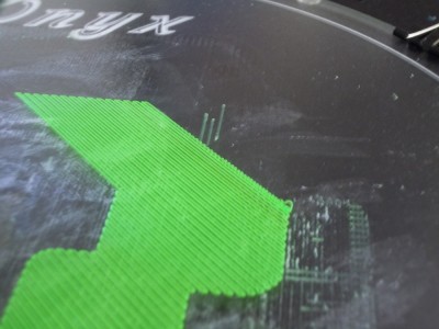

Hi, recently I've been seeing this error where the initial printed paths are squiggles instead of straight lines. This happens regardless of the slicer used, and only at the beginning of the initial layer. I then never see this problem in any of the ensuing layers. Has anyone else seen anything similar?

You and Eaglesoarz are right. The picture shows the beginning of the raft, but even w/o raft, I still occasionally see that initial squiggle right as the print starts. It doesn't affect most prints, especially if I use rafts, but if it's a hardware issue as opposed to software, then I'd rather fix it if possible.

- part is one that I made via Solidworks, but like I said, the g-code path previews don't show these wiggles, and I wouldn't expect them to, as they're part of the raft layers
- problem doesn't seem correlated to the object size. You see these squiggles always in the initial few passes. However, as you might be able to see in the attached picture, they seem isolated to an area in the print frame, so it's not like the squiggles/wiggling is isolated to the first few seconds of the print
- this error has been more prevalent since I started printing from SD card as opposed to over USB, though I'd think that using the SD card would lead to a more stable print
- the steady oscillation in those squiggles makes me think it might be an issue with the stepper motors or RAMPS board, and that would be my main concern. Maybe the initial acceleration/jerk during the start of the job is causing this?

Figured out the cause of the squiggling, sort of. The squiggling in the pathing is produced when the hotend tip is too high above the build plate. For some reason, my printer starts off high and then somehow settles later.
So, at this point, it looks like an issue with my leveling and possibly my steppers/belt, as opposed to the slicer, arms, or joints.
Thanks to everyone who gave suggestions and insight!
EDIT: Added a photo of the squiggling error that I'm seeing, in case it helps others in the future. As you can see, the skirt shows the squiggling and is clearly raised above the build plate, whereas the inner path that outlines the part itself appears to be printing at the appropriate height.
