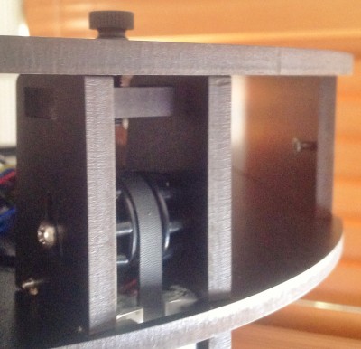

Any suggestions on belt tension? The docs have you pull it tight when putting the belts on, but with the idlers on the towers there appears to be room for further adjustment.

Make some simple little aluminum L brackets to adjust tension until you can print some replacements to look better.

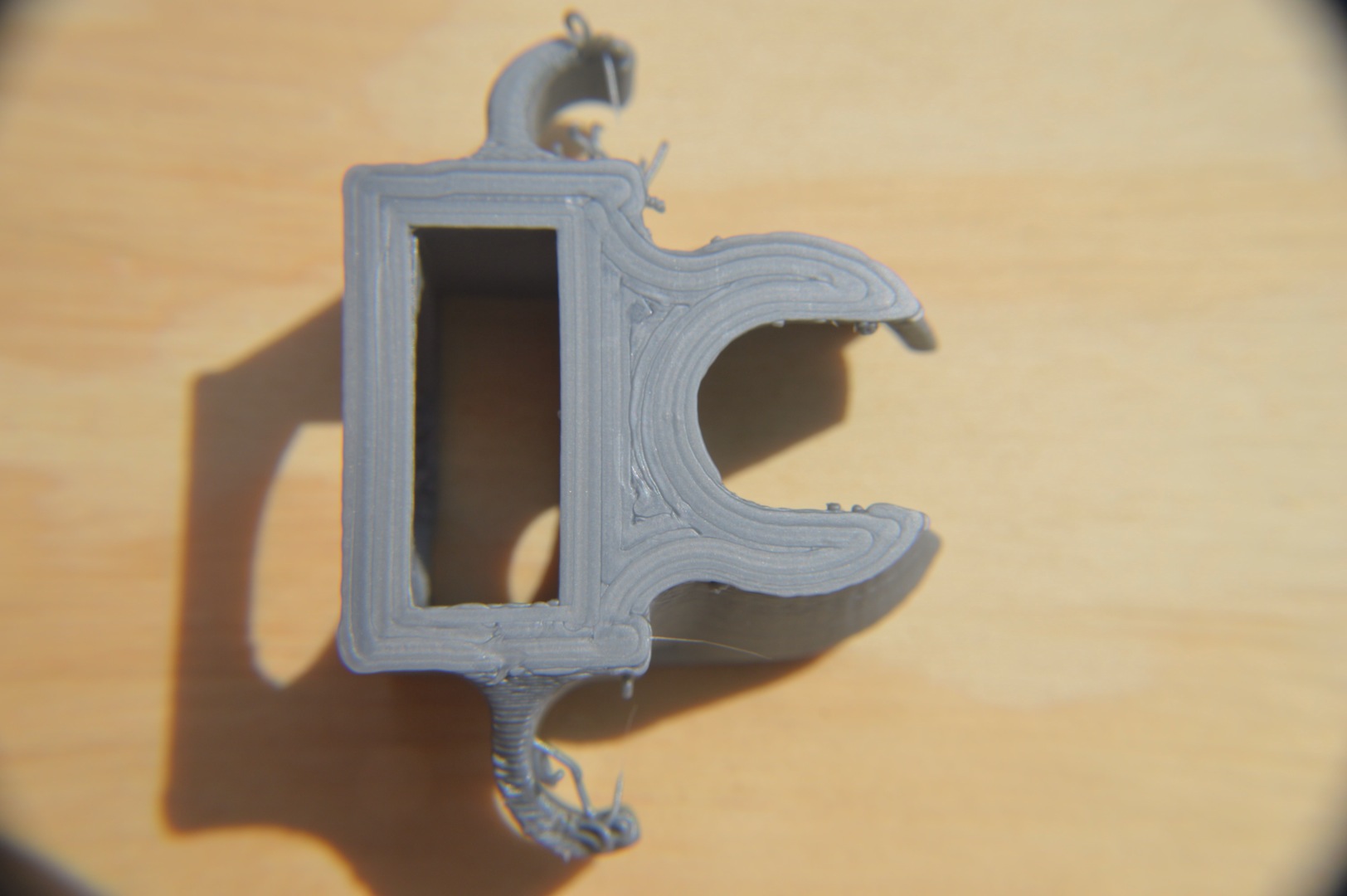

Has anyone thought to make a c-clamp like tensioner that you could slip under the idlers and on the top of the printer to pull the idlers up and tighten the screws? How much play, if any do you want in the belts?
This is what I'm talking about and make some temp ones.
http://www.thingiverse.com/thing:87463
Joe

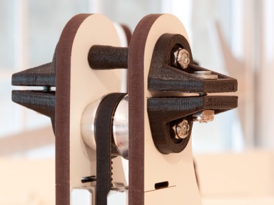

That might work, but on the V2 there is a cross member that the top screws down onto...
This is a shot of the top idlers and the top plate as it sits when screwed onto the top tower mounts.

Make it so it pushed up from the bottom. Glue a aluminum plate on the bottom structure for the screw to push on and not dig into the wood. so you would only use two of the L brackets one on each side.

joecnc2006 wrote:Make it so it pushed up from the bottom. Glue a aluminum plate on the bottom structure for the screw to push on and not dig into the wood. so you would only use two of the L brackets one on each side.
Thanks Joe, will give it a shot!

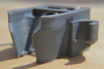

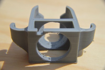

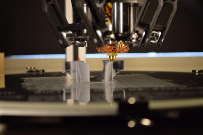

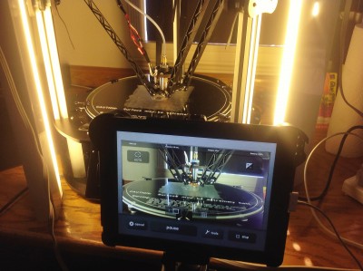

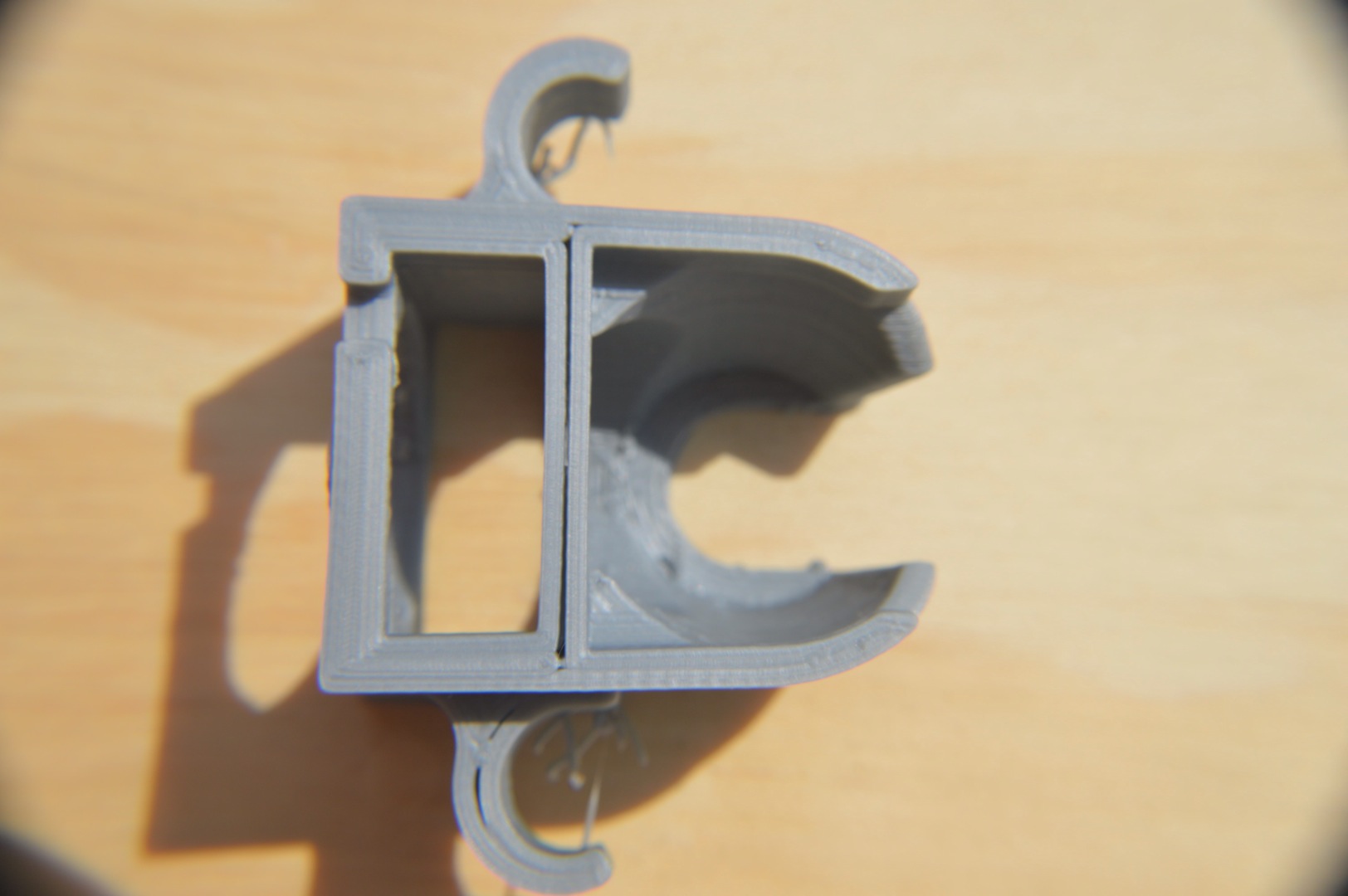

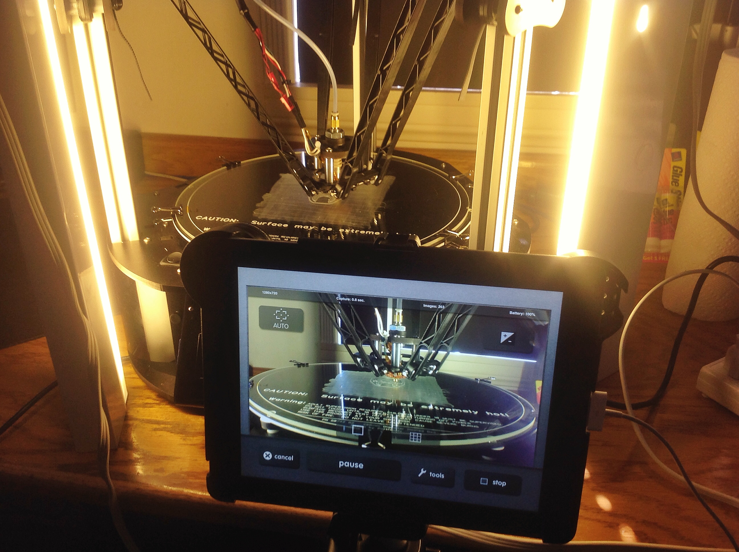

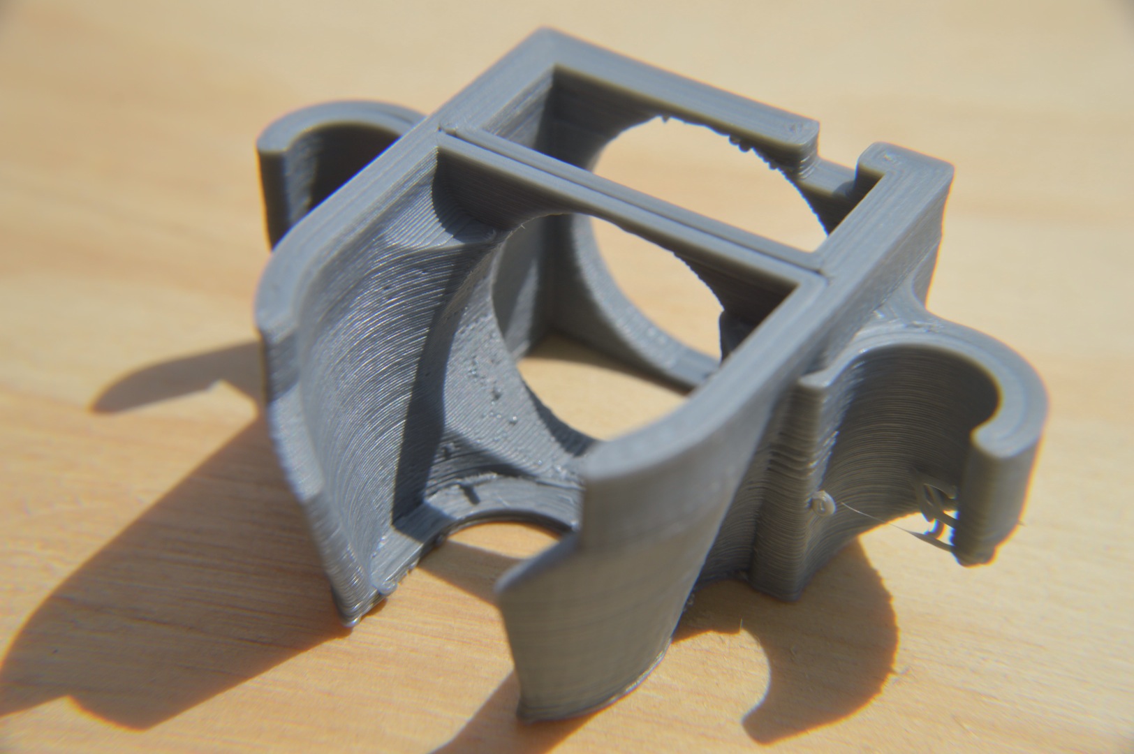

New thermistor received, installed and calibrated! Here are some shots of my 1st print of the PEEK fan shroud using the setup in the documentation with ABS. Timelapse video to follow! (Its still uploading to Youtube) The final print images are as is, no clean up has been done post printing, only photos taken to show it off!
My ipad timelapse setup for the PEEK fan shroud print
The Rostock in action!

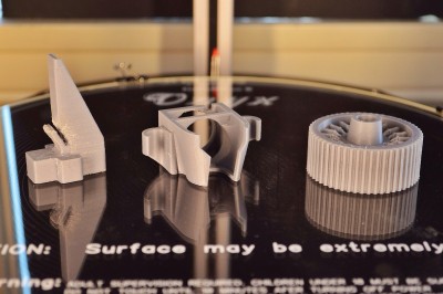

The end of my first day printing saw 2 prints of the PEEK fan, 1 print of the Layer fan and a replacement gear I modeled in 3D Studio Max for my weedeater. Still have some fine tuning to do, but the ABS I bought from Inventables.com has been doing great right out of the box. I upped the temp for the 2nd PEEK fan to 230 C from 225 C and saw a much better result. Bed was left at 90 C using a glue stick for adhesion with no problems. The first PEEK fan is on my hotend, but it needed some filing to get the fan in... Figure that with some hotend calibration that won't be an issue again. Re-ran the PID autotune after installing the PEEK fan and can also see a more stable performance in temperature levels.
So what to print today? :D
Three of the four items I printed on my first day running. The other PEEK fan was installed to print these three.

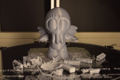

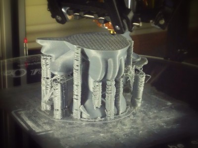

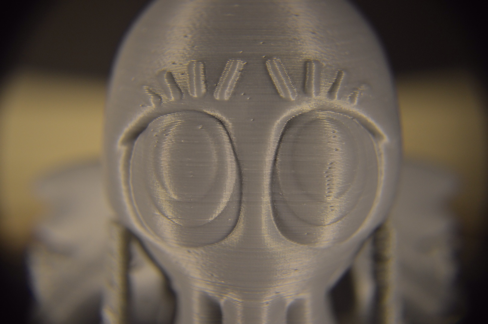

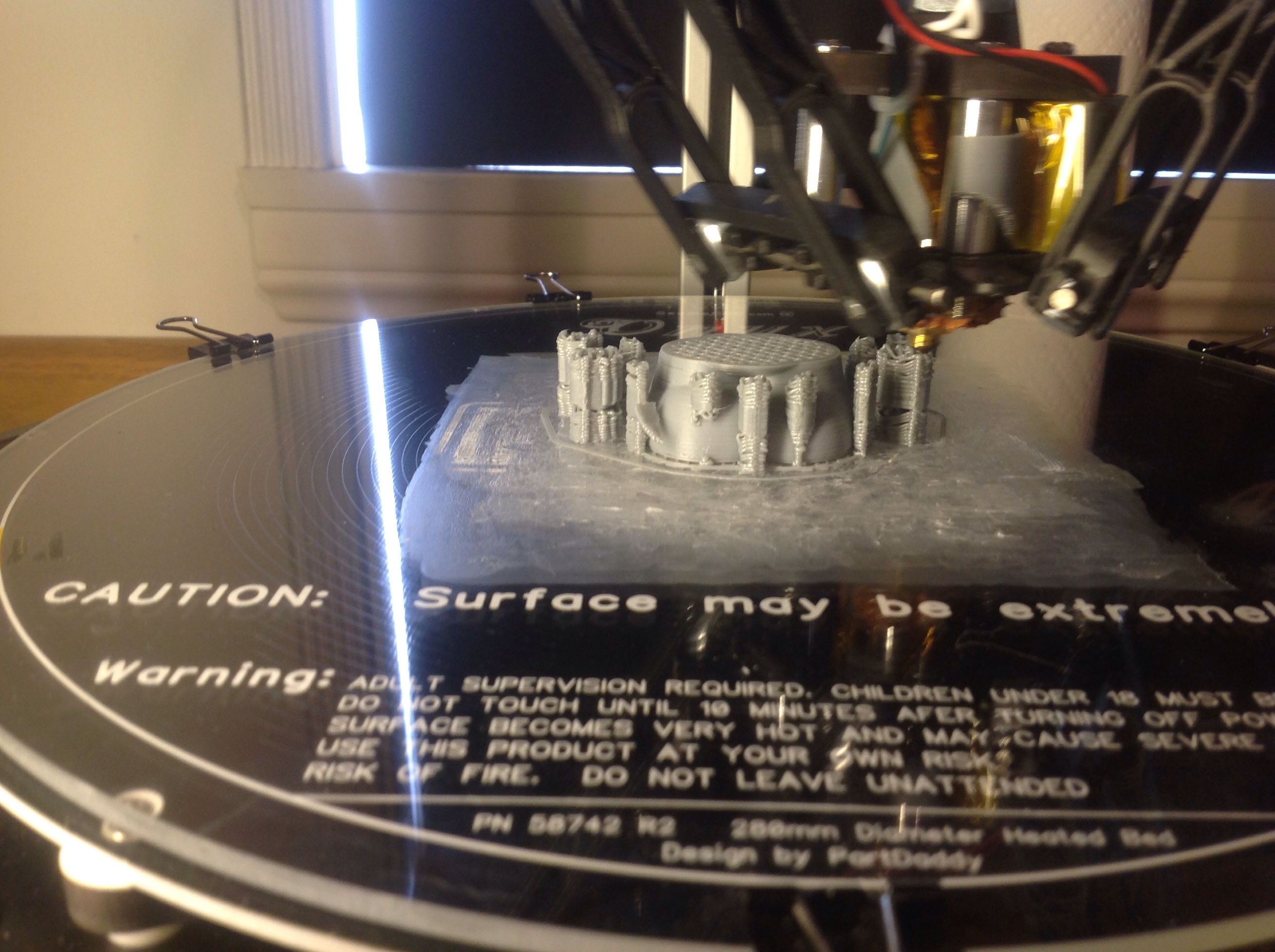

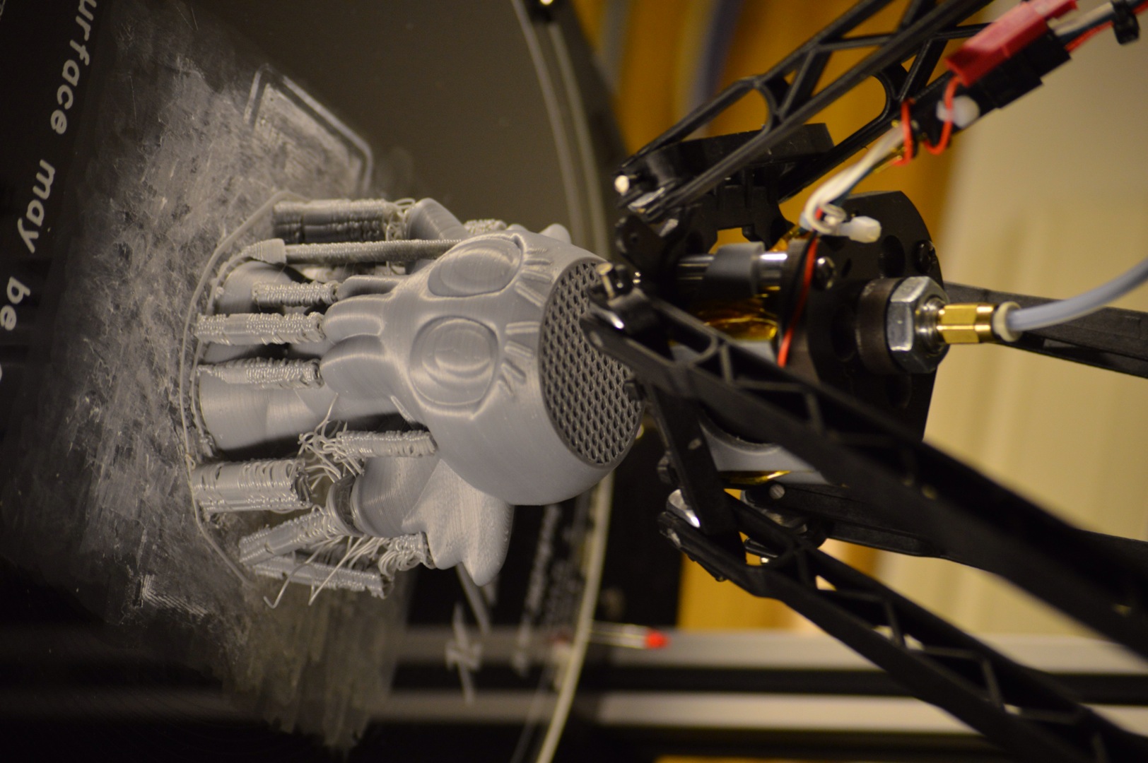

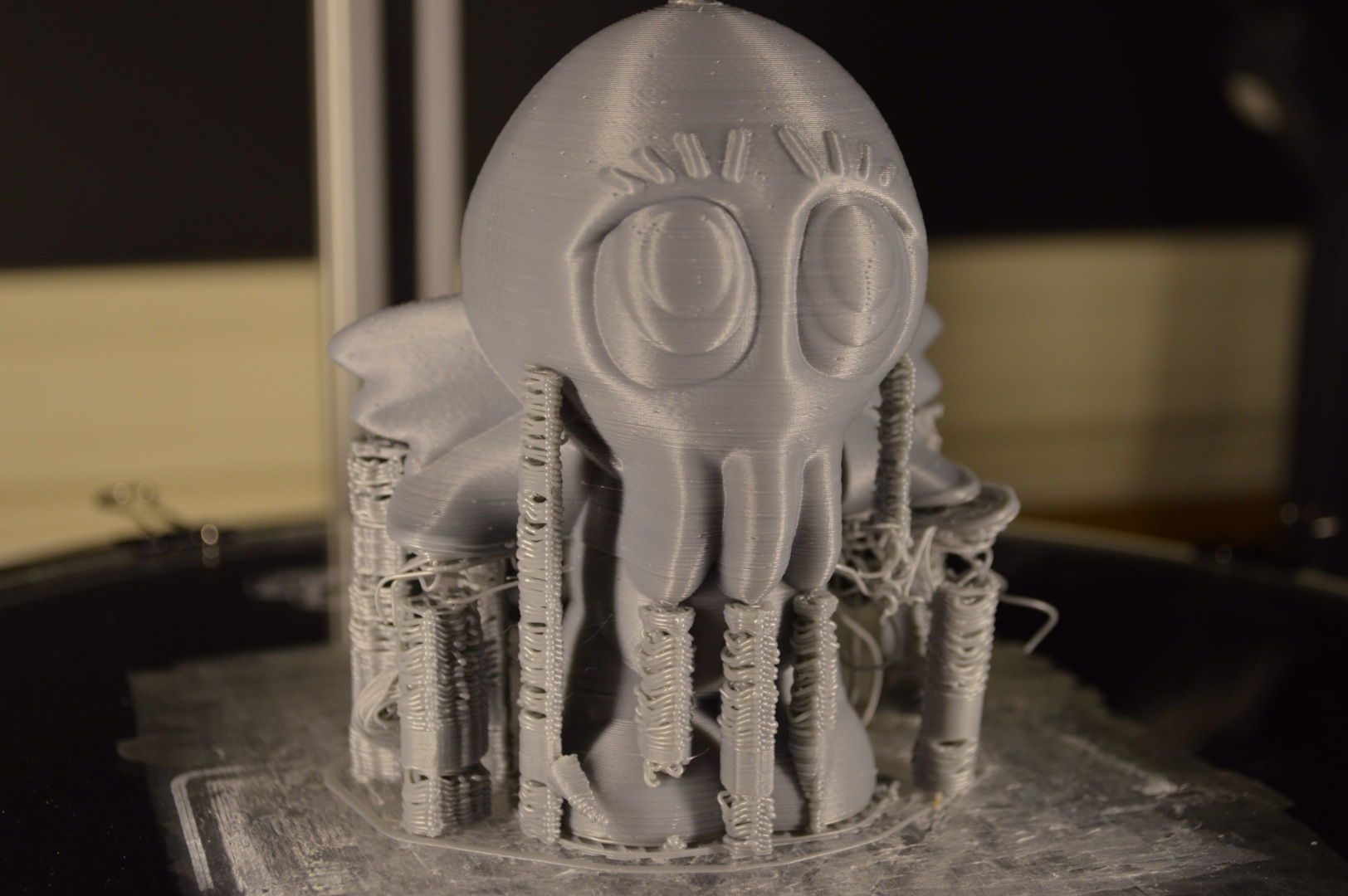

Printing a little toy figure in ABS for a friend at about 4" tall with supports for the first time. Honeycombed the infill and added supports with rafting to keep them stuck to the base.
Up really close... had a few air bubbles in the ABS, but not bad for a 1st try
Great shot of the build showing the honeycomb infill
Completed with remaining supports
A few supports collapsed during the build, but it still looks great!

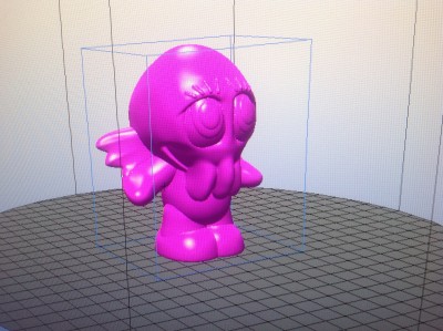

This is he file I am currently printing in ABS at around 4 inches high
Print with less than 5 hours to go! Lost some supports and the left arm recovered.
7 hours to go at 100% speed...

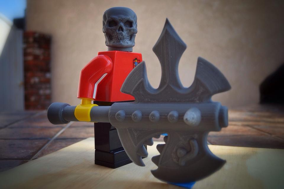

Finished up with these accessories for a buddy of mine... ABS at 230C with honeycomb infill and cut in halves then will be glued together.
Skull and Axe printed for large format Lego figure. He custom makes these for little minifigs with injection molding, these were printed for displays at the various Lego conventions he goes to.

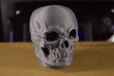

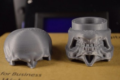

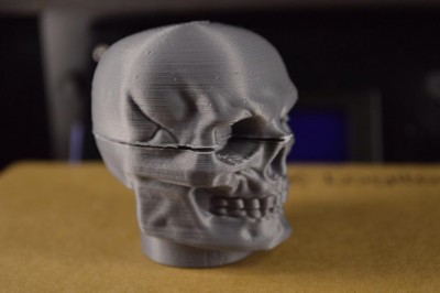

Been playing with settings on my V2 and various ways of slicing the models up for printing. Using 3dstudio max I cut this skull just above the nasal cavity and was able to print it with no supports by inverting the bottom half.
Sliced the model in 3d studio and inverted the bottom half to print
skull cap set on top of bottom print
just need to glue them together now
