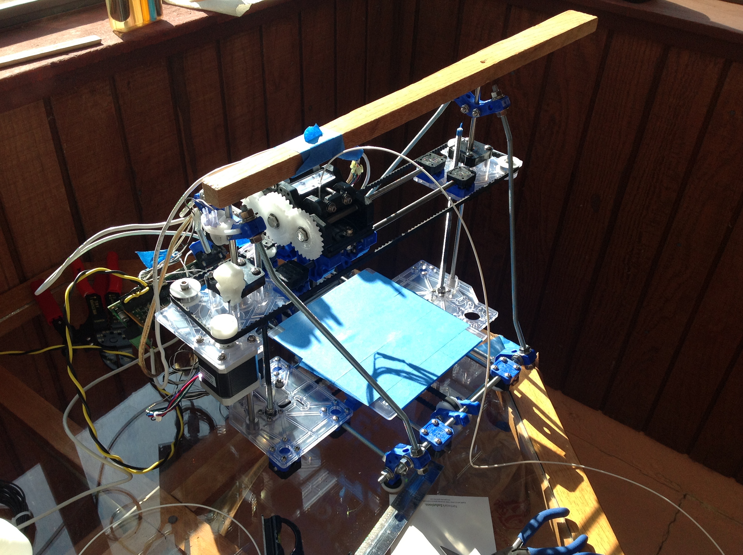

Here are some pictures. sorry about the lighting and the background clutter. All images are uncropped as they came out of my iPad, so click to zoom in on any details.
Overall view. Note the elegant crossbar at the top, lovingly hand-crafted by drilling a couple of 1/4" holes into a stick I had lying around. Measure the distance between the two smooth shafts at the bottom of the machine and make the holes the same distance apart at the the top. This is necessary because the X-axis drive belt pulls together the two Z-platforms, and the clamps that hold the Z smooth rods don't clamp.
Keep the crossbar in place as you loosen, adjust and retighten the nuts on the four threaded diagonals so that the system is stress-free when at rest.

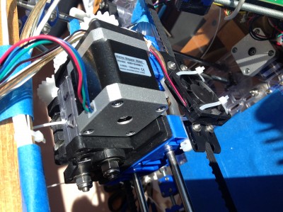

The two sides of the extruder carriage are pulled apart by the tension of the drive belt in this configuration. A large zip tie around the back keeps it together. If you already have a 3-D printer you can probably print up a nice clamping fixture which also holds the fan and belt clamps. Most 3D printers are put together by people who don't yet have a 3D printer.
Then drill holes for the belt clamps. Install one end with the belt clamped into it, then thread the timing belt around the pulleys so you know where to clamp the other end. (The crossbar must be in place or you will get the length wrong.) Hold the second clamp at the right place on the belt, slip the belt off one pulley so that you can install the second belt clamp without having to fight the tension as you do so. Then slip the belt back onto the pulley. Verify that everything is still straight and true, with the distance between the Z shafts the same at the top as the bottom.

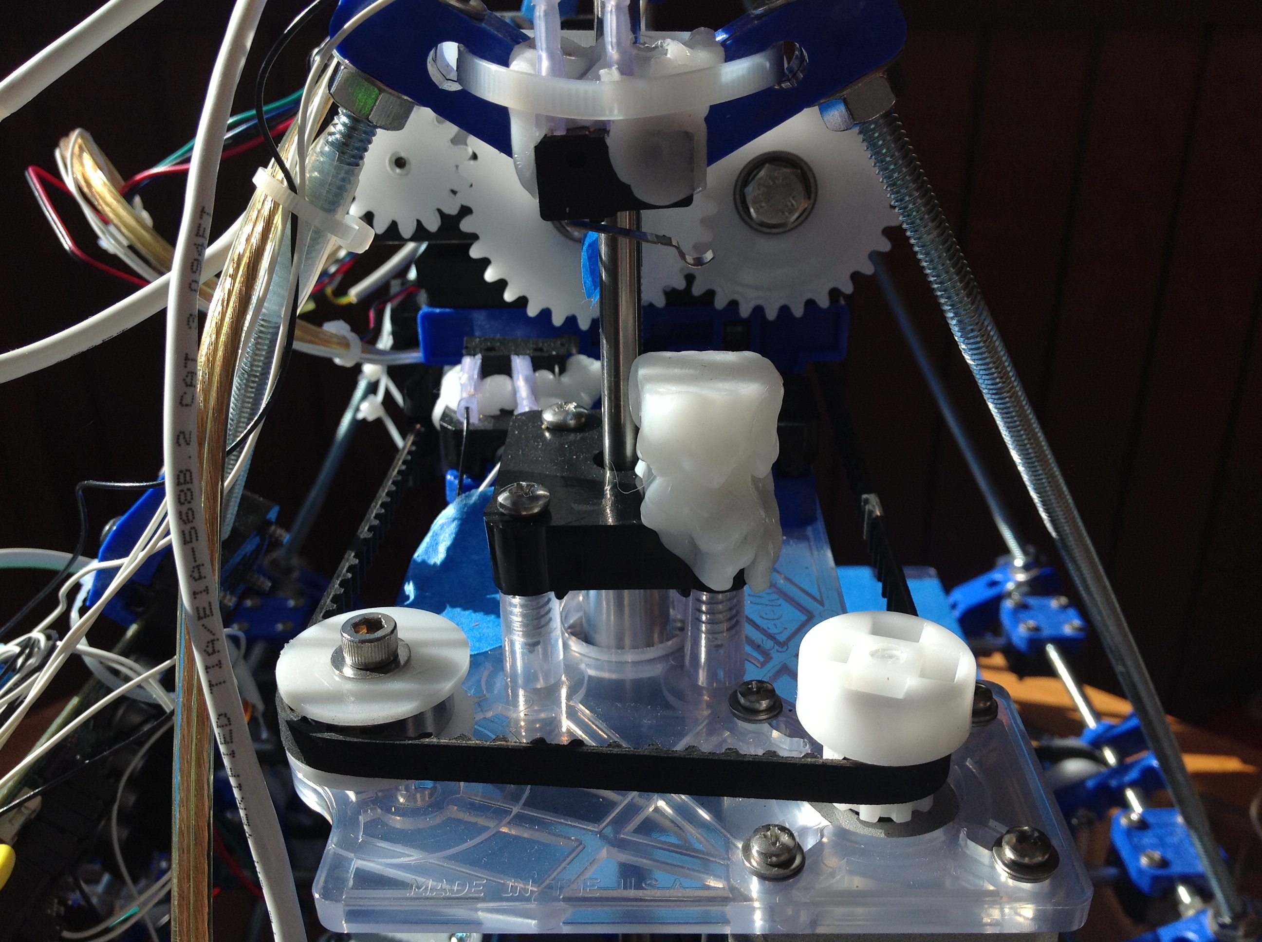

The fan is recommended to blow on the insulating tube of the hot-end to prevent jamming. (Mine still jams.) I should probably make a duct-work fan mount to blow the air where it is needed and that also clamps the carriage sides together, but I haven't yet.
The X-shafts go on top of the Z carriage, in the higher position of the clamp, so that the belt aligns with the blue pieces of the extruder carriage and you have a place to drill the mounting holes for the belt clamps.

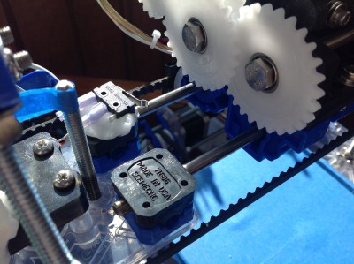

The X-endstop is held on by shapelock. Seems to work.
The Z-endstop is at Maximum-Z so that when I change the bed height with e.g. a heated bed, I don't have to physically move it. This does require changes to the firmware (Repetier Firmware for RAMBO from johnoly99 -- Get the latest version from github because an earlier version had the wrong pin numbers for the Max-endstops.) The shapelock holds the switch in a stable place, the zip tie gives it strength. The white tower is made of shapelock and its height is set to prevent the extruder carriage from hitting the crossbar (giving 137 mm of vertical build height.) The top of the tower is flat and level to improve position repeatability. Put a coin or other flat level object on top as the shapelock cools to get a flat surface.

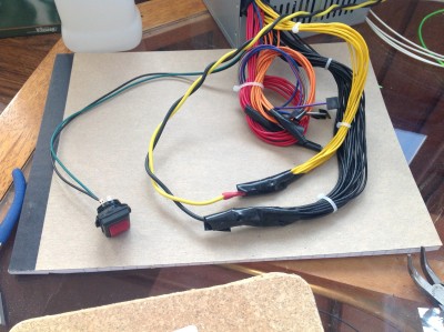

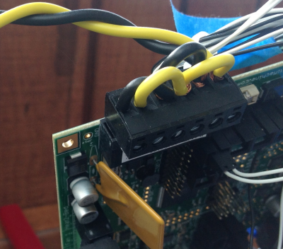

I was wondering if you could fill me in just a bit on how you wired your RAMBo? I realize I should know better, but I simply have no idea how to read the fancy-pants electronics diagrams that I have run across describing how to wire the RAMBo. Specifically, the power supply that comes with the H1 is great (I assume), but for a noob like me it looks like a total mess of wires. Can you show some more shots of which wires you ran where from your power supply into the RAMBo?

For the ATX power supply you need 1) the Black wires (ground) 2) The yellow wires (+12 V) 3) The green wire (PWR_ON)Danger_J wrote:I was wondering if you could fill me in just a bit on how you wired your RAMBo? I realize I should know better, but I simply have no idea how to read the fancy-pants electronics diagrams that I have run across describing how to wire the RAMBo. Specifically, the power supply that comes with the H1 is great (I assume), but for a noob like me it looks like a total mess of wires. Can you show some more shots of which wires you ran where from your power supply into the RAMBo?
-Jon
Put a manual switch between the green wire and one of the black wires. This is the main on-off switch for motor etc. power, and it's what you frantically hit when the Z axis starts driving the hot end through the print bed.
Bundle the remaining black wires together and connect them to a thick black wire (like 18 gauge, available at hardware and automotive stores). Likewise bundle the yellow wires and connect them to a thick yellow wire. These are the main power for the system. The remaining wires should be bundled neatly way or cut off, but they should be carefully insulated so that no two wires of different colors will short.
The thick black wire and thick yellow wire go to the main power connector on the RAMBO. There are three +12/ground pairs in that connector, so you will have to daisy chain them. Make sure you don't short them.
