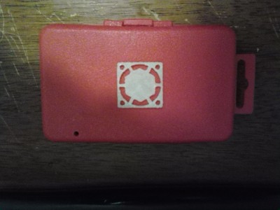

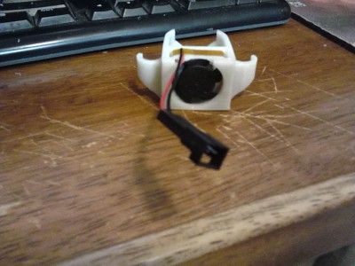

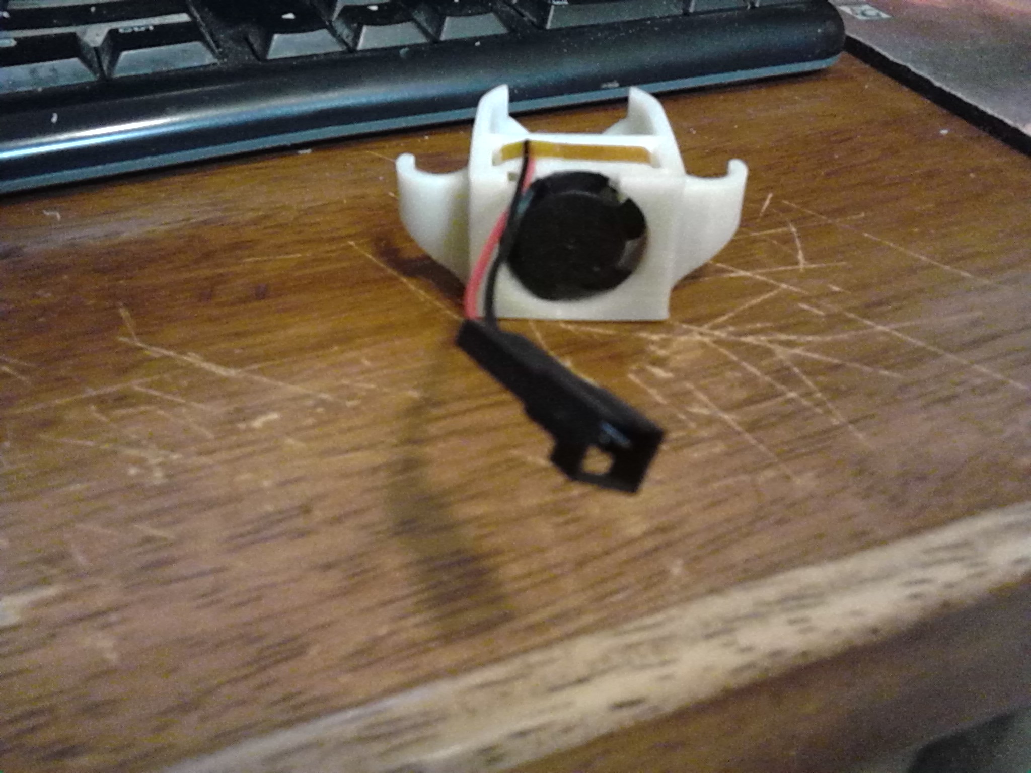

I am currently trying to repair the 25x25x10 mm fan for the Rostock Max. I broke mine trying to get it to fit into the peek fan holder. Turns out the 25mm fan is slightly bigger than 25mm. More like 25.3 or more. I measured this with a caliper.
So I am designing a new "shell" for the fan. Here is a partial test print:
test run of grill
test run of grill
Edit:

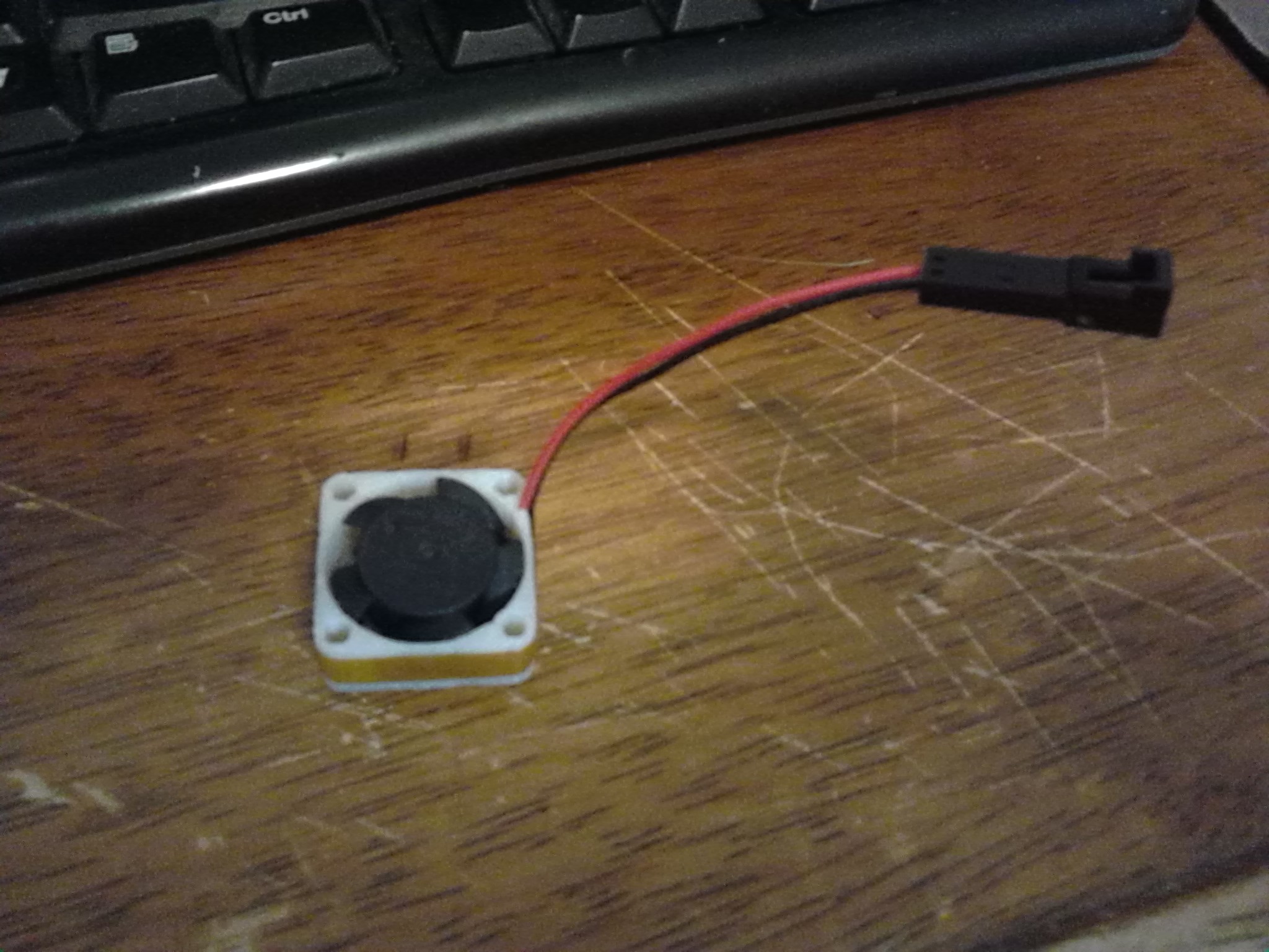

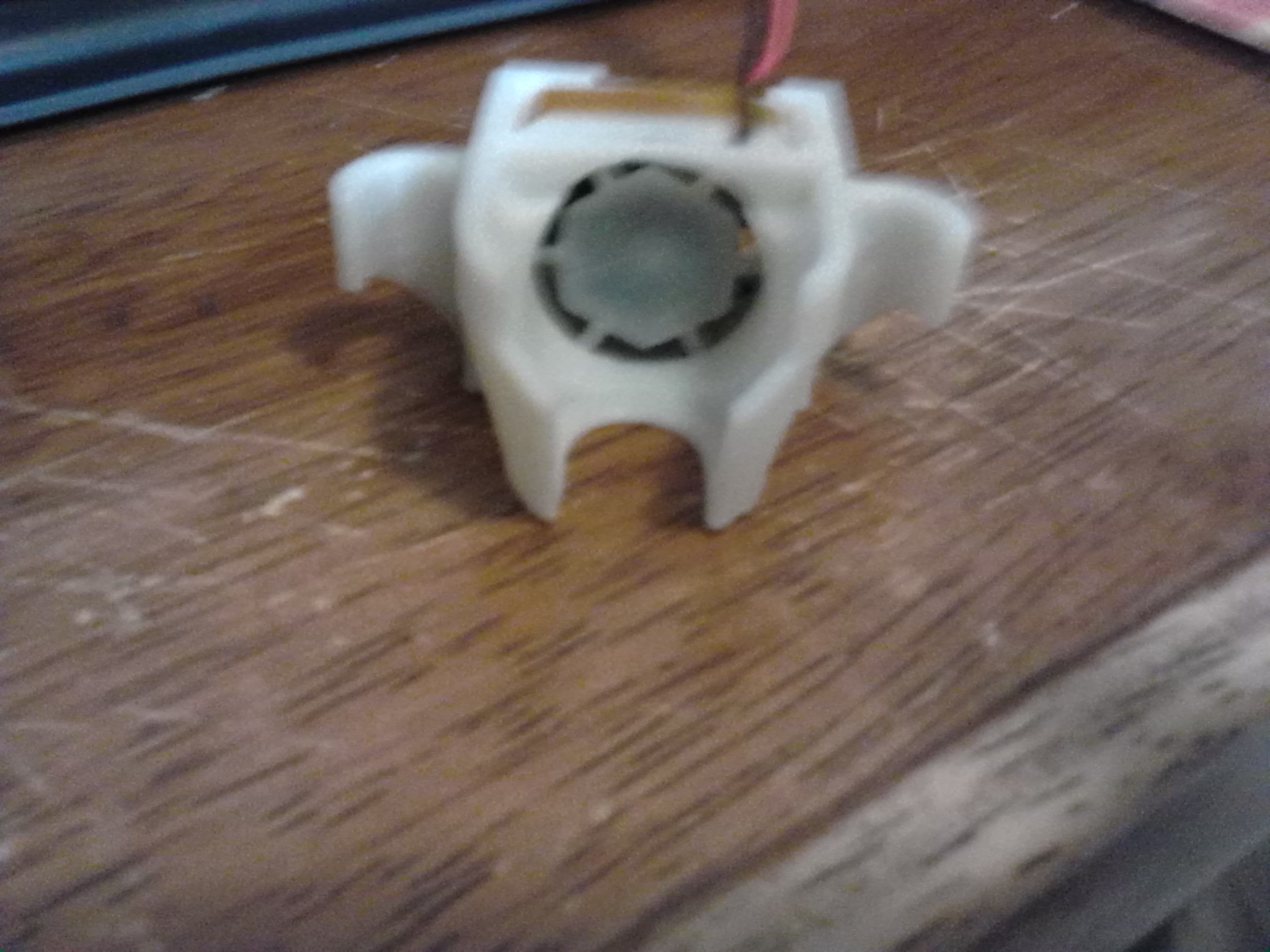

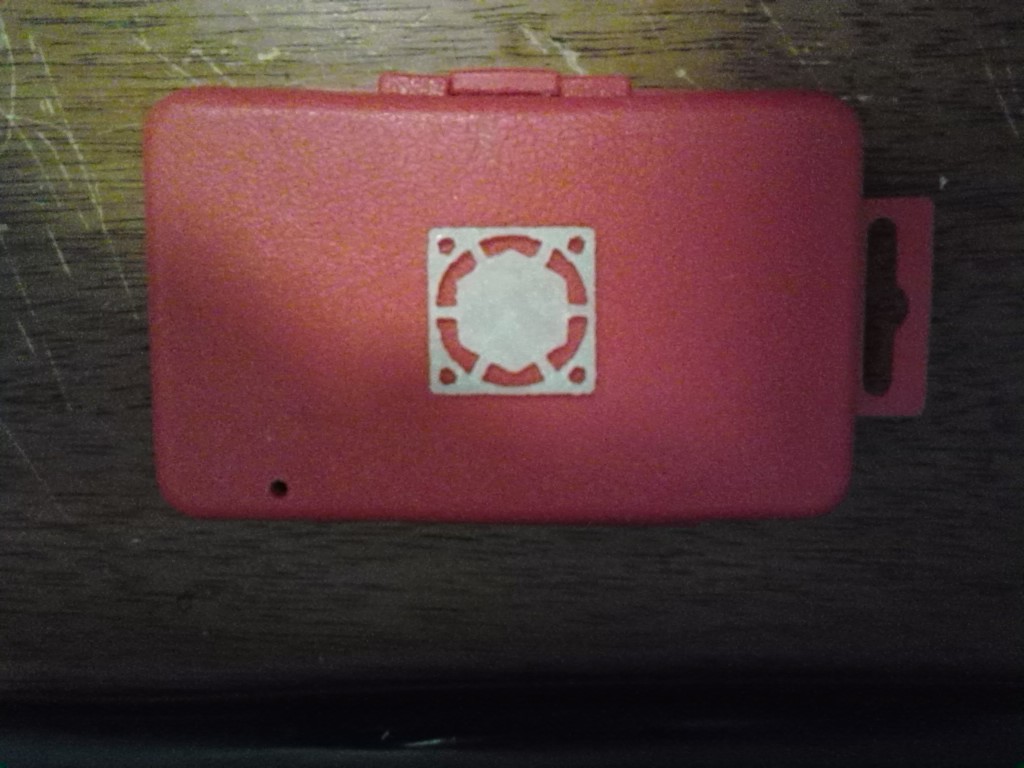

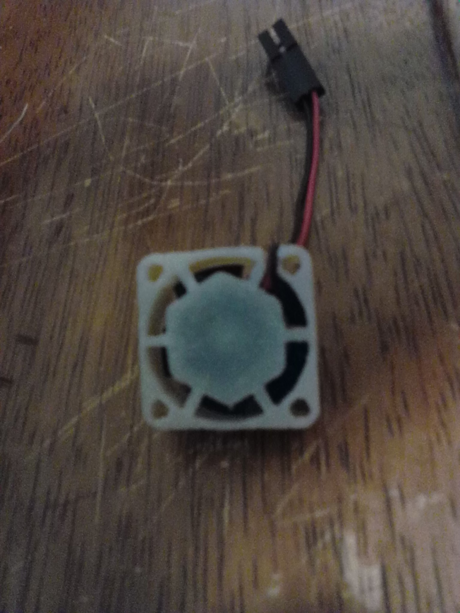

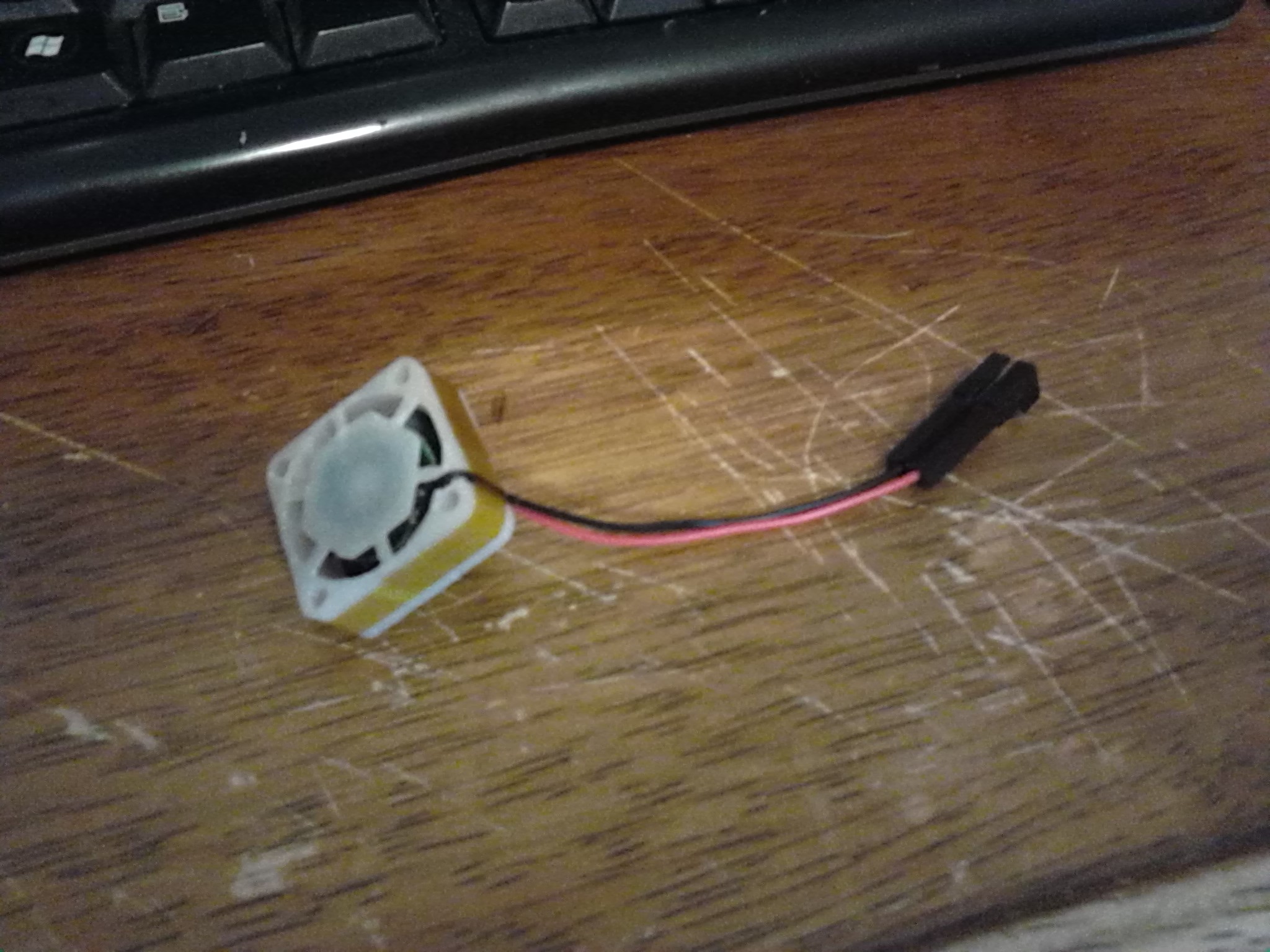

Probably an expensive fan now, but it is now printed, filed, tweaked, the mount modified to allow full radius of fan to flow through, and tested:
grill side
grill side
hub side
hub side
grill side showing detail of hex style
installed in bracket showing grill side
modified mount a bit to allow more air flow, and to prevent blades from hitting mount
This was kind of fun to do. It also is neat that I can repair an item this small. I ended up leaving the motor attached to its original plate and super glued it to the new housing right onto the hex hub. I had to resolder the wire connections as they broke because of all the handling. Then I cut a thin strip of Kapton tape to support the wires and keep them from tugging on the solder joints. The tape kind of makes it look cooler anyway.
