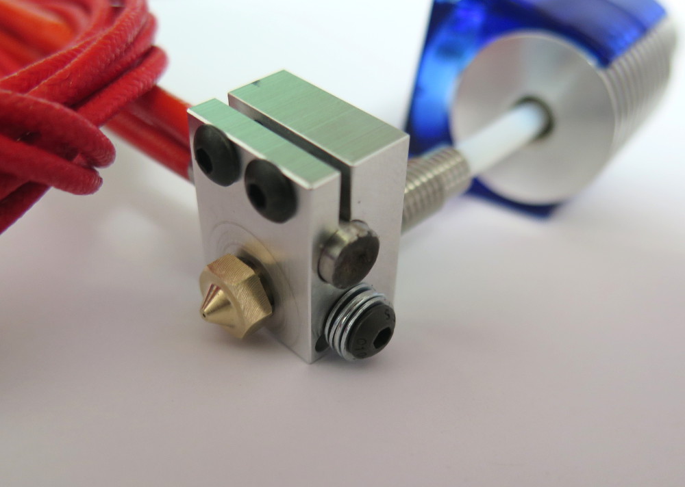

I have included as attachments some pdf files that are mechanical drawings of the V6.
Also included are a few pictures of the V6. You will probably notice the V6 is
shorter than the V5 and here are the numbers.
V6 Direct HotEnds are 7mm shorter than V5
V6 1.75 Bowdens are 20mm shorter than V5
V6 3mm Bowdens are 23mm shorter than V5
If the other Beta Testers experience what I experienced with the E3D V6, E3D has
a clear winner on their hands and is the best HotEnd I have ever used.
Posts: 7185
Re: E3D Release New Version 6 of HotEnd.
Some pictures to go along with the text.
You notice there are two small screws to tighten and hold in the ceramic heater.
The other small screw is to hold the insulated legs of the thermistor.

It should protrude thru a decent amount if you flip the duct 180 (e3d's site says it can be mounted in either orientation), I noticed it because I went and modeled it up and mounted it on the Rostock Maxx V1's platform to see if I could come up with a solution for it for when I get mine and it protruded thru plenty, then noticed you had your fan duct in the flipped orientation.

The v6 thermister mounting is much nicer now. I chose to use it rather than a screw-in thermister and it is very easy to install and secure. Nice and simple.
